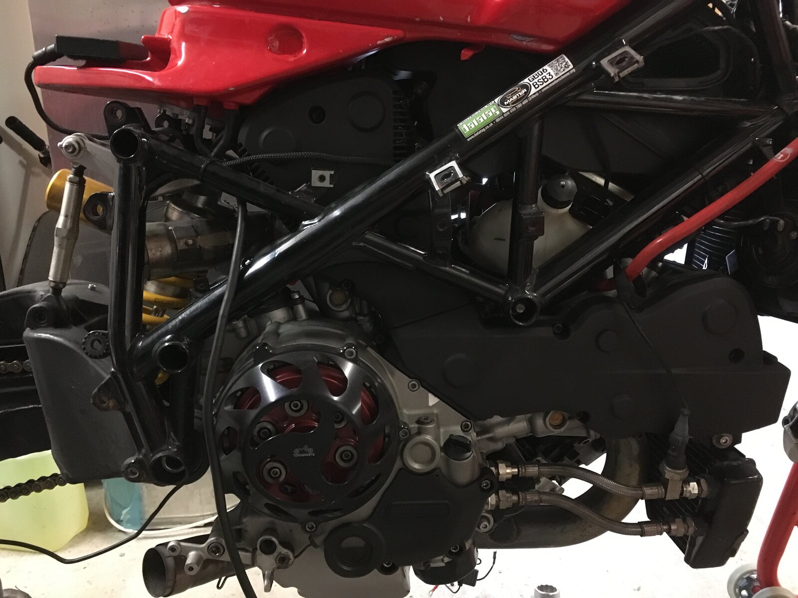

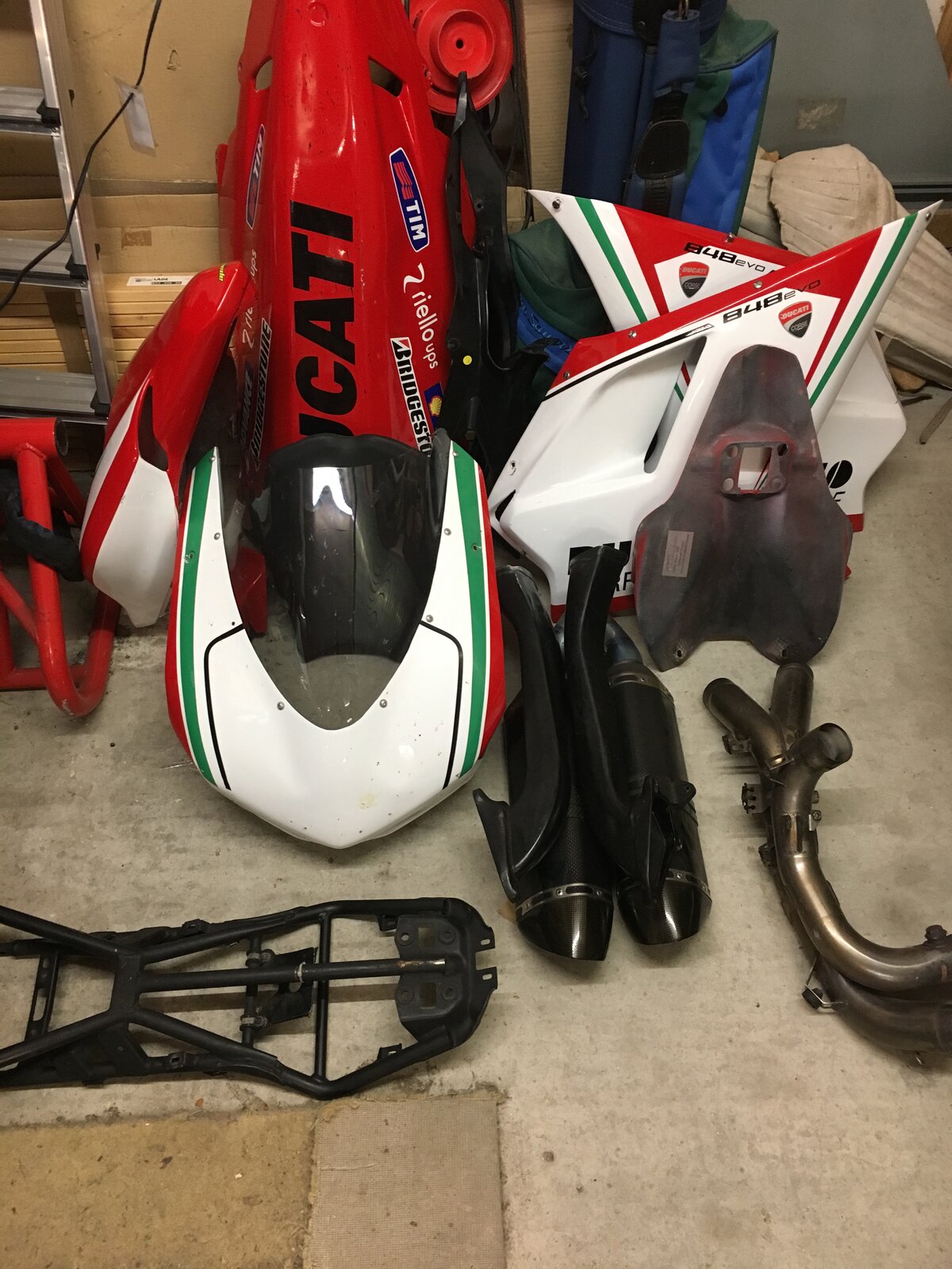

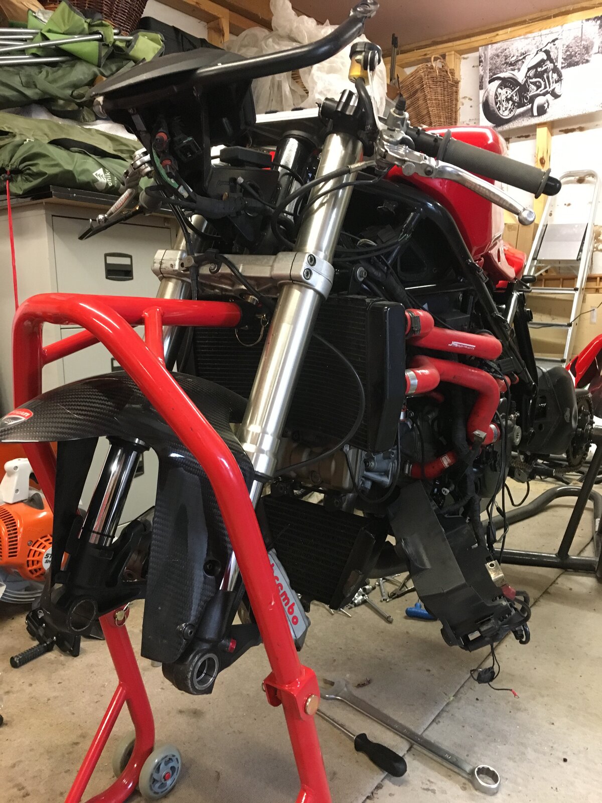

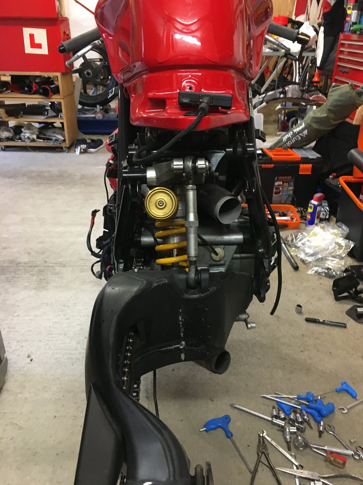

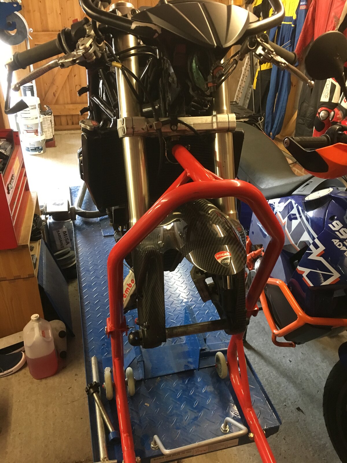

  1. I bought this 848 race bike a couple of years ago and really enjoyed its revvy engine and sharp handling.
    I want to paint the frame red and polish the swing arm. The rear shock needs a service and I dare say wheel and swing arm bearings could use a re-fresh.
    Whilst dismantling it I discover some random bolts and nuts, I guess that is privateer racing. A source of good quality replacements would help.
    Is it possible to replace the rear subframe with anything lighter?
    Is there a labelling method for the wiring loom so I put it back together correctly?
    Do I need to drain the water coolant when the engine comes out?
    Anything I missed?
    Added some pics.

  3. If you're looking for a lighter subframe then you're after an aluminium one. I managed to get my hands on one and what a difference in weight there was. Stock = approx 3kg, ally = 1 5kg. The 1098R came with one as standard but as stated above there are other alternatives like pierobon etc. Check eBay. The tell tale sign of an aluminium one is that it only has 1 cross brace towards the rear instead of 2. Here's a genuine one on eBay. The seller is splitting a 1098R. I bought a pair of DP mirrors off them. Theres a new global shipping program where all import fees are paid at time of purchase so you know what you're dealing with. https://rover.ebay.com/rover/0/0/0?mpre=https://www.ebay.com/ulk/itm/192915125014

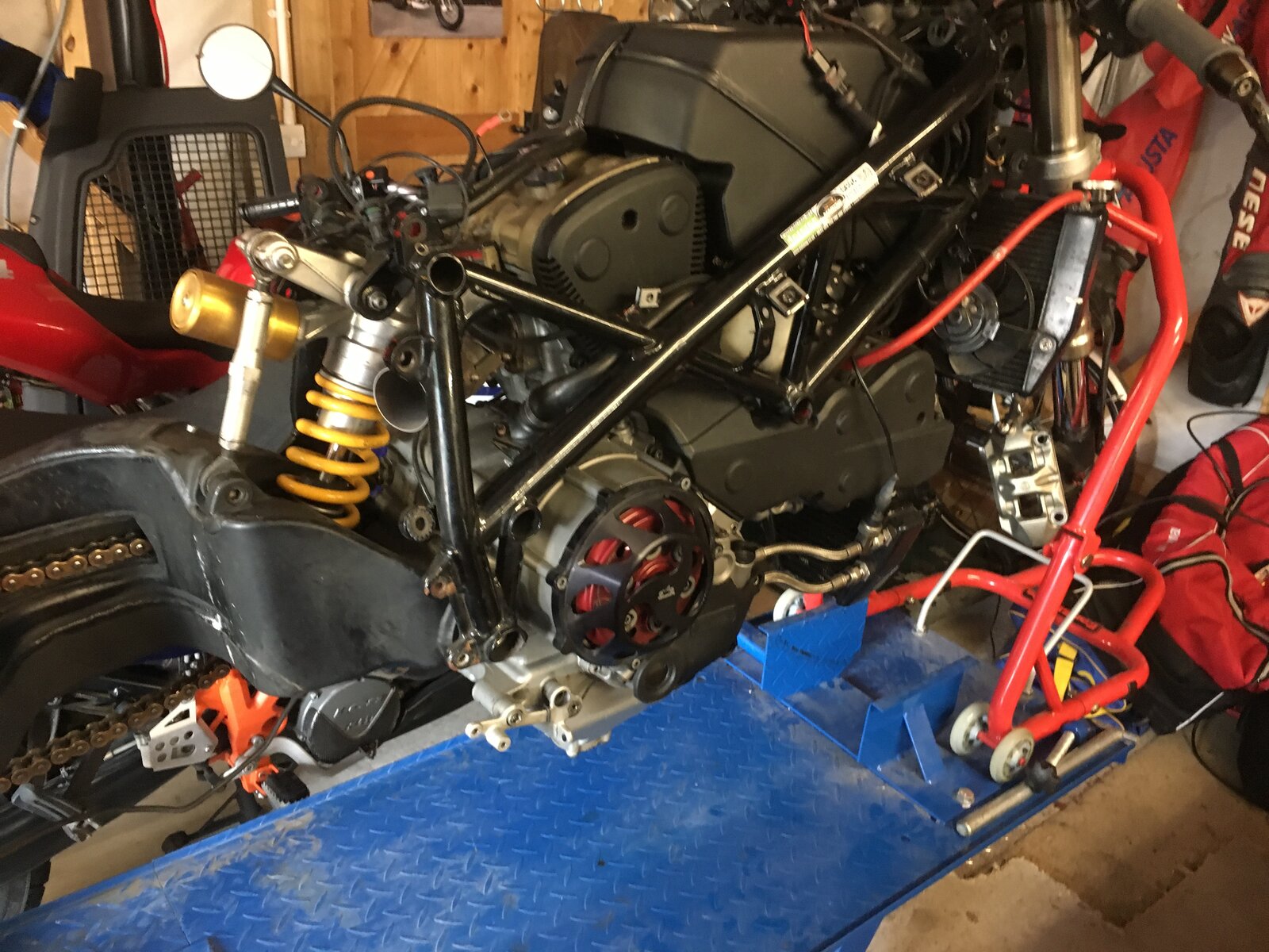

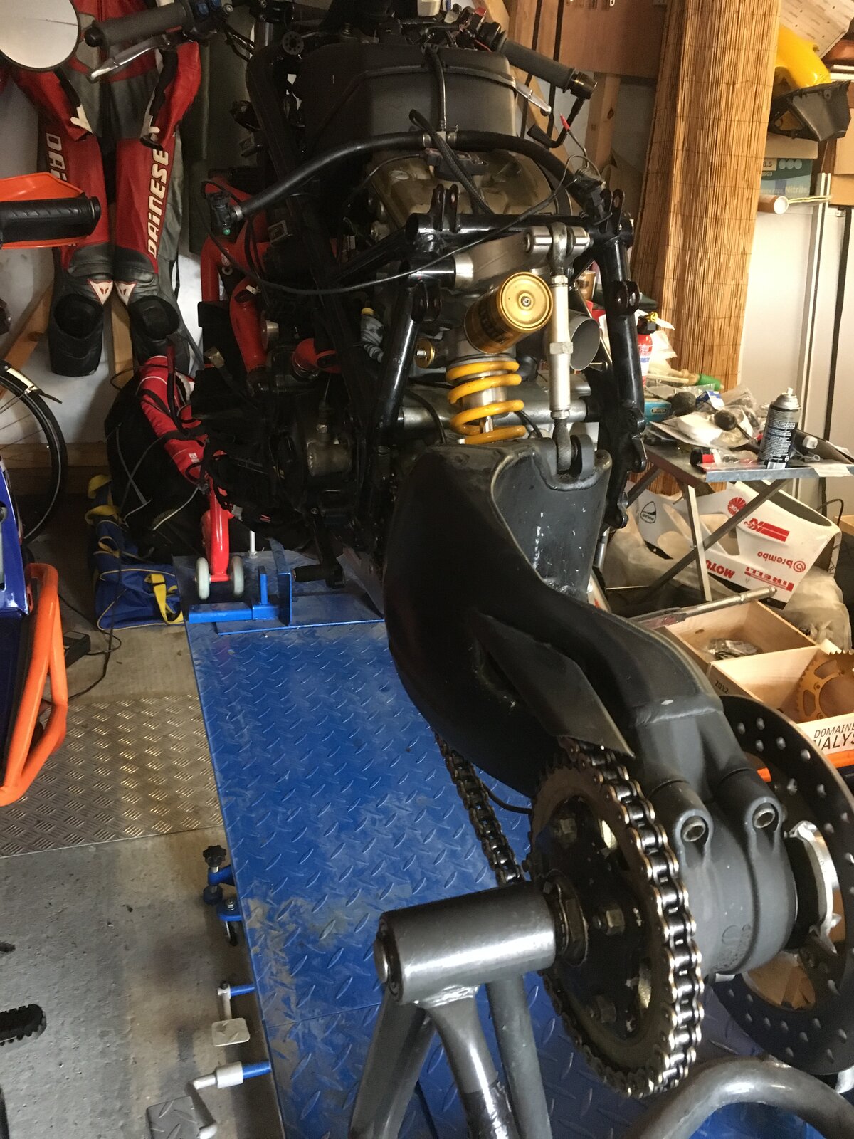

  8. Got her up on the bike lift. Exhausts will be polished using my new polishing wheel. Electrics will be labelled and detached to extract the engine.
