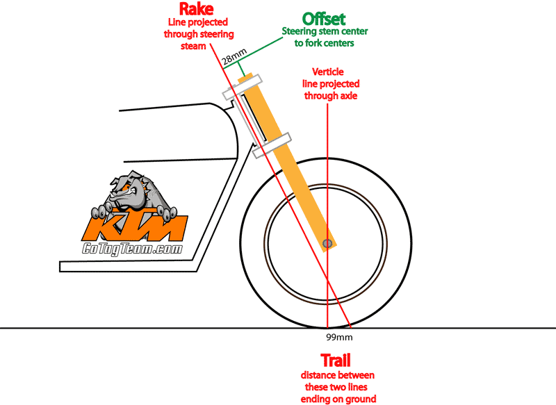

  1. hi guys can some please explain what this means?? ive found a set of 30mm offset for my track bike but a. i dont know what the difference would be over stock,would i benifit from fitting them?? b, would i have to change any thing else. cheers
  3. oh i see now thanks for that,will it make much difference to the handling on my bike??
  4. What's your stock size? I would imagine the more offset then the slower the steering would be as it increases the trail on a given set up. More stability at high speed too...

  13. this is the thing ....by making the 23.5 alteration away from the 24.5 with no other modification all you have really done is lose 6mm of trail...ie front end feel...moving the bikes numbers ( in this case 91mm ) dangerously close to the front end tucking and no front end feel... by putting 30m offset yokes on you would get the 6mm of trail back!
  14. so andyb what your saying is if i put it back to 24.5 rake and leave every thing else alone i wouldnt need to put the 30mm clamps on as i would effectivly put it back to standard lenght anyway. is that right??
  15. 24.5 rake would give you 97mm trail.....not particularly brilliant but good considering the std ducati issues....of course if at 24.5 you put 30 mm triples on you would get 103mm trail.......which is good.......
