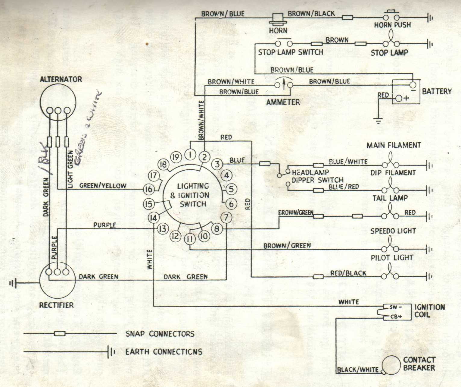

  3. 3TA_5TA.jpg Pasty, as OR has asked what is the problem and do you have the circuit diagram, if so scan it and post it. There are a few on here that assist with electrical stuff

  5. Thanks. The person who restored the bike was quite “free” in his interpretation of the wiring. I have searched for schematics online and have not found any that represent it exactly. I would be too embarrassed to put up what I’ve drawn up from tracing the wires myself. Yours is close...
    It is positive earth and it has a distributor. I’ve been through and can’t find any chaffed wires and the earths are ok.
