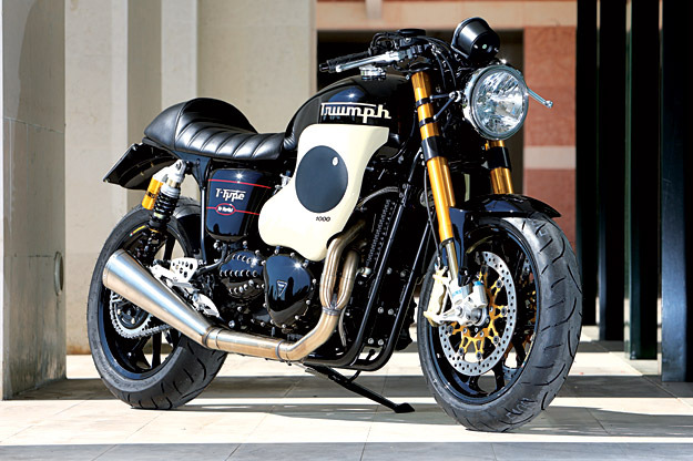

  3. If that's Beckhams bike in your pic it started life as a Bonneville T100. Start with any spoked wheel twin, add high level 2:1, thin seat and a couple of tins of matt black from the pound shop, job done.
  4. That one was built by FCR in France, it is quite similar to the bike Beckham rode though.

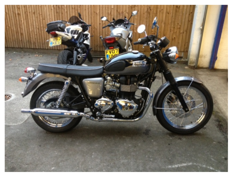

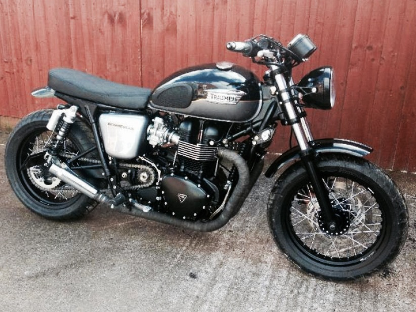

  10. I recently built an 'on trend' Bonnie custom along side 'Spirit Of a The Seventies'.
    The day I picked it up
    How it looked after I had I finished, although I did lower the front mudguard after this pic.
    The bike was a new standard T100 Bonnie. The conversion took about 6 months. Parts are cheap and these bikes are easy to work on, as you would expect from and 'old school' style bike. The bike was featured on Bonnification (take a look at there web page, loads of cool Scramblers,Thruxtons,Bonnie's to get some ideas). I basically picked the bike up, stripped it to its frame and re-built the whole thing using upgraded and better quality parts, like gas rear shocks, progressive fork springs, custom made 17in wheels, once off carbon pieces etc etc. Pretty much the only thing standard was the tank lol
    My bike was the prototype for the latest SOTS 'Barbour Bike' project.
    I pretty much know these series of bikes inside out. If there is anything you would like to know, I'll be more than happy to help.

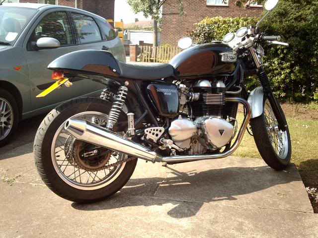

  11. I had a carb`d Thruxton.
    If I remember correctly there were some problems with the rear hub design which resulted in spokes snapping, never happened to me though. The lacquer on the engine cases was prone to crazing as well.
    I fitted Hagon shocks and fork springs, Triumphs TOR pipes, removed the air injection and made a tail tidy to do away with the clunky looking rear mud guard.
