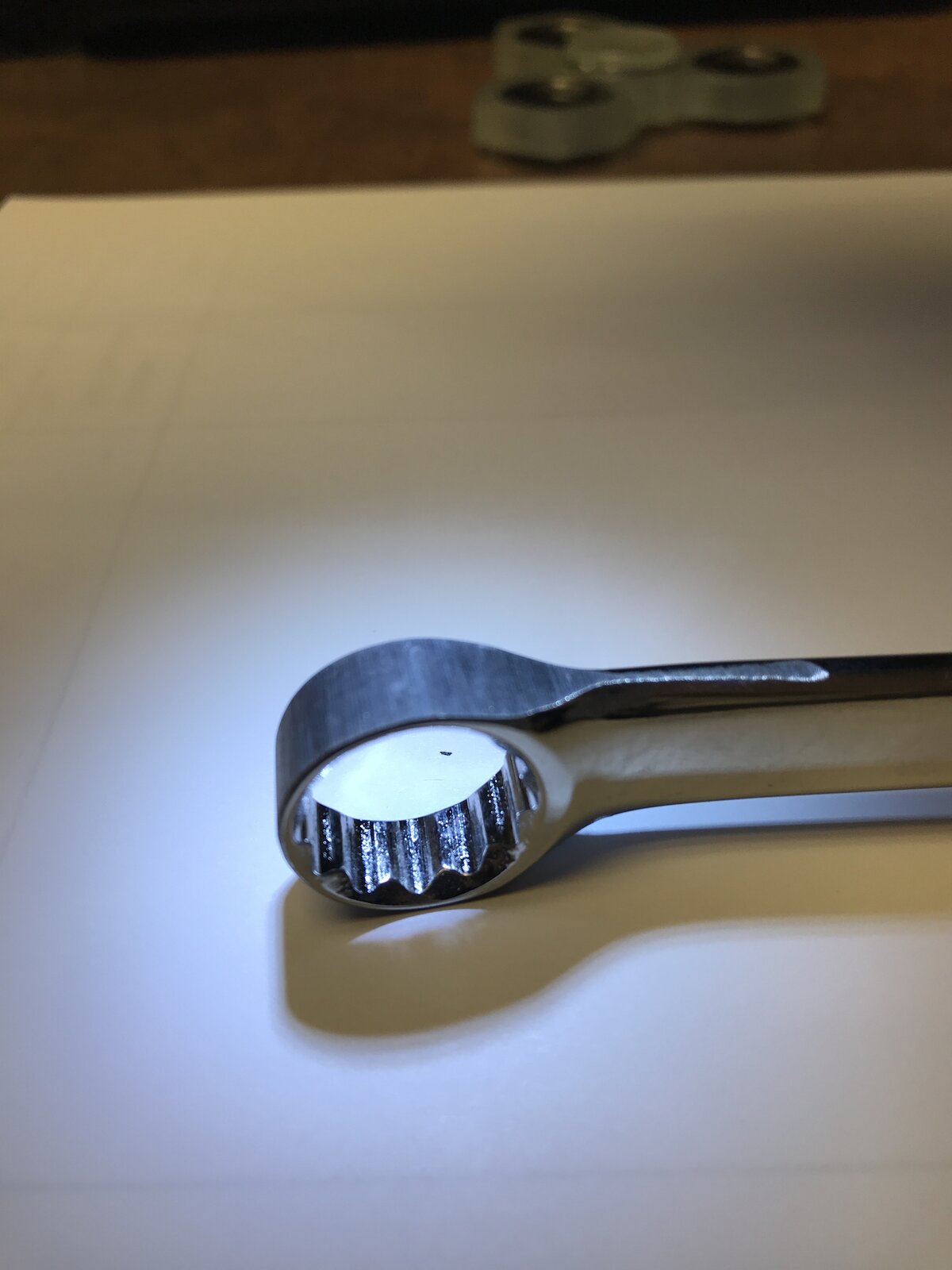

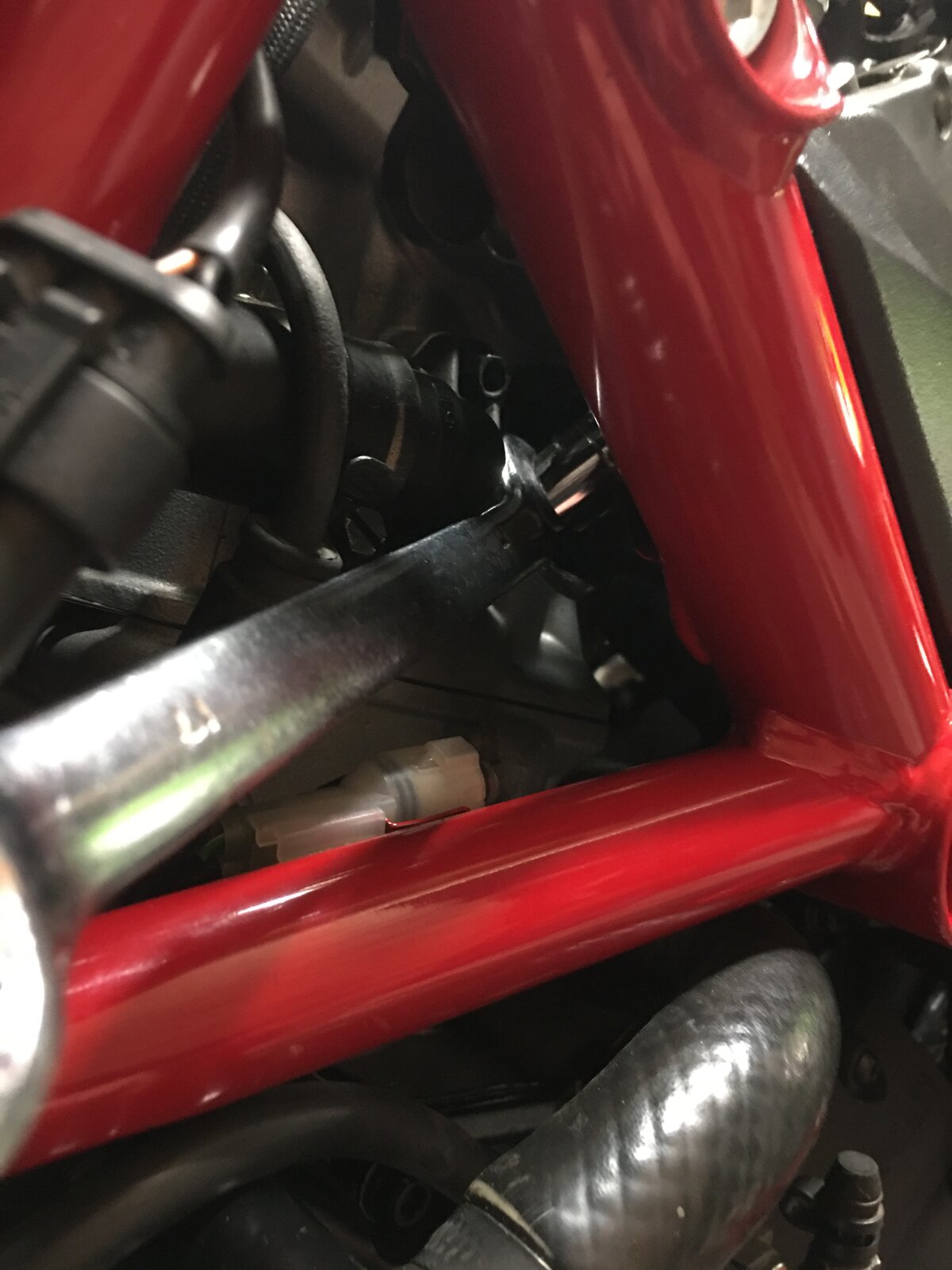

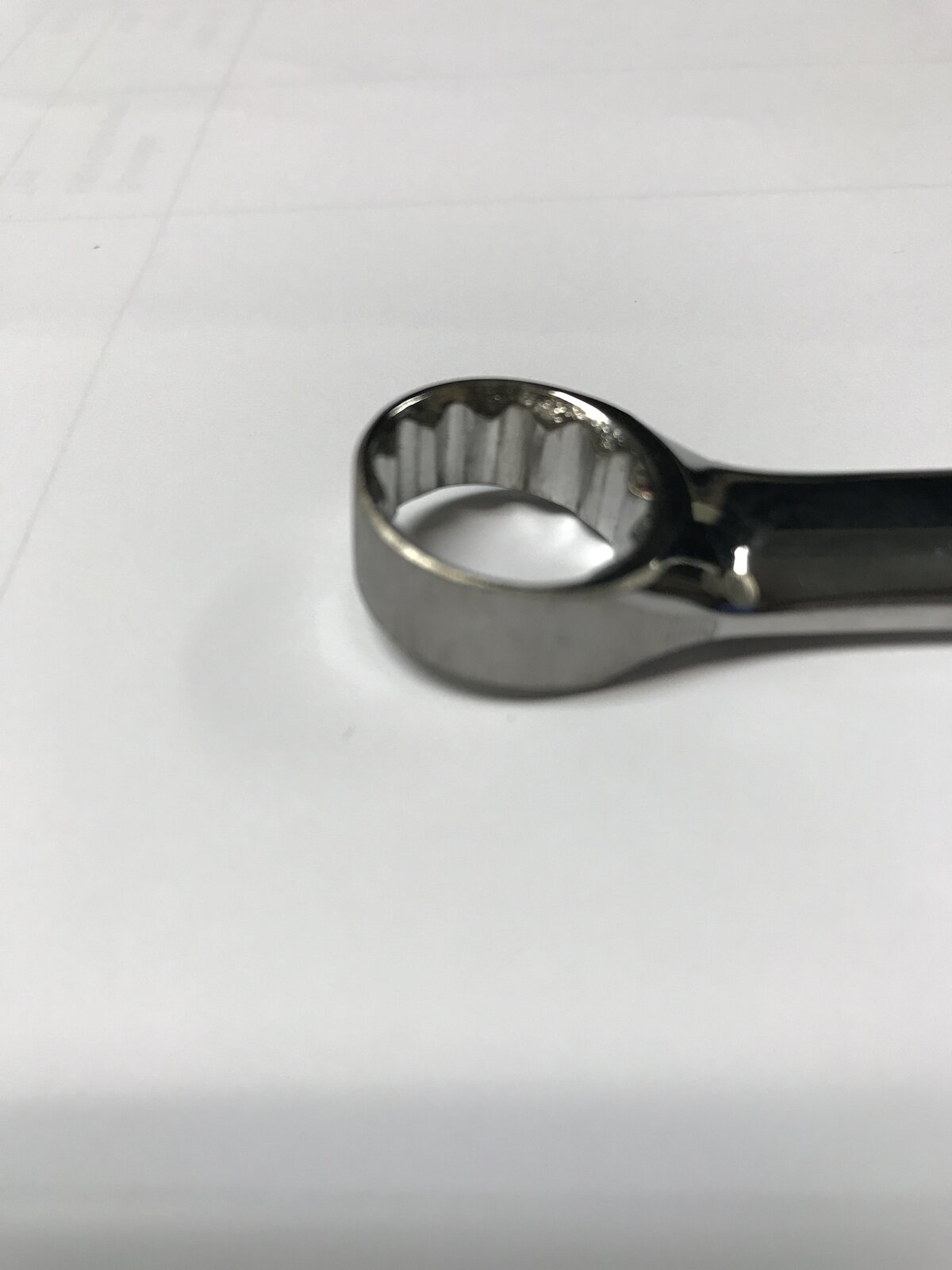

    For the bastard plug, my notes:
    Remove:
    - You have to take a normal slightly angled box end wrench and grind it down so it is thin (Photos attached). Use the front left plug to determine how much is enough to grind. You want it loose, not touching the alu head at all, for the full swing. Note full swing isn’t very far on the left rear plug. Once this is done you can reach in from the side and get it loose. Tiny turns at a time

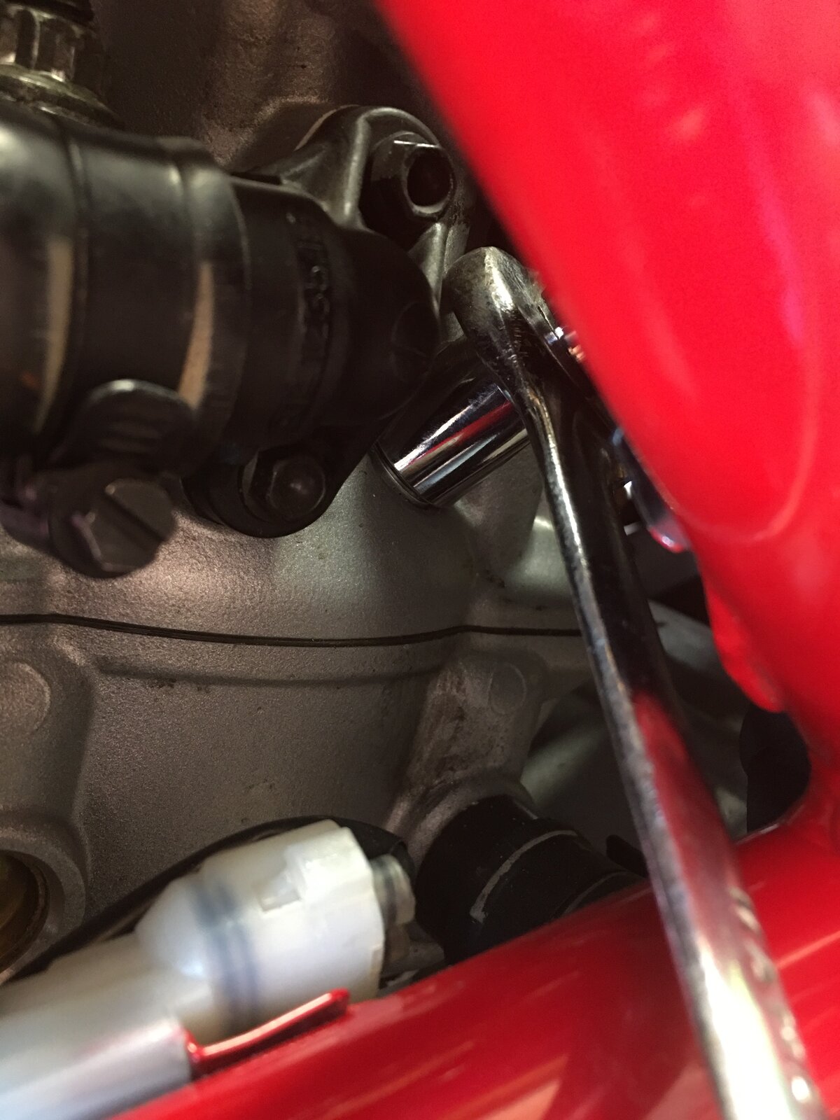

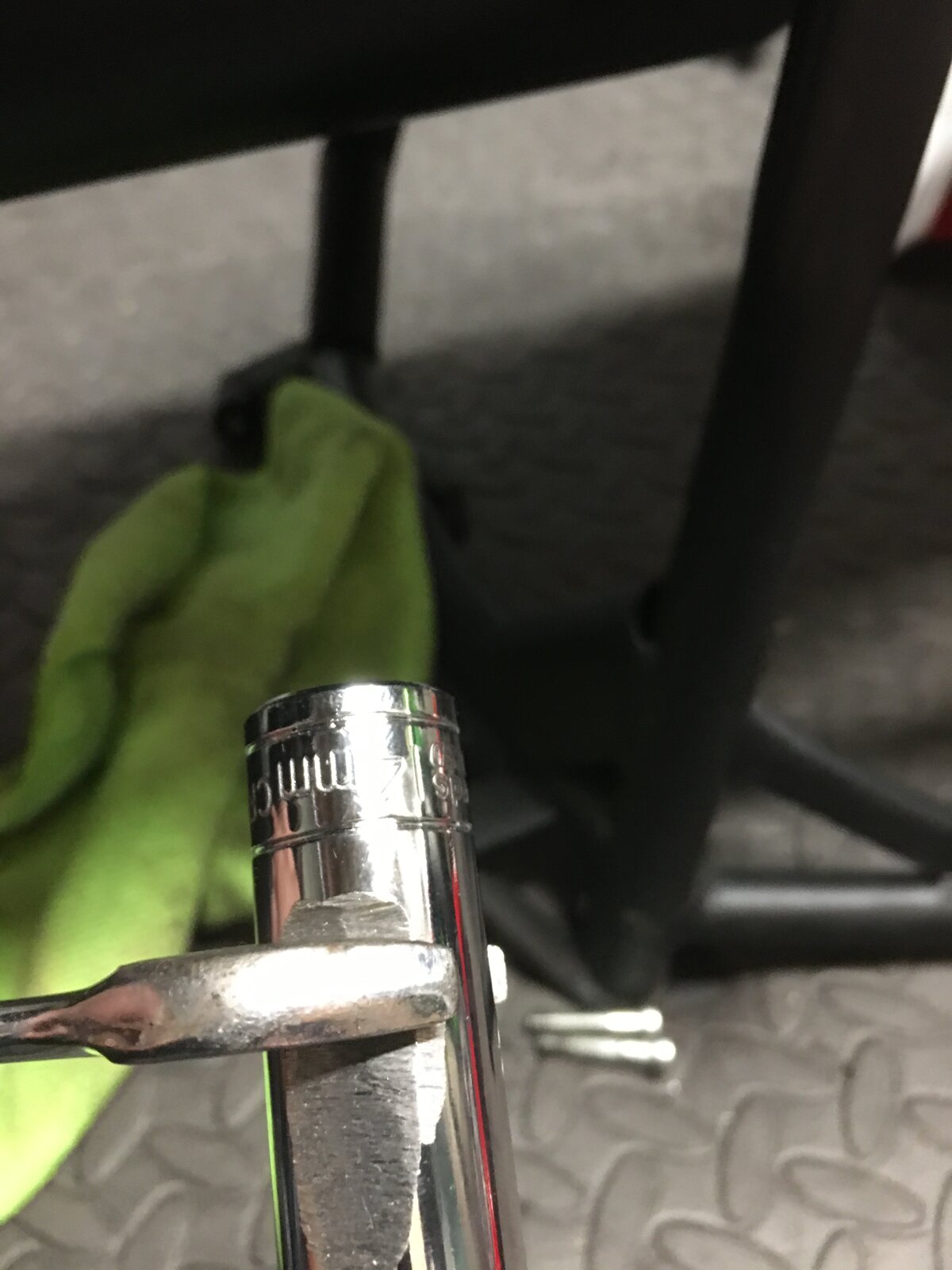

  6. B7780E66-7F7D-4E04-9EC5-D3E41618B61B.jpeg Right, my solution to the pesky plug removal, take a 14mm long socket , grind two flats to opposing sides to take a 17mm spanner, grind the flats where accessibility is easy, drop the socket over the plug and undo with spanner , really easy.

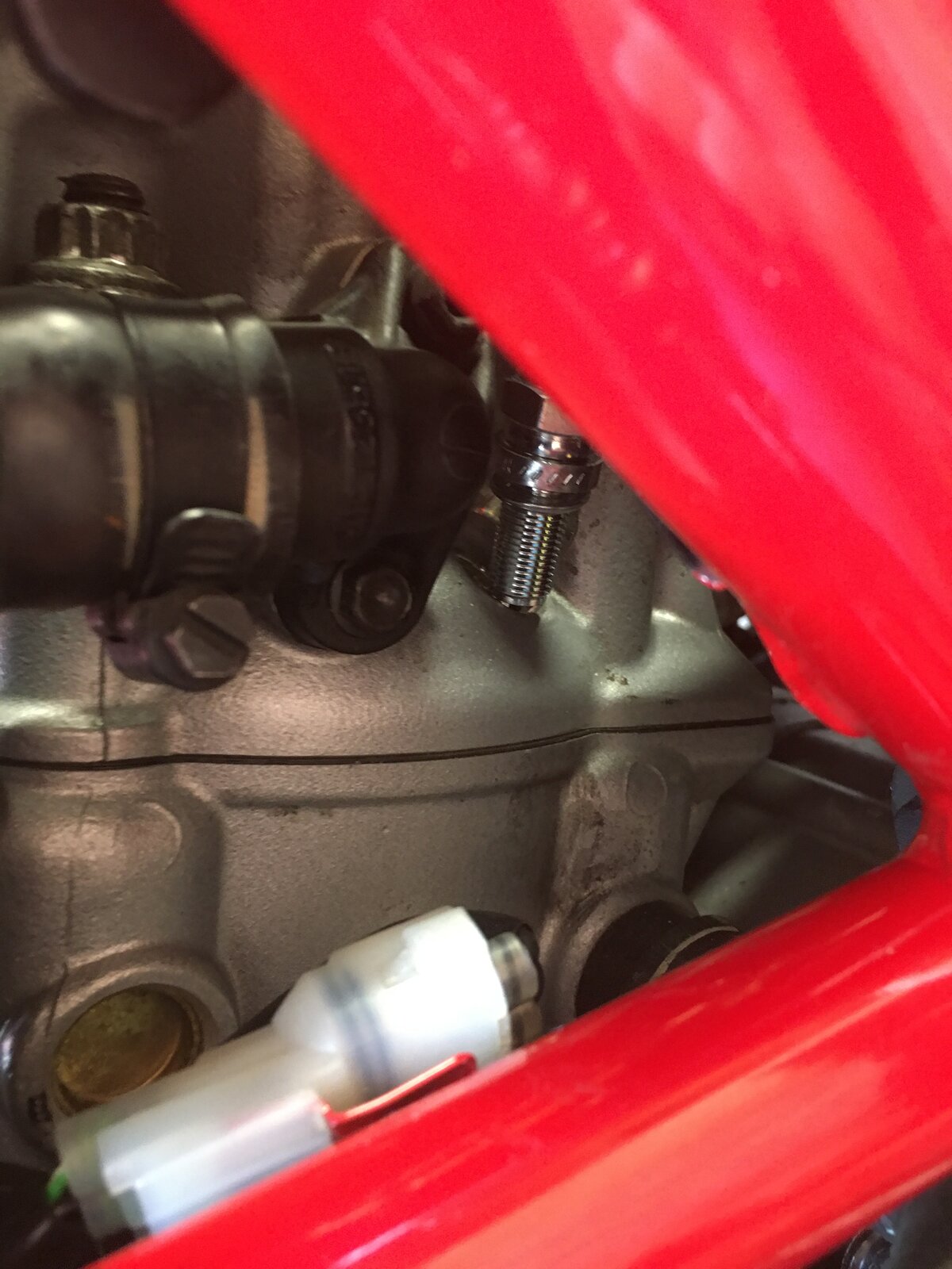

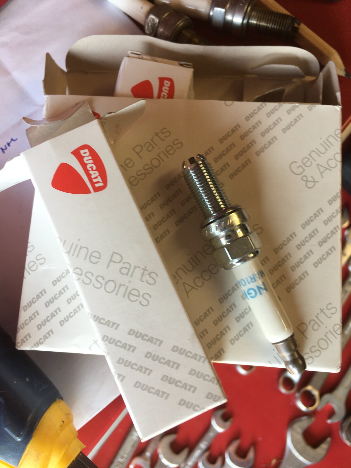

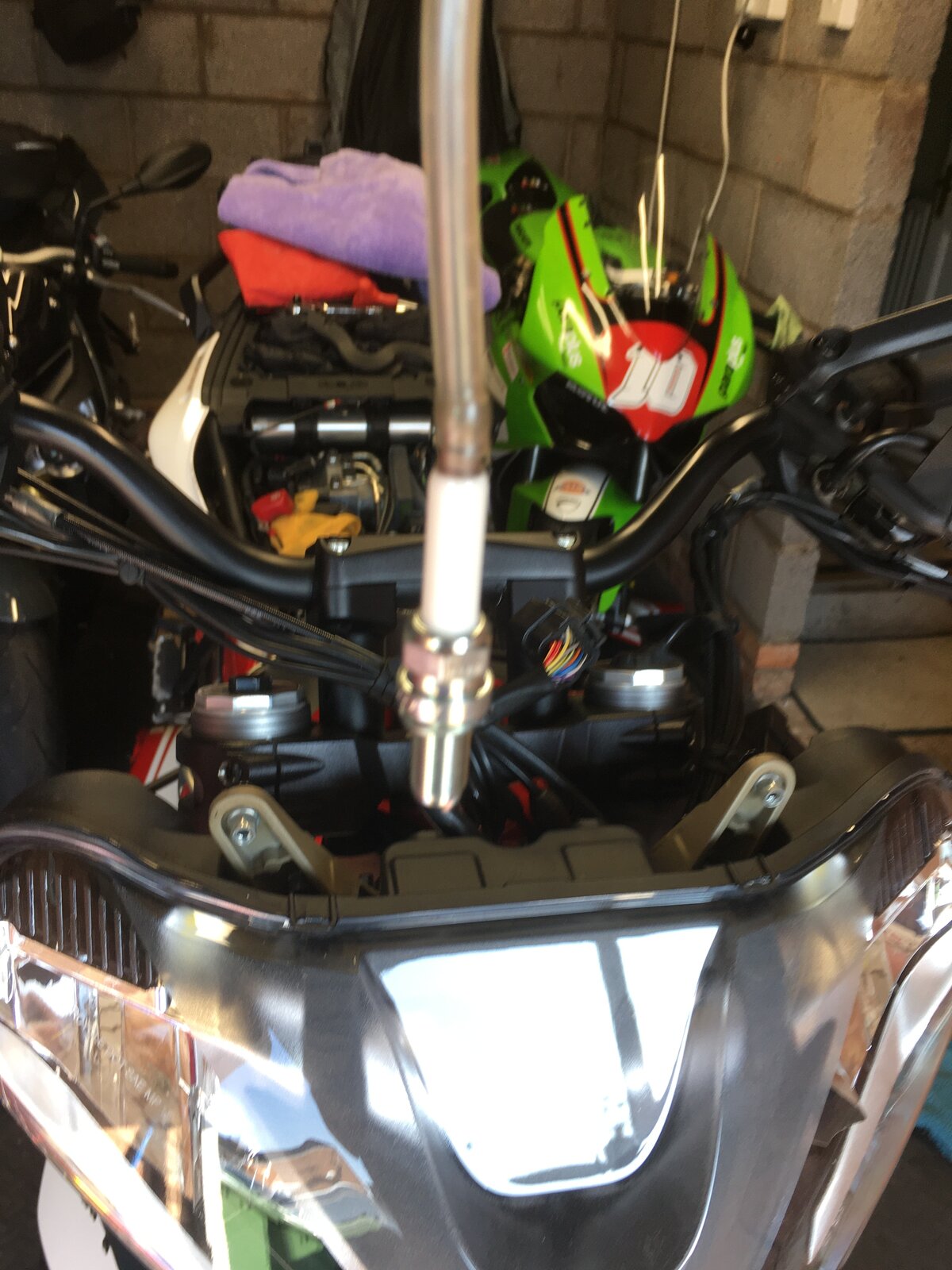

  8. 07737467-BA09-4A94-B9AA-3EC363B40E48.jpeg 889AE388-ACC9-48A9-98CE-A25860867B15.jpeg F9D5A120-BD2E-408E-97B3-F85C6711344B.jpeg 564629A6-3EC0-4815-B4EA-C86C94EA5698.jpeg 2C931714-EAC0-424A-B91D-E3F4D2DEA73B.jpeg New plugs finally arrived ,turned out to be fairly straight forward, attached the plug to some tubing and fed it down from above while guiding it into the plug threads and then when turning the tube take the weight of the plug with you fingers from below, plug turns freely until it reaches the crush washer then feed the socket on and tighten up, no way of getting a torque wrench on there so tighten to feel.
  9. Did you do the grind flats on the socket thing? What does your socket look like?
  10. Just a normal long reach 14mm socket, posted a pic further up the thread, worked a treat, obviously grind the socket where there is most room to get the spanner on .
