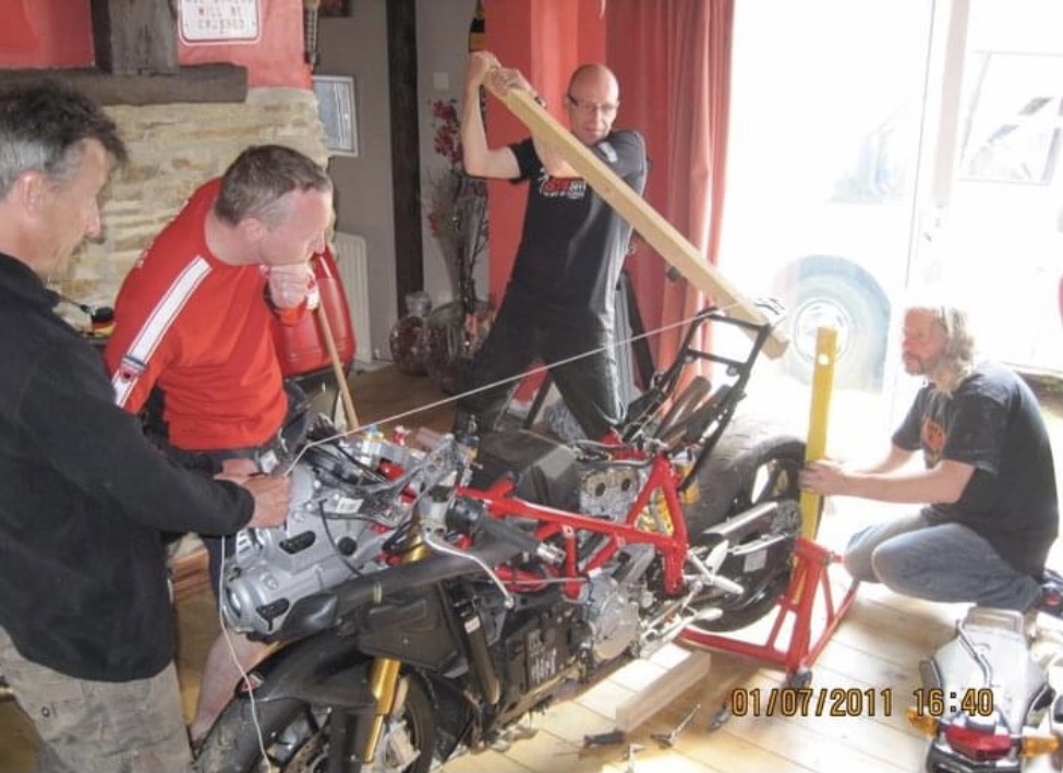

  8. I've seen people straighten subframes by eye with a long lever on TD's, as long as it's not cracked and it's a track bike it'll be fine.
  10. ;)
  11. Maybe motley but by-eck we get things done!
  12. Not sure of Derek's role in the process?
