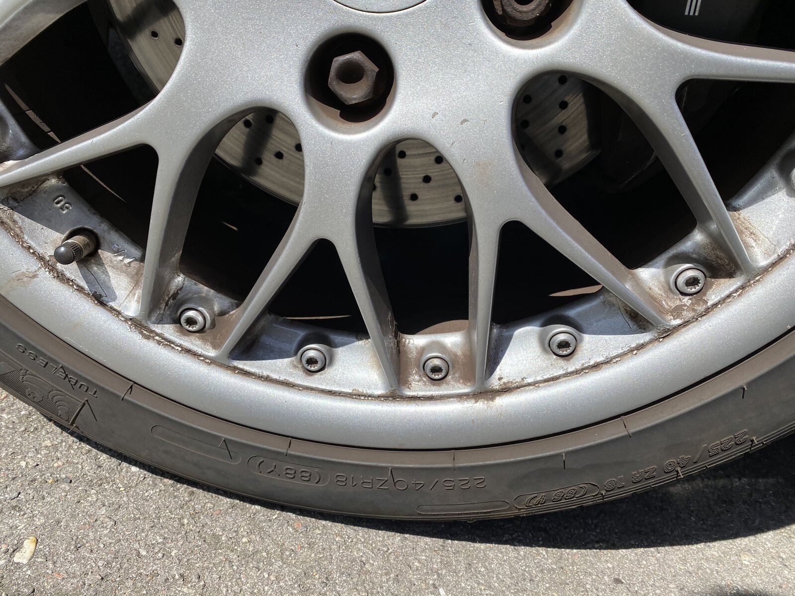

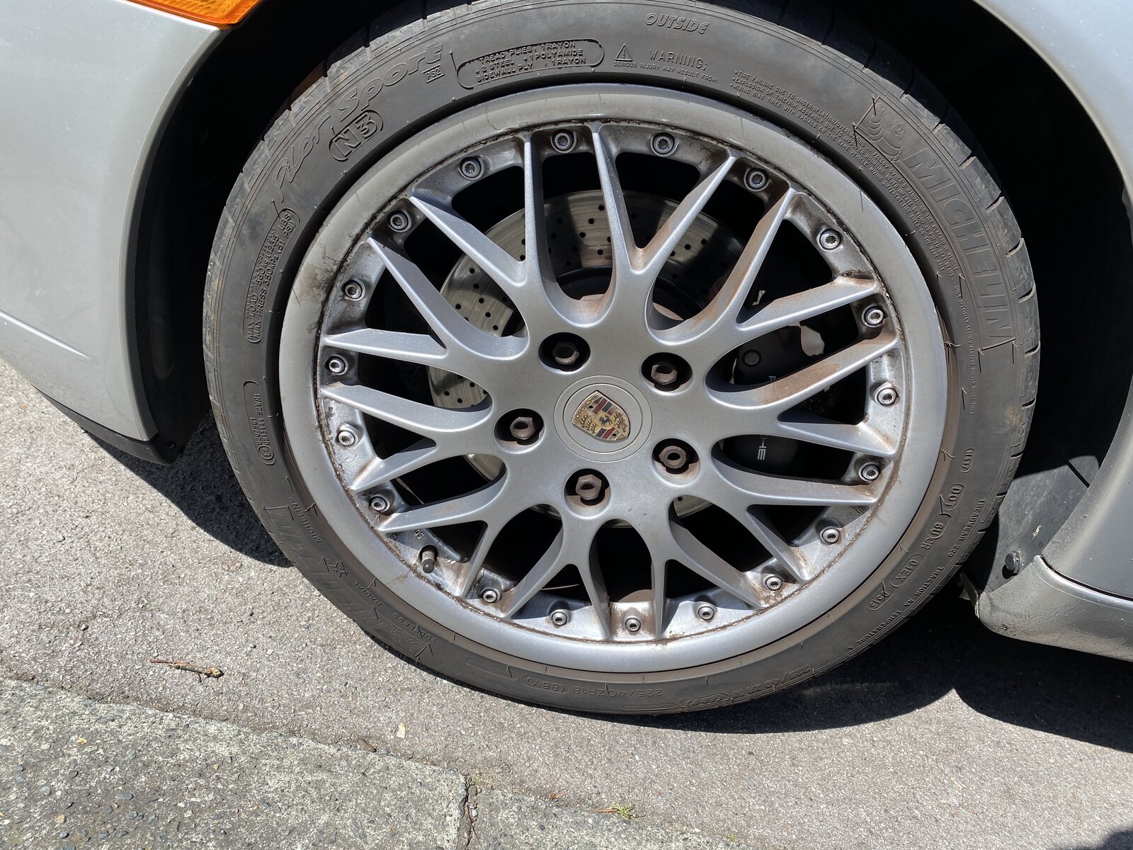

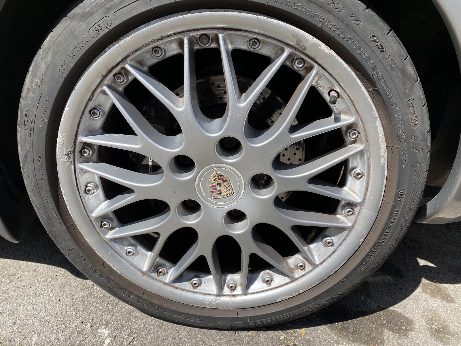

  10. Not fitted them yet
  11. New set
  12. V current set: 394309E7-EFA4-4EC9-A39E-BA33F83CB843.jpeg A2B83AB4-814D-424C-B29F-65E753B52190.jpeg 4FCC882E-DE05-4B68-BED8-33FF07BBA093.jpeg BE10BCD4-D510-4554-8E54-2770A3C7BD9B.jpeg

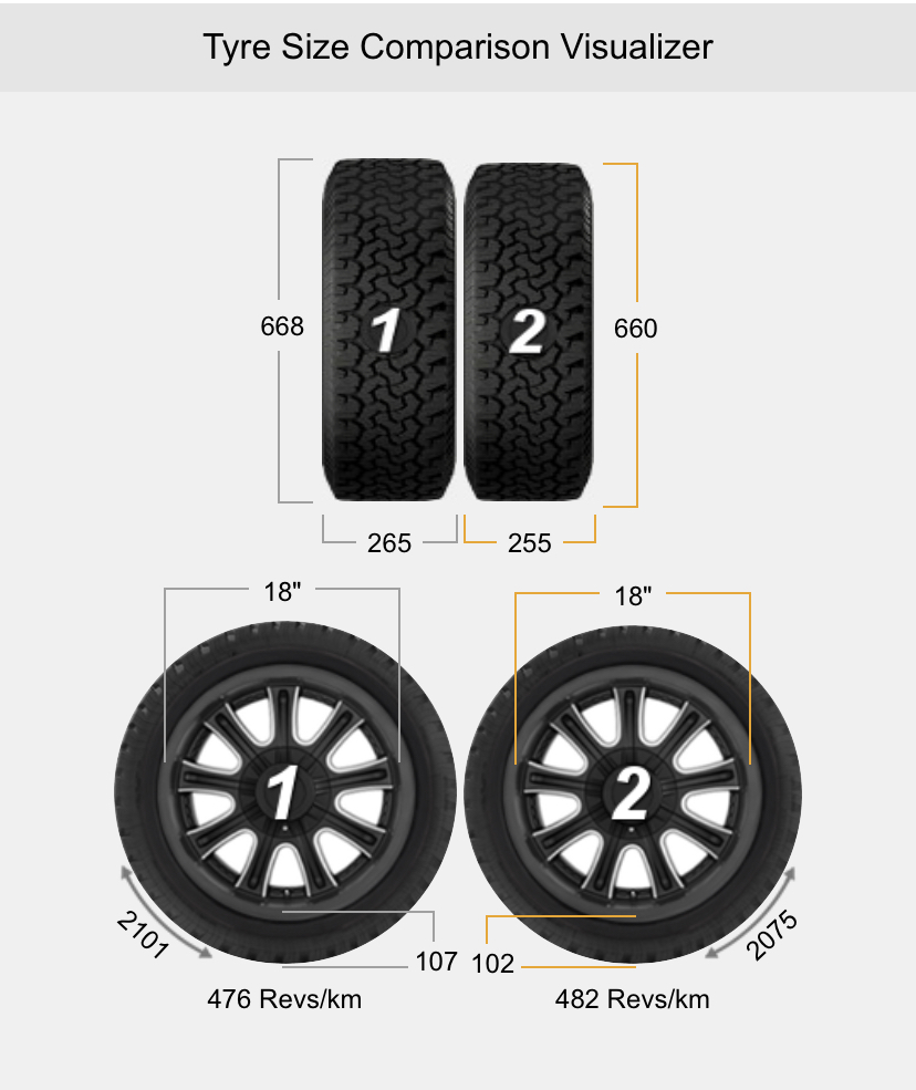

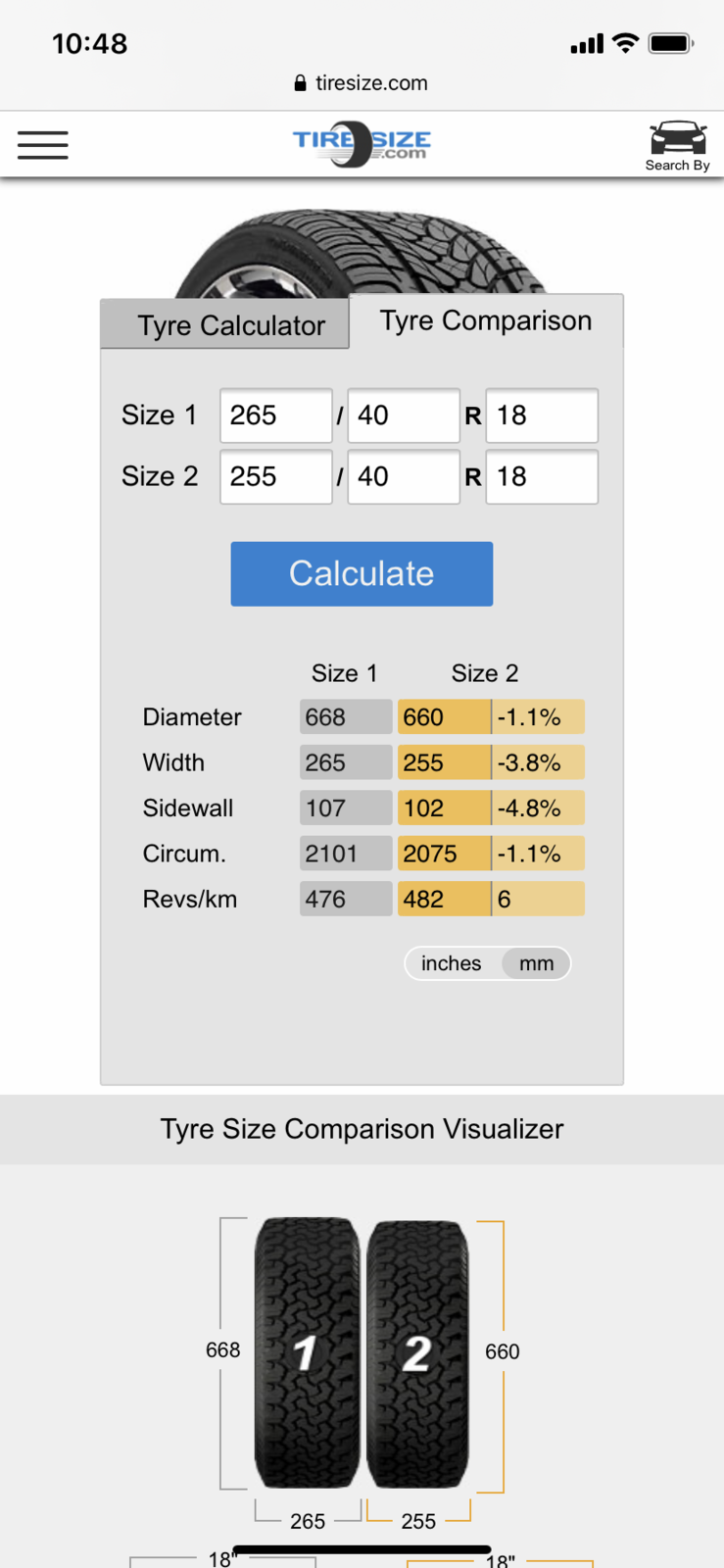

  13. Some have mentioned lowering it at the back but the profile is still the same at 40 on both sizes?
  14. They are axle paired so mot won't be an issue.
    Technically the profile should have been 45 instead of 40 to keep car same height but as stated its minimal really around 5mm over the whole tyre so 2.5mm top & bottom if this makes sense.
    As for insurance dont worry, they only check tyre tread depth really.
    Just wear them down then buy the right size next, or if it bothers you then ring a few tyre places that do new & part worn & explain what the situation is & they can take your old tyres as a px against some new ones.
  15. 40% of 255 width is smaller than 40% of 265 width
    To compensate it should really have been 255/45/18
