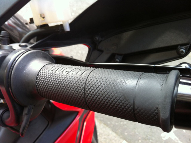

    I'm taking my Multi into the dealer tomorrow to get the heated grips changed (excessive wear) but I also want them to look at another issue that's come up in the last couple of weeks.
    The bike suddenly seems to have developed an intermittent fault with the throttle response. The throttle also feels like it sticks a bit, not a smooth action and smooth return (throttle spring or the cables need lubrication?). Initially I thought it might be the exhaust valve as it wasn't making a noise on ignition start up. I sprayed it with WD40 which seemed to help it work better. The problem also seems to get worse once the bike is hot.
    The bike feels like it's either about to rip my arms off at any second, or has no power and requires me to change down. As I say it's only recently and I'm going to get the dealers to look at it tomorrow but wanted to see if anyone else had any suggestions. It was serviced about 3 months ago.

  8. Problem solved - it was combination of dry throttle cables and associated fittings, solved with WD40 and the throttle tube was sticking slightly on the bar ends I'd put on.
    I was dubious about this as I'd put them one a couple of months ago without a problem, but the mechanic pointed out that I'd told him the problem had got worse as the weather got colder. The heated grips were expanding slightly as they got warmer and just rubbing on the bar end a little. They were also softer and more deformed as they had worn down. This also explained why it was intermittent and was also better when the bike was cold - an additional washer when they fitted the replacement grips has solved the problem.
    Sometimes it's the simplest things...
