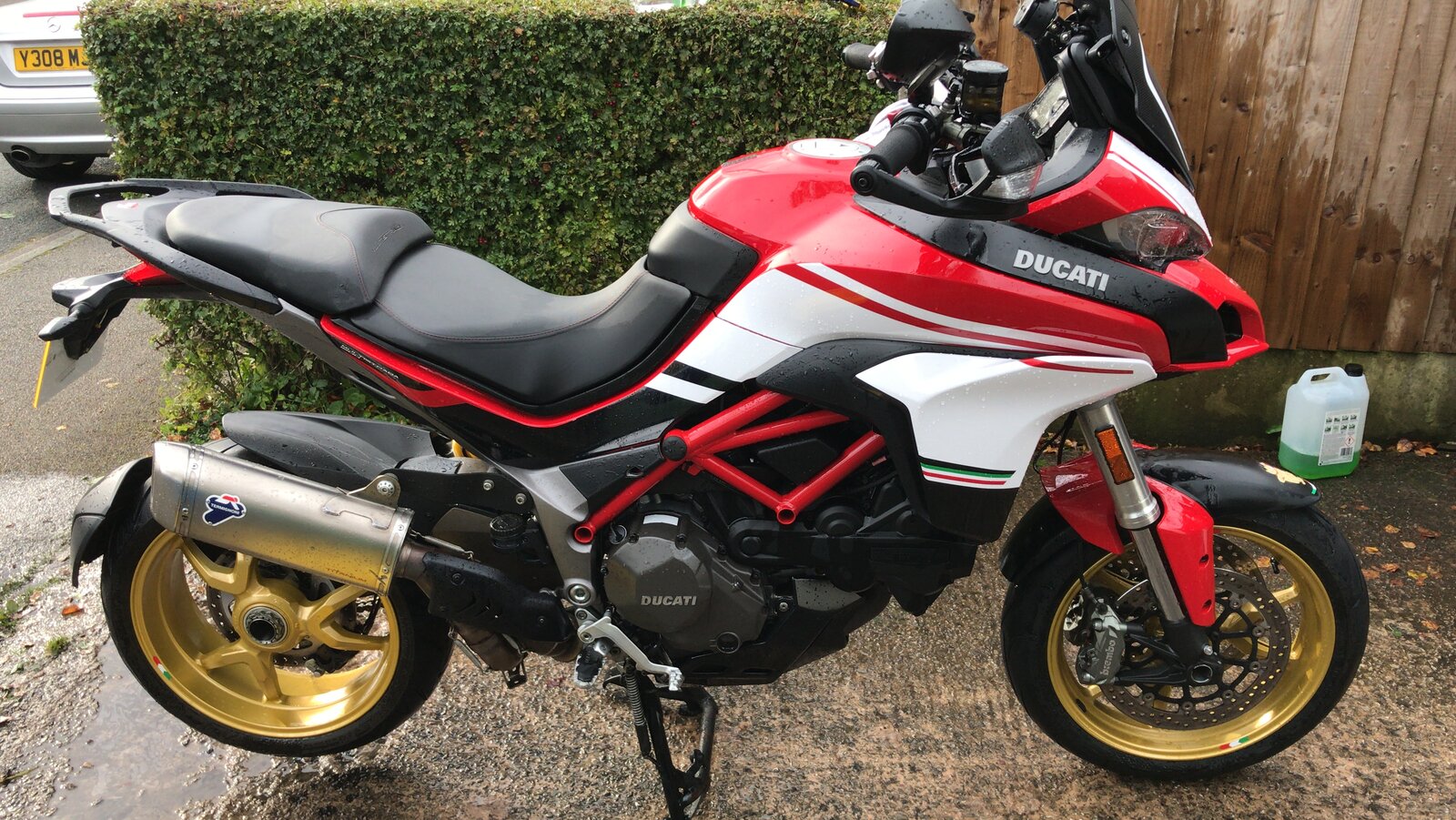

  11. Got at the upmap done this morning, berrrrlimey what a difference. It makes it seem like the plugs were mucky before.
    First wash since the Pyrenees. Fooking love this bike :heart_eyes:
  12. Looks good with the gold wheels!
  13. Where did you get it done?
  14. Manchester Ducati. Charged for 20 minutes, about £18 iirc.
