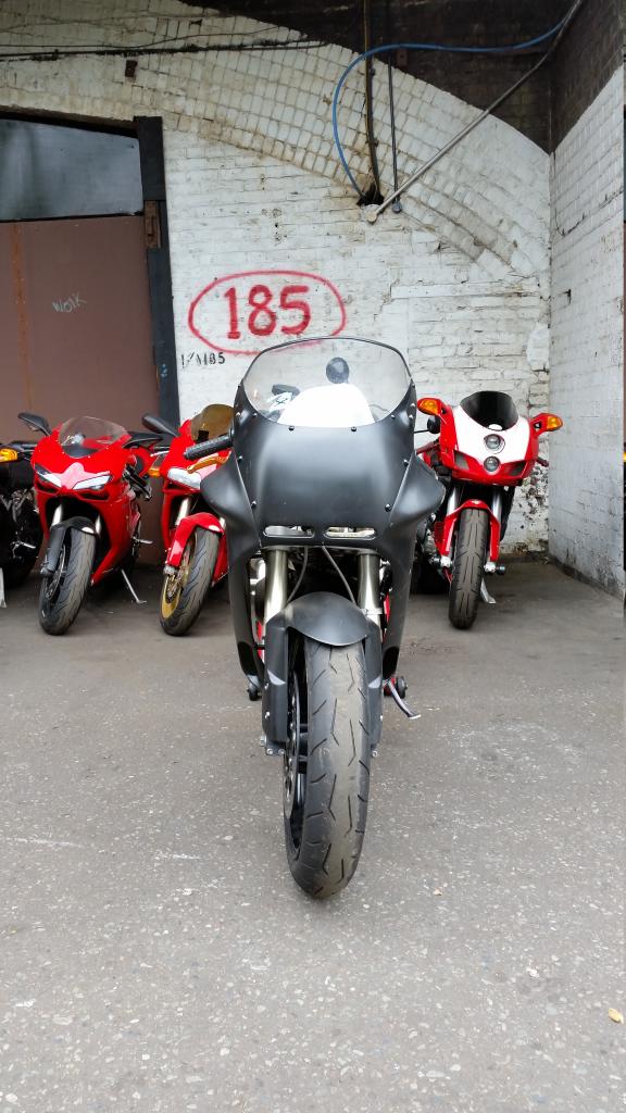

    Can you notice the upgrade?

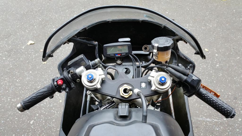

    Need to finish the temporary dash layout but a lot of weight has gone, thanks to a Motogadget M-unit and Acewell dash... and the Highway Dirt Bikes switch gear on the left for 1. Start / Kill 2. Hi / Low Beam 3. Horn. Indicators are on the clutch lever

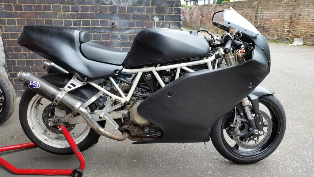

    This is definitely a work in progress but WOW it feels so much better on track now. Just need to add a subframe for headlights and it will be back on the road too.

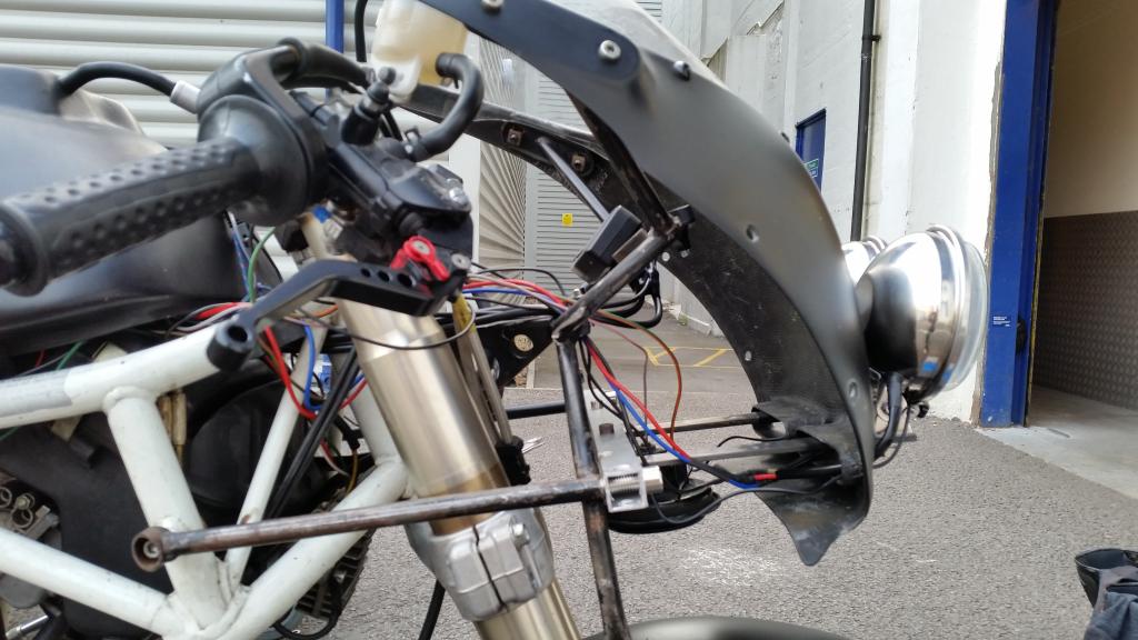

  10. oh, and what it looks like underneath the fairing!
    A bit more of a trim than allowed in DD...
    My front sub frame hacksaw handiwork....
    More to come once I have tidied up the electrics and worked out where to put my 3 mini ultrabatt batteries.

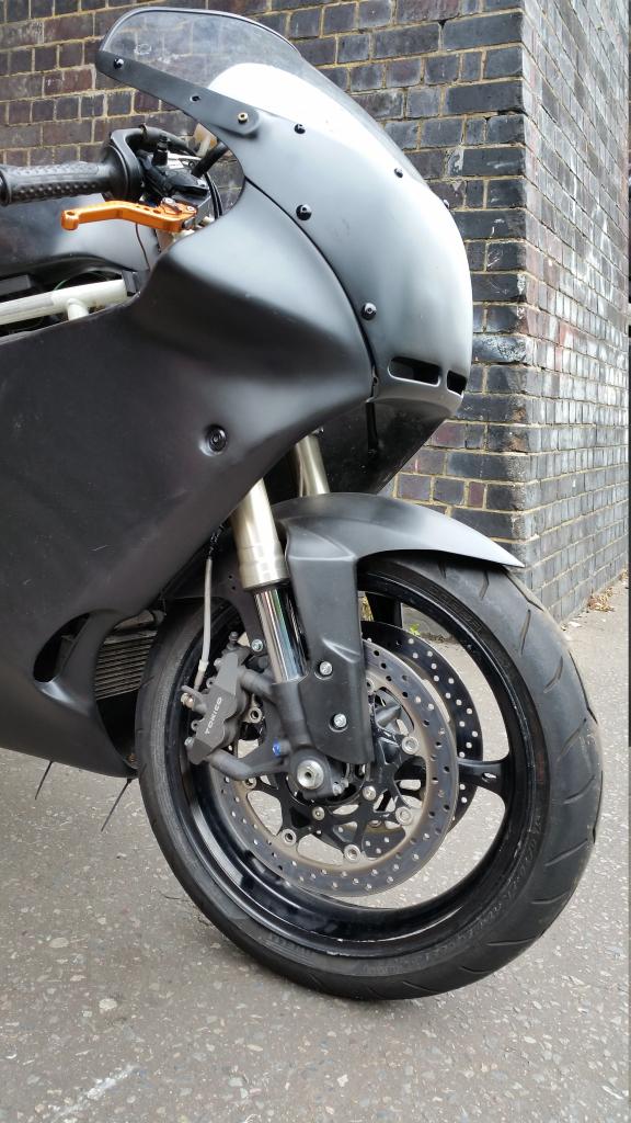

  11. I had a question about how hard it was to fit the complete suzuki front end to the SS..... answer is: It's not!
    There are 3 key changes
    1. 2 head bearings:
    Simply Bearings Ltd
    52K/30KW Narrow Section Steering Head Set Taper Roller Bearing 30x52x16mm £17.95 each
    2. Bump stops, i bought 2 rubber reservoir holders from a suspension site.
    Mounting Hardware
    Fox remote reservoir rubber mounting block £4.01 each
    3. Drop the triple clamps down the forks. The GSXR forks are a few cm too long but there is almost enough adjustment available on the fork body. I am going to add some shims from 1 and 2mm alloy to give a little extra support for the clamp overlap. Moderately easy.
    Main benefit is the light wheel, but the super plush suspension and epic brakes aren't so bad either :)
    If you wanted to just get the forks, they are the same diameter as the SS 91-98 forks around the clamps (as far as i can tell........) but then you need to start mucking about with spacers and bearings on the axle.
    Oh and the forks are:
    Suzuki gsxr 600/750 k6/k7
    Hope that helps.

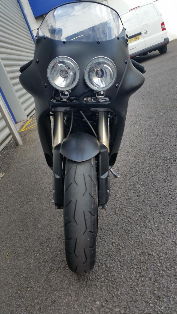

  16. OK, i'm getting to a point where the main components are finished..... in draft form at least. But one thing that hasn't worked is how the headlights look.
    Can anyone suggest a source for the lights from the 750 F1 below as they look a lot better than my 4 1/2 inch, 6cm deep lamps....
    The look i want, looks like 5 inch very shallow old school lamps:
    The look i have :-(
    But otherwise the bike is going well. lost lots of weight....
    And had some good track days!
