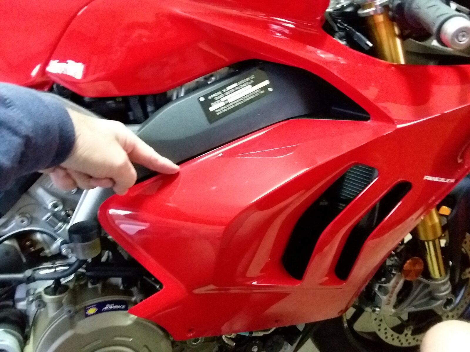

  1. Help please. Have removed the two screws from upper front, the two from inside the wheel well and the one from under the nose. The three velcro tabs on the tank are detached and have un-hooked from the stub that projects upwards from the frame. The only thing holding this section of fairing onto the bike is a fixing point immediately below my finger.
    Can anybody tell me how to disconnect this point?
    It looks like it might just pull straight out but I've tugged reasonably hard and it doesn't want to let go. Thought I'd ask the brains trust before I break something.

  4. Thanks Mary, yes got the two above the fender. The whole thing is now loose without having to remove the nose. Just that last one in front of the reservoir is my problem. Seems no way to get a tool in there so I'm assuming it's a post and grommet, simple pull free, but it seems very strong (IF that's what it is).
  5. Thanks AJL, but these instructions are for the 2018 and 2019 models. The 2020 with the gills has one specific attachment point on the upper side fairings that is different to the earlier models - and that is the one that is giving me a problem.

  6. Never mind. Got it.
  7. I'm having this same exact problem. How were you able to finally remove the fairing? I can't get that fixing point off
  8. I know it's intimidating but it is simply a matter of pulling directly away from the bike. There is a thick rubber grommet on the fairing that is plugged onto a large steel stud poking out at a right angle from the frame. It might slip off easier over time but initially, at least, mine has a very strong grip.
    After removing all other attachment points I grabbed the fairing on either side of the grommet and pulled back while rocking from side to side. You'll feel it easing away hopefully before launching yourself across the room. And yes the fairing is quite strong.
