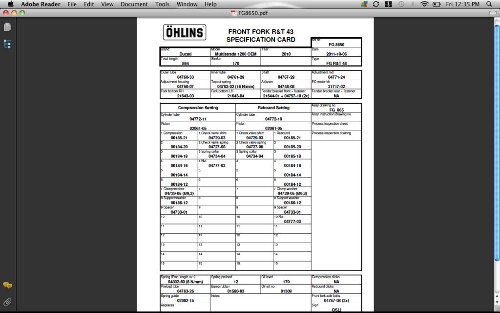

    7.5Nm is an upgrade spring... Not sure of the variety of weights on offer, other than 7.5Nm...there are probably heavier weighted springs available. Any Öhlins dealer should be able to advise on the options.
  3. These are the stock electronic spec's. You can call Dan Kyle in the USA, although I'm sure there's someone local, he's very knowledgable on the ohlins. I went from 6.0 N/mm to the next size up to 7.0 N/mm.
