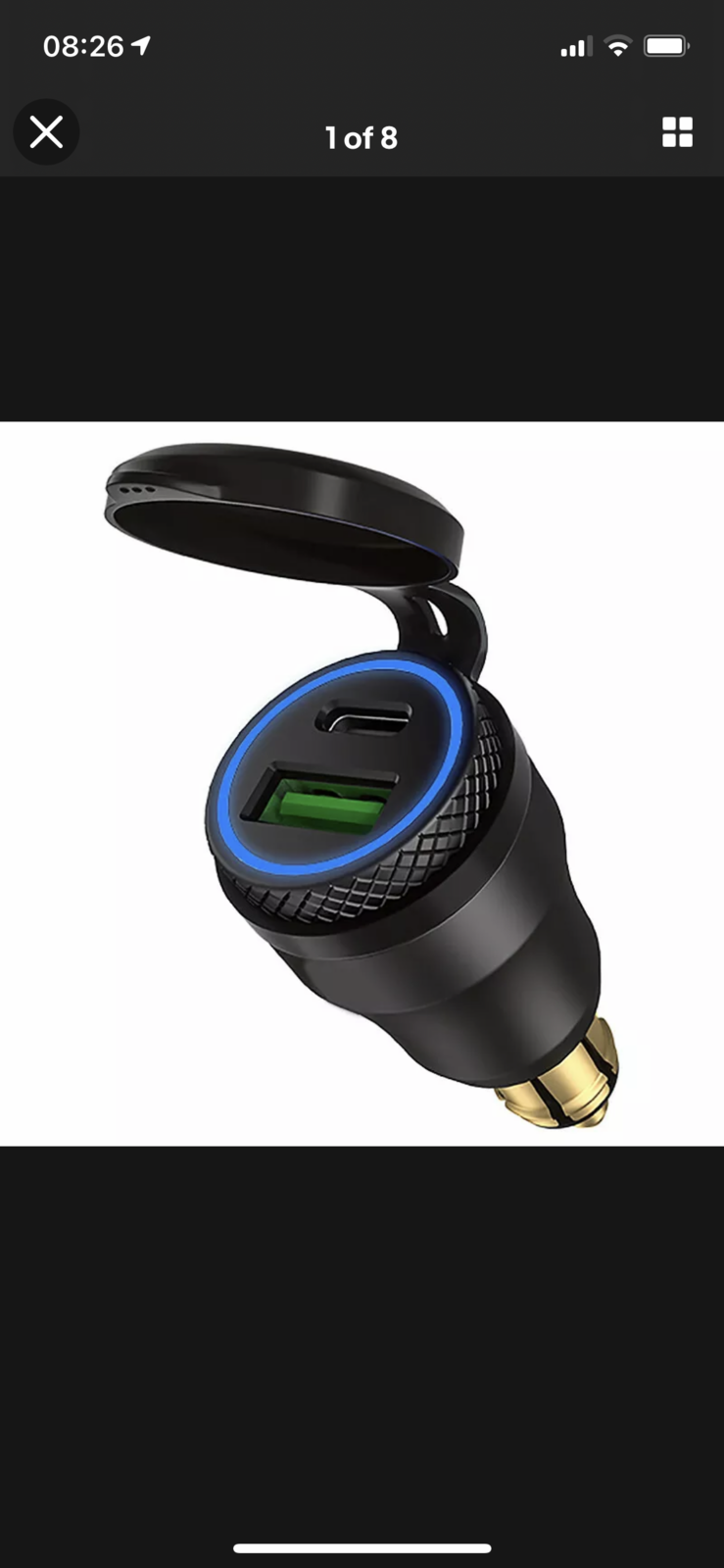

    Was thinking something like this, cheap and just plug into the socket near the handlebars then use a usb cable to the phone.
  4. Lots of options and choice for those on Ebay

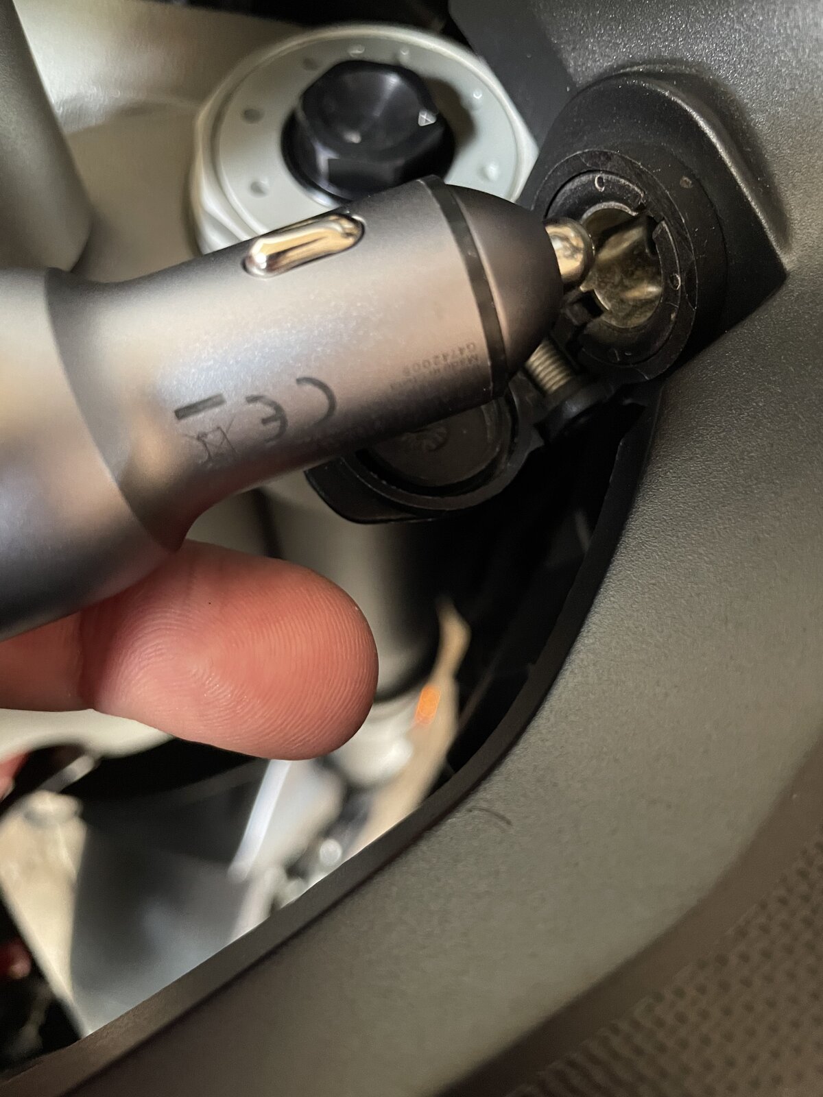

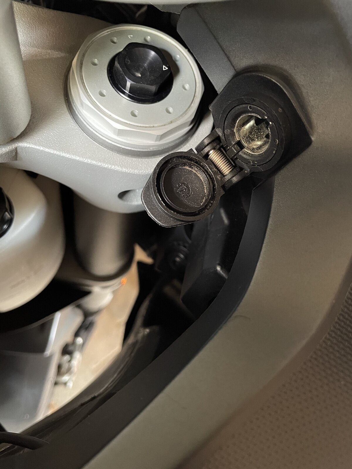

  10. This is the slot I was thinking on the Multi.
    The charger in pic was from the car, obviously a size difference, hence looking at the one I showed earlier, hopefully it fits if I order one…
  11. Yes I've got a large collection of ridgemonkey gear, though I use the PD car adapter with my two power banks/vaults for items. Got a tank bag which is wired from a the DIN hella port you are showing. You would need a din hella to12v socket lead.

  12. Cool its okay at 28W but not power-delivery rating/fast-charging of 45W or the newer 60W standard. It'll do the job'

  15. I've i̶n̶v̶e̶s̶t̶e̶d̶ wasted a lot of $ on testing many of these DIN adapters with different sizes and angles. They're all too big.
    Best solution I've found was to fish a USB cable that fits your device from back to front.
  16. Likewise. Don't bother. Even if the fit is ok (it often isn't), vibrations will rattle the whole thing until your charging cable or the DIN adapter disconnects . Really not practical.
    Only reliable solution is to pass a long USB cable from under the seat.
  17. Since I don't use a sat nav I've wired a double usb to the handle bars from the accessory plug harness hidden under the l/h fairing to keep my phone topped up.
    I'm planning on removing that DIN socket and wiring up some after market heated grips to it.
