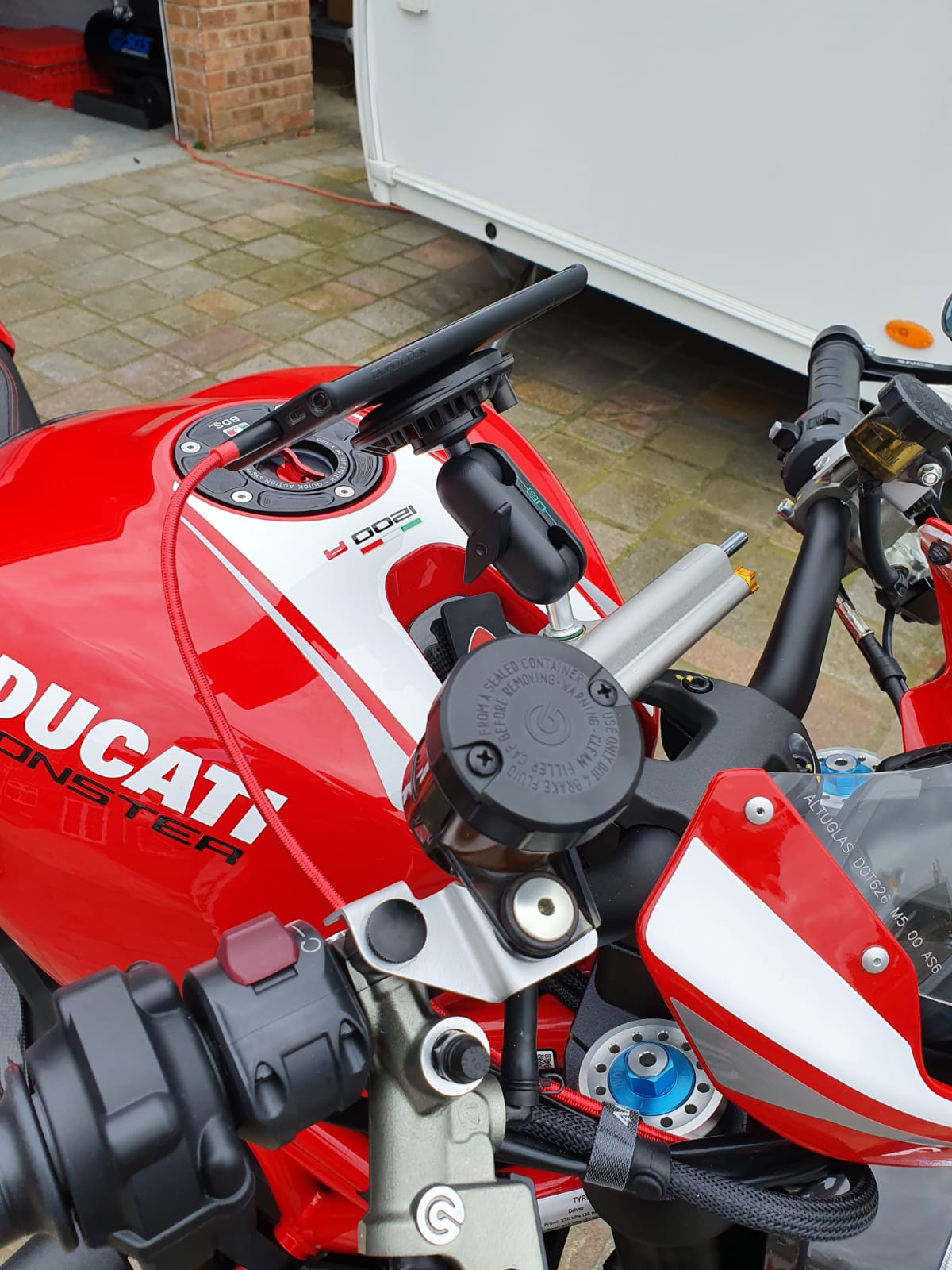

  1. Can anyone tell me if the monster has a USB charging port?
    I'm looking to purchase a quadlock phone mount with ball adapter and would like wireless charging.

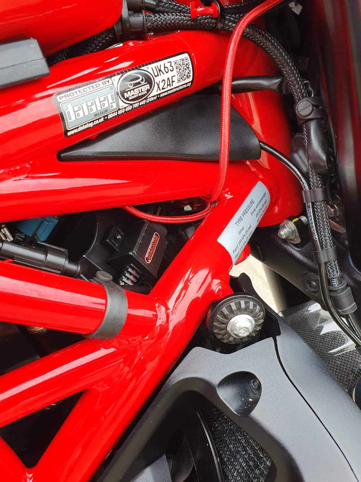

  2. I’m told there’s a switched live feed under the front of the tank, lhs if I recall. There certainly is on the S model. It’s a small white connector from memory
  3. None on my 2016 1200R - I bought a 12v USB adaptor (£12 Amazon) and got dealer to wire it into switched live from ignition (under the tank). The adaptor has the connections and importantly is 5v not 12v.
    Just got the wireless Quadlock but not been out on bike to test yet.
  4. You want to make sure any USB socket you install is rated at a minimum of 2.1 amps.

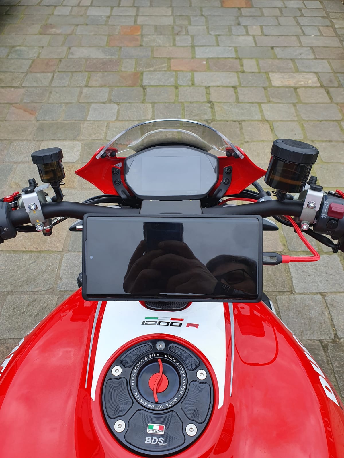

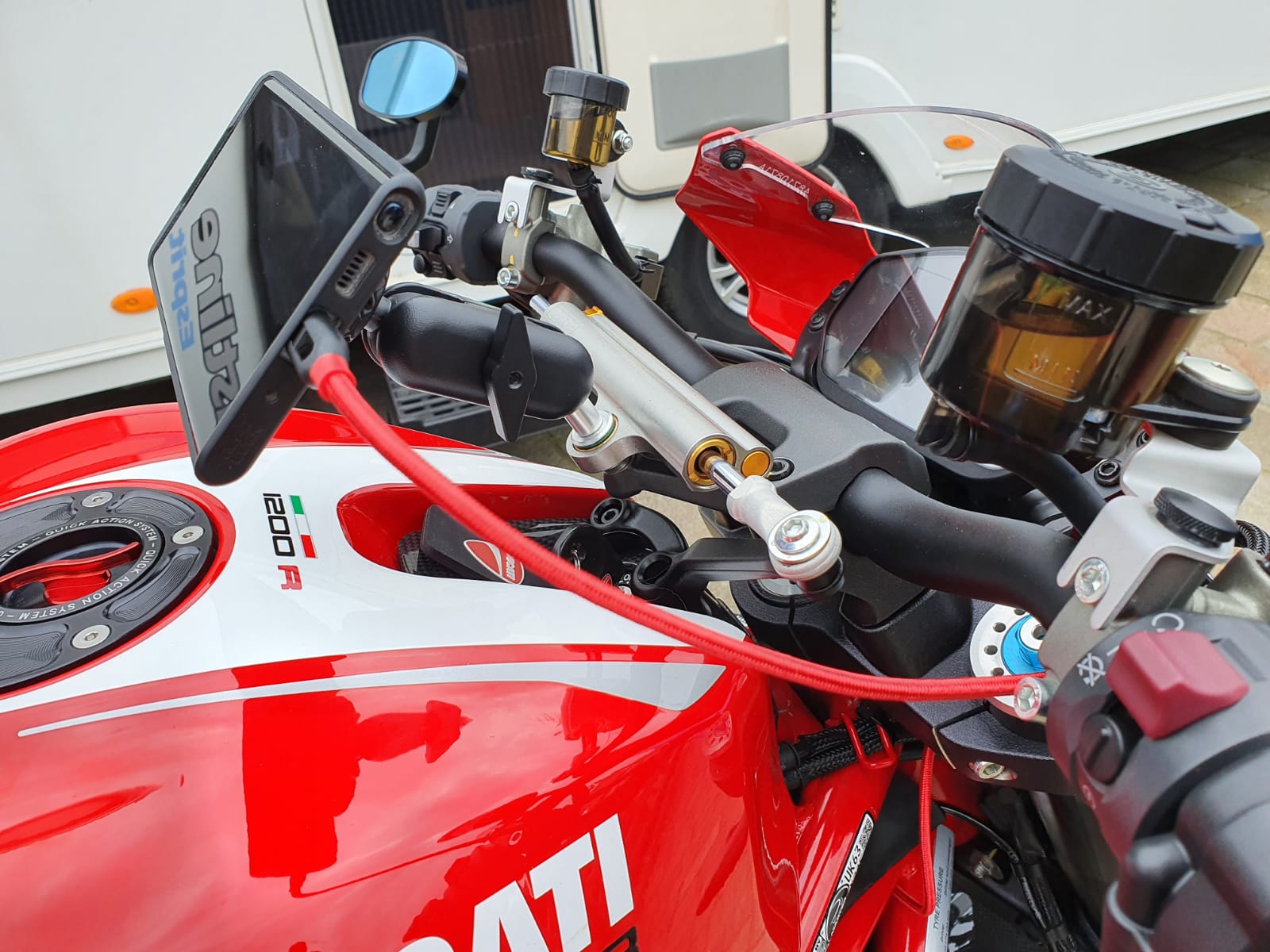

  7. Finally sorted with the USB charger and phone mount. Works great and is very stable.
    The eagle eyed of you will notice that i have a wireless mount but I plugged the USB-C lead directly into my phone.....it had been a long day!!

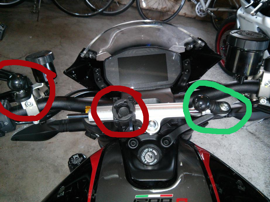

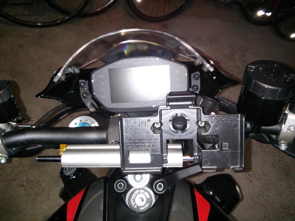

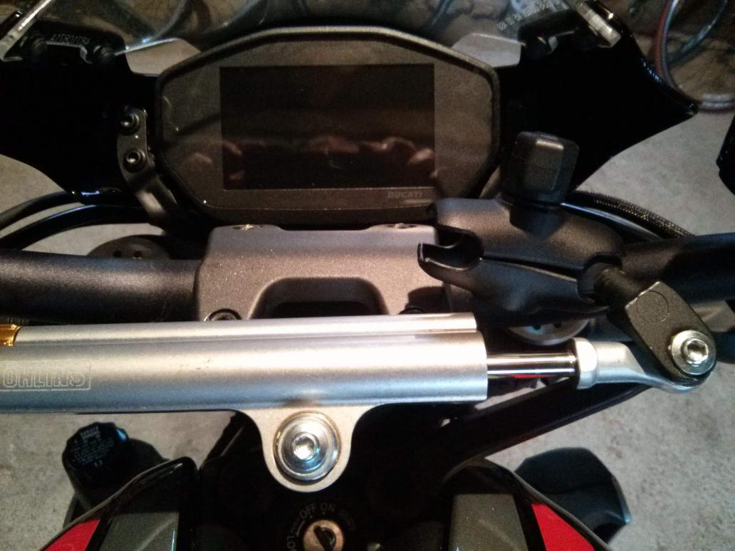

  8. I have tried a few ram ball base pieces to attempt a flush-mounted solution.
    The best was this one:
    http://www.rammount.com/part/RAM-B-272U
    It fits right side up and upside down where the latter will position your unit 1" both forward and lower.
    Your preference may be determined by the size of your device.
