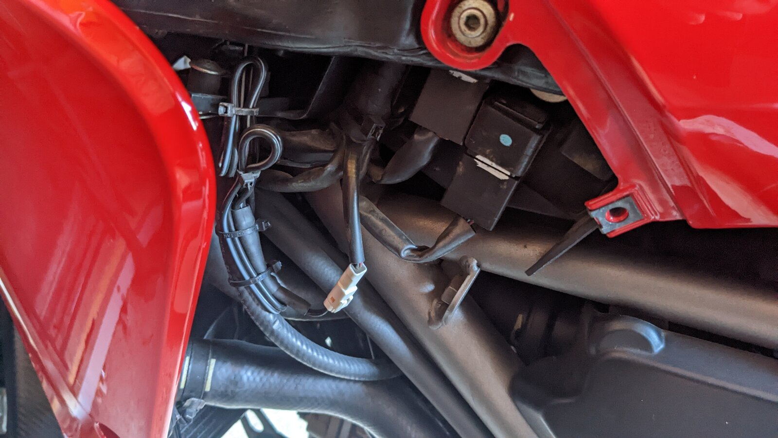

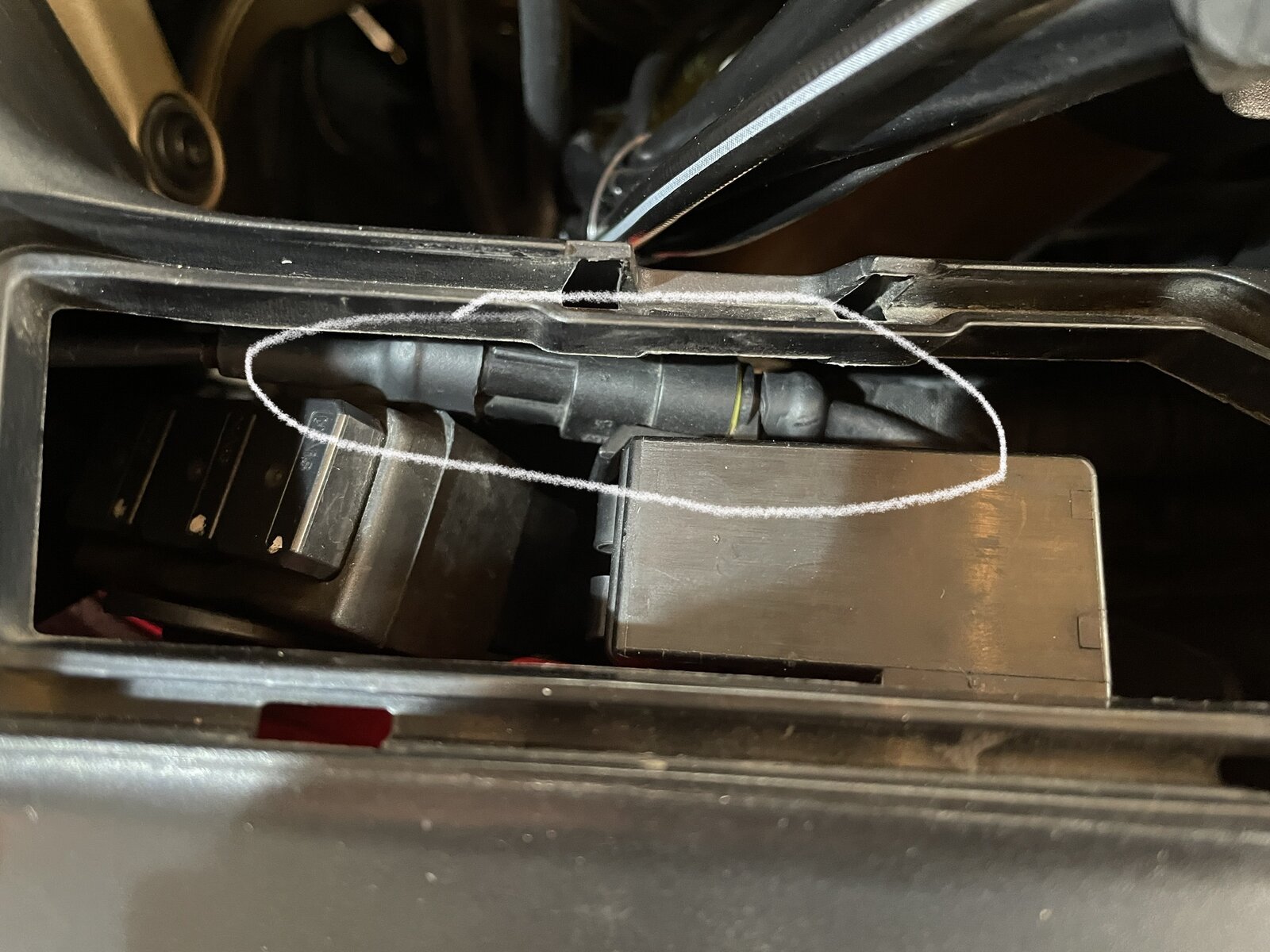

Behind the small, black, left hand, side cover held on by 2 screws, there is a switched live feed with a heat shrink wrapped blanking plug fitted. Andy
@Chris1H, if you are careful, you can remove the heat shrink from the blanking plug and re-use the pig tail wires to wire in your quadlock. Andy
