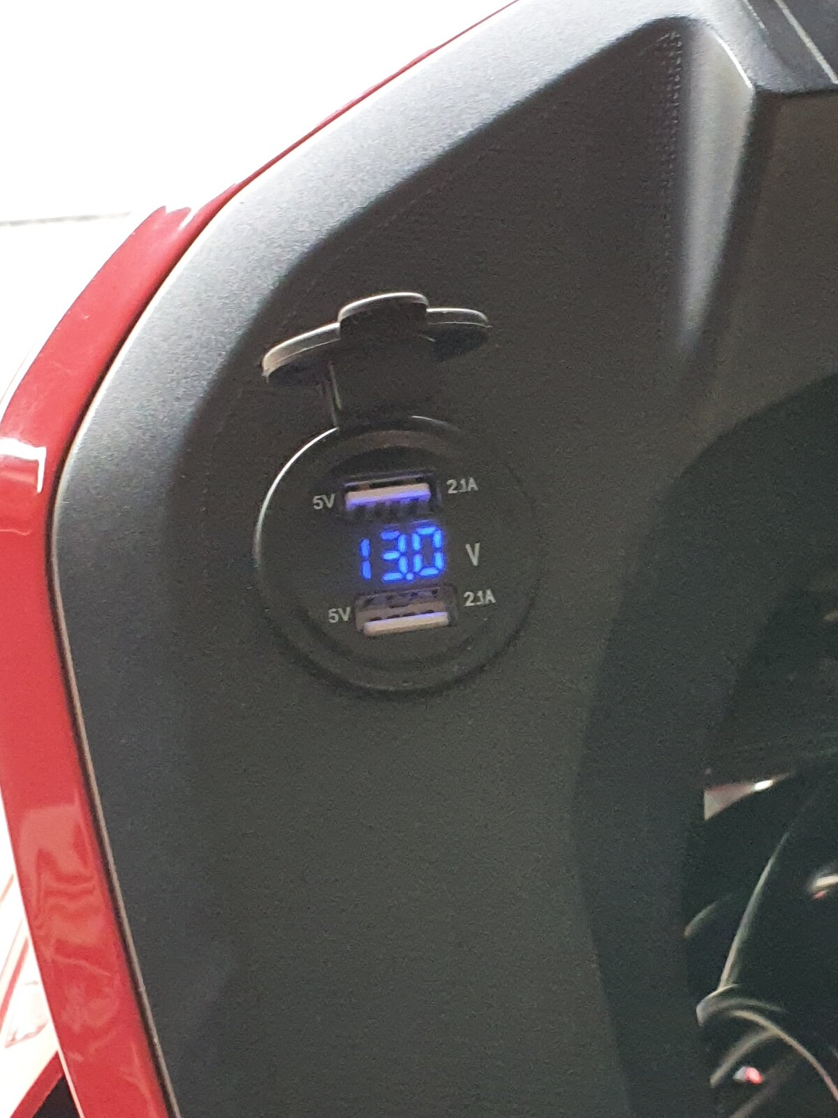

  1. To power my mobile i at first bought a dual usb port with a din connection to plug into the available socket on the RH of the front cockpit.
    The position of the plug is not optimal, and the size of the usb port made it not that user friendly, with the port not always staying plugged in and moving around.
    I proceeded to fit a new USB dual port on the LH front 'dash wing' - added bonus is the volt meter that will indicate any stator issues if ever

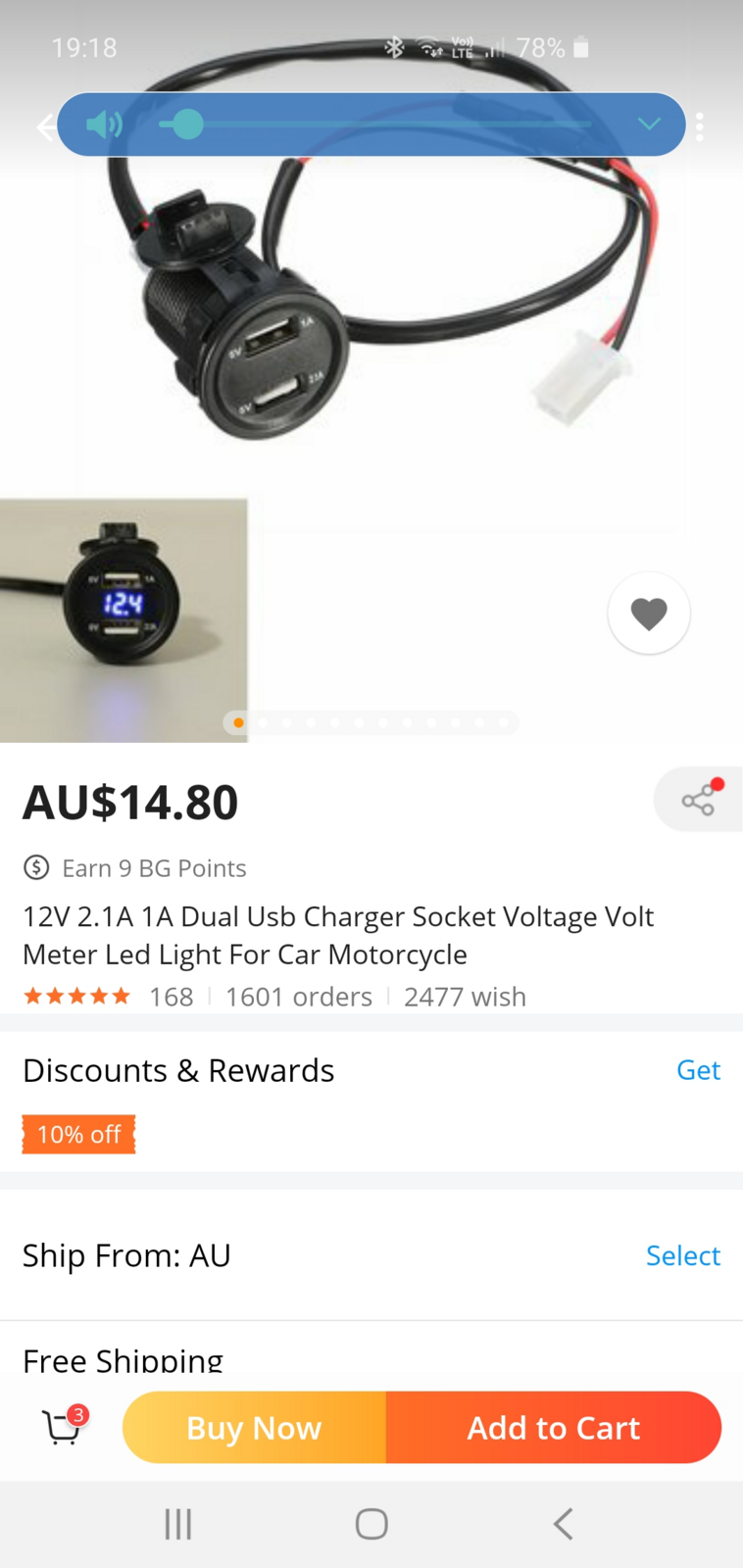

    I purchased the following on Banggood

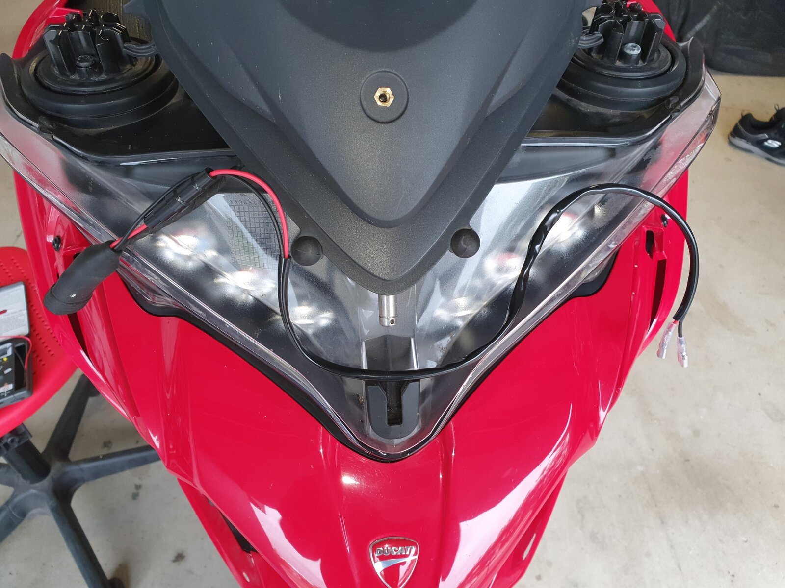

    The supplied wiring is just the perfect length to join it up with the existing plug that pops into the back of the DIN socket. (i unpinned the pins and soldered the lead onto the back and then re-pinned the plug). Hole size 29mm
    Easy peazy install.

  5. Looks neat and I like the volt meter. Useful if you run your phone as a sat nav.
