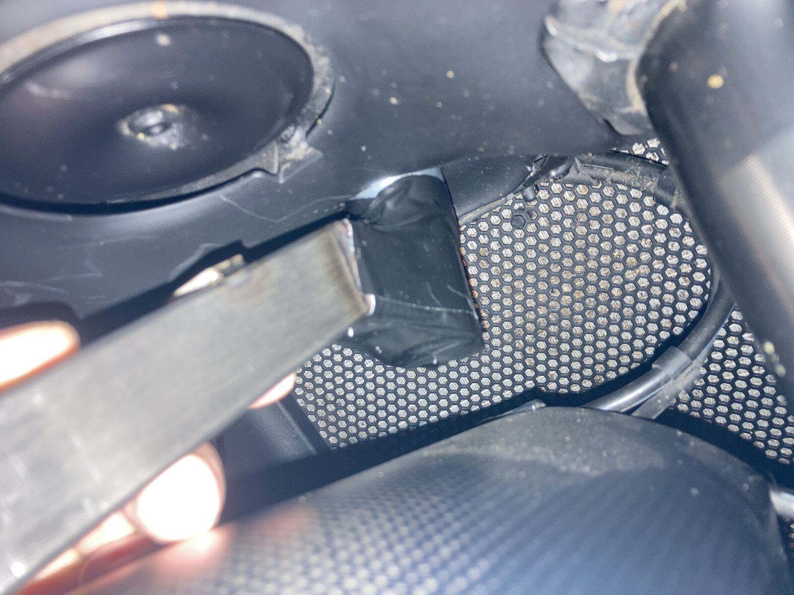

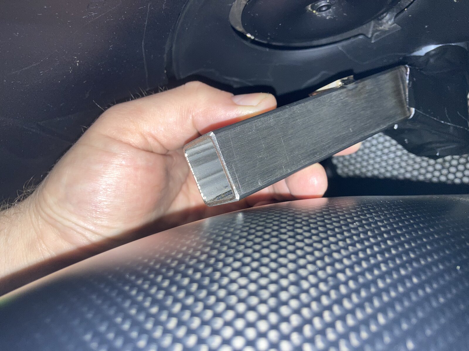

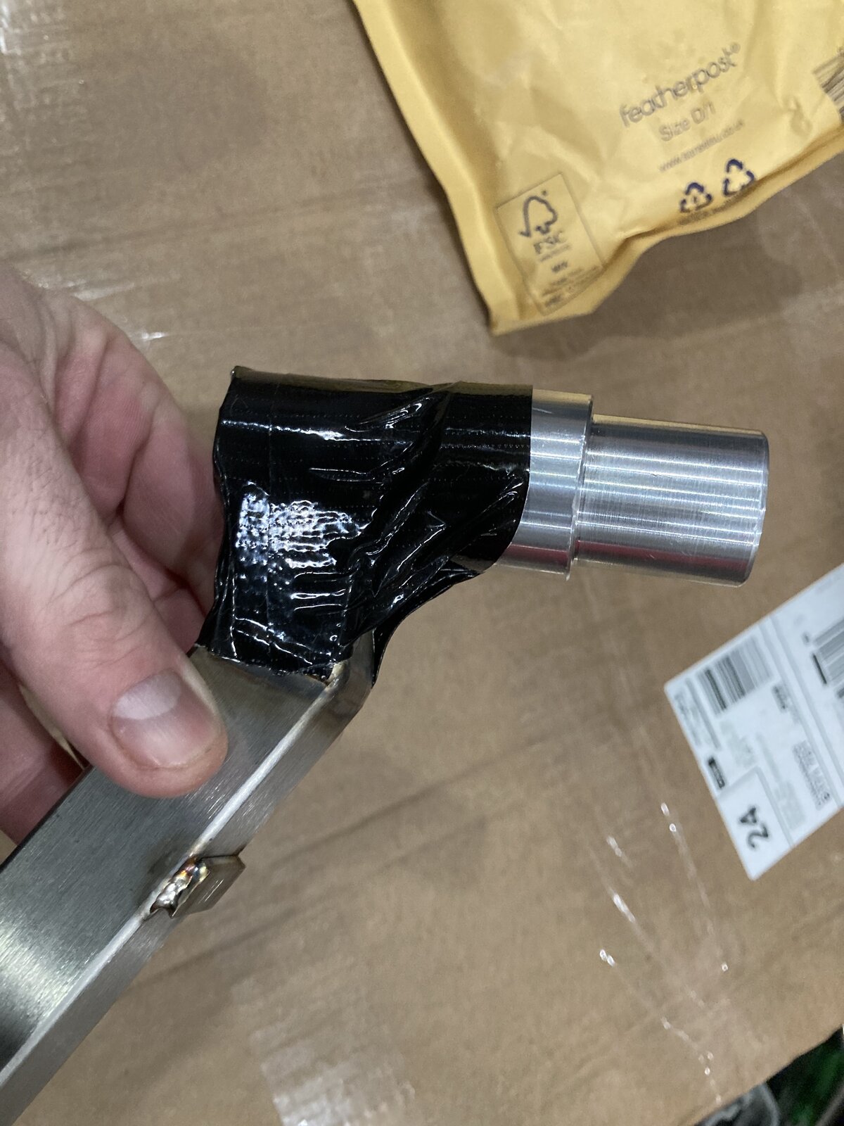

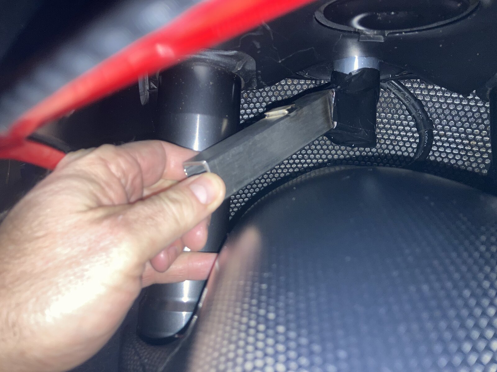

    I bought a stand but it’s far from functional!, in fairness they said someone only told them it worked on theirs & no bike has been in for fitment yet, they’ve taken mine back & credited me.
    The pin & bracket are just too tall to fit so they needed turned 90 degrees to position the pin, when the pin is located fully the bracket needs turned to the centre of the fender but has only 1-2mm if clearance do the main stand can’t attach to it.
    Back to the drawing board it is, when they properly fit a bike I’ll be buying one then
