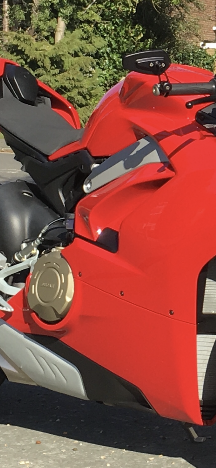

  2. I had the original bar end milled down to take a CRG bar end mirror when I had a V4s. The CRG mirror was much better than standard with clear rear view vision at all revs. I had FuturisMoto indicators on front which were pretty neat. DP on rear.
