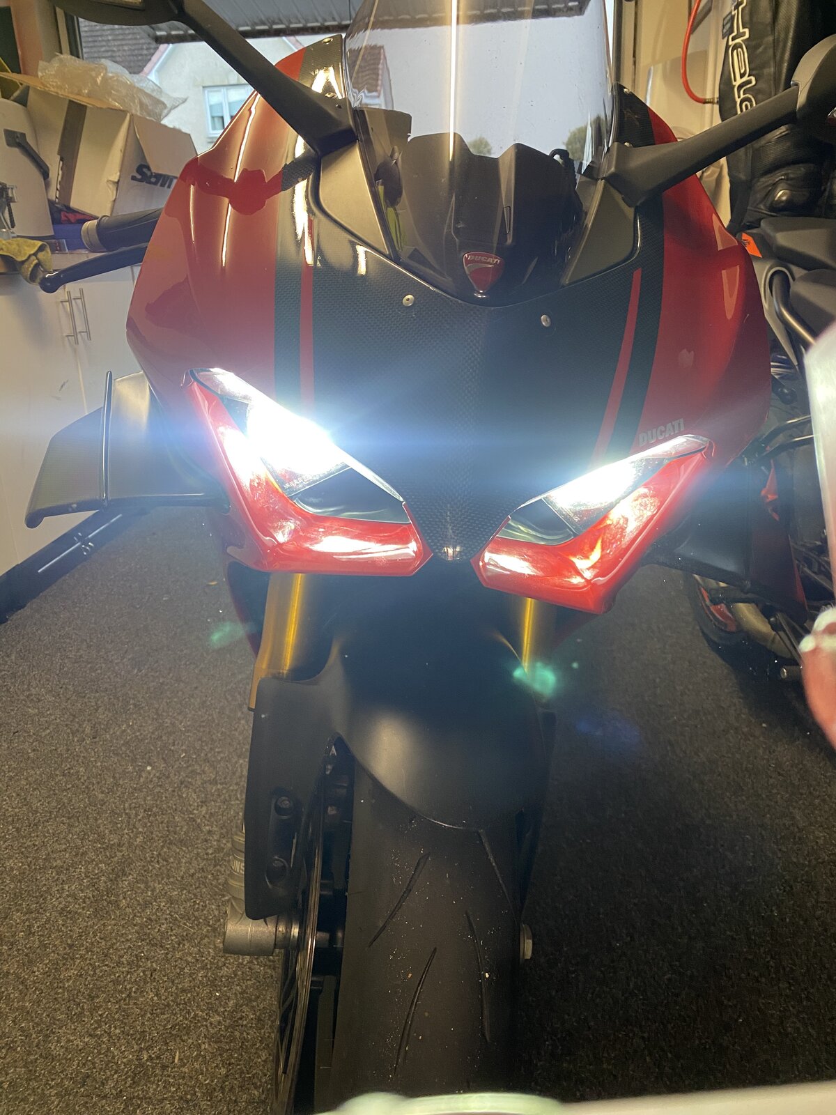

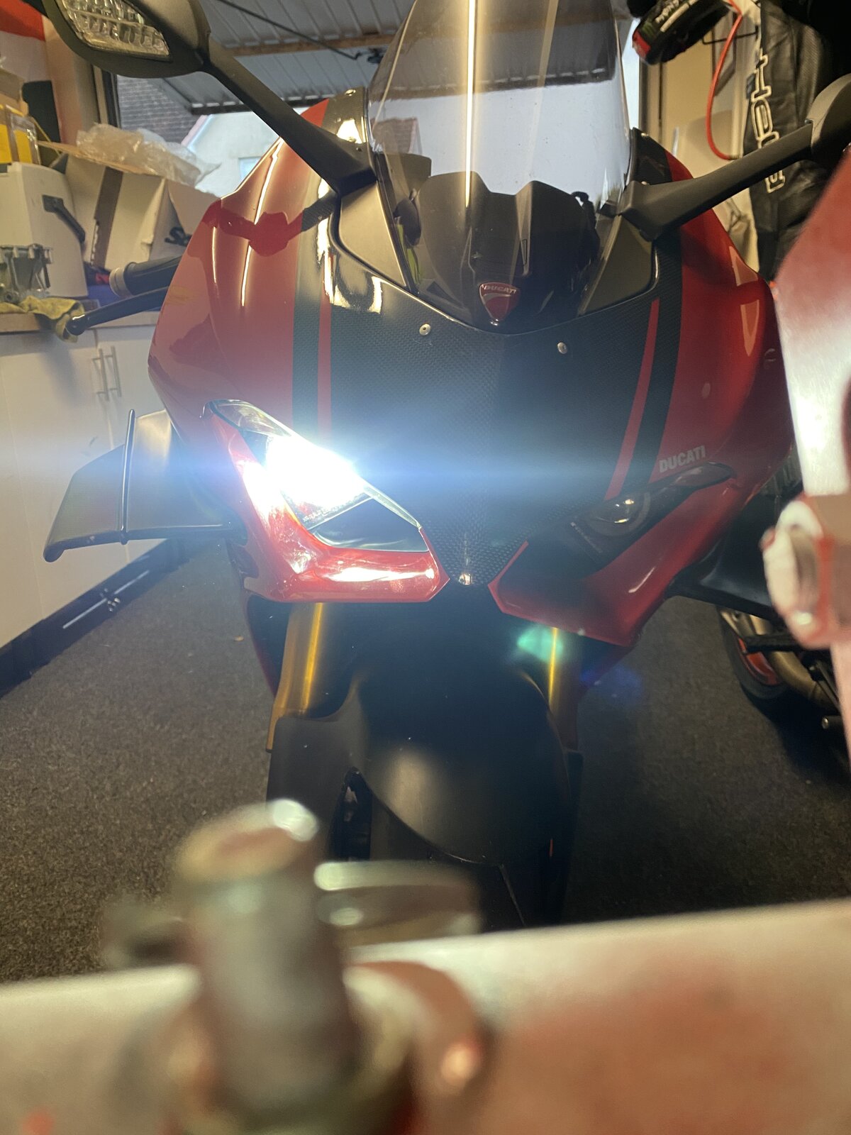

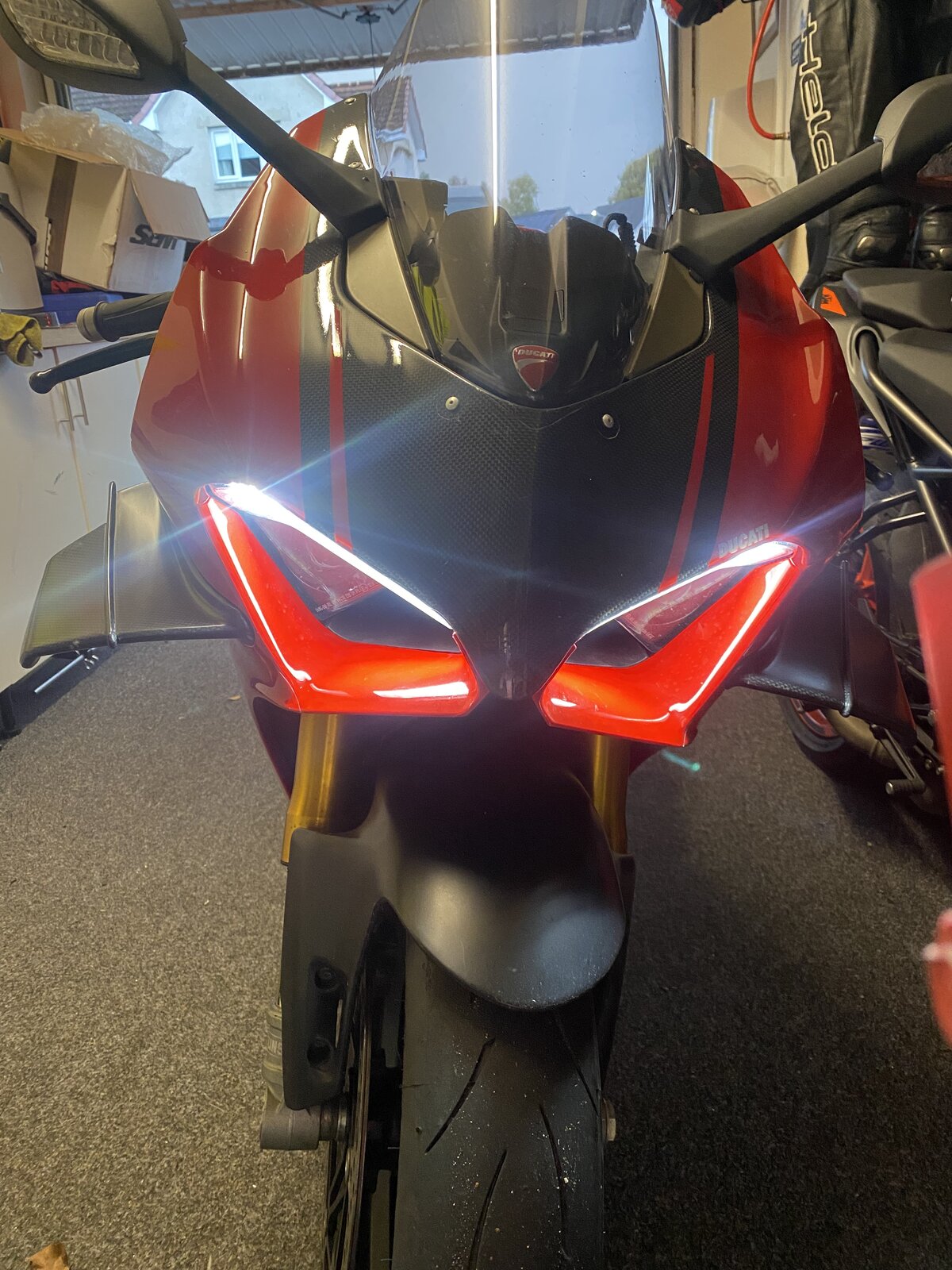

  1. Can anyone help me out with how the headlights are supposed to be on the V4. They don’t seem right to me but when I had the bike in at Glasgow for a service they checked and said that that’s how they illuminate.
    with only the ignition on, both "slits" side lights are illuminated
    When the bikes started, there’s only one headlight illuminated
    And then with the full beam, both are on

  3. I’m pretty sure both upper daylight running lights should be in regardless of which beams you have on
  4. On the 1299S led headlights… Both dlrs on on key on, both low beams on after the engine’s started.

  6. Thanks mate, I’ll give you a shout. Ducati checked against a new bike they had and they said it was supposed to be like that but I’ve seen pictures of bikes running and both side or running lights are on. Maybe there’s a setting I need to look at

  8. From your sequence of photographs, it looks like your DRL is set to auto. If the ambient light is low, the DRL is switched off and the low beam takes priority when the engine is running. In set up mode you can change from auto to manual so the low beam/ DRL swap over is controlled on the left hand switch gear. As my V4S is in the utility room, I can’t fire it up to check whether I have one or both lights on at low beam. Andy
