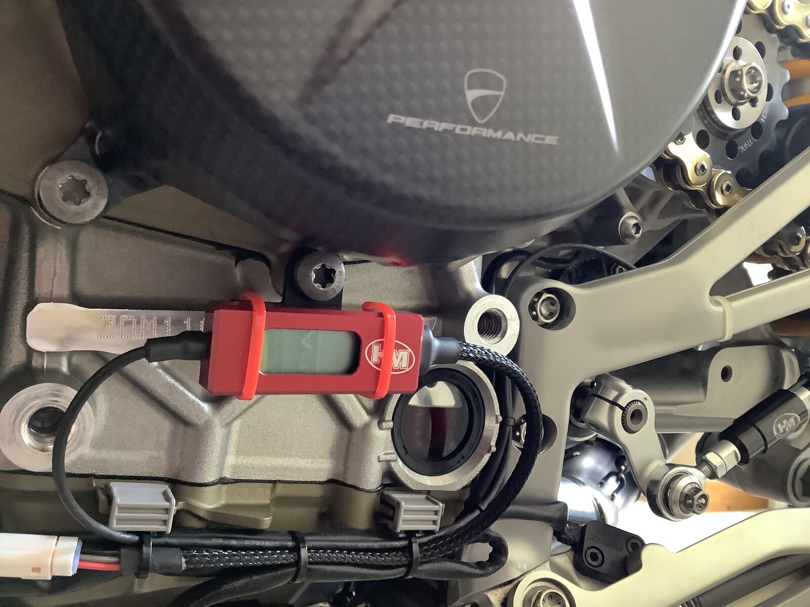

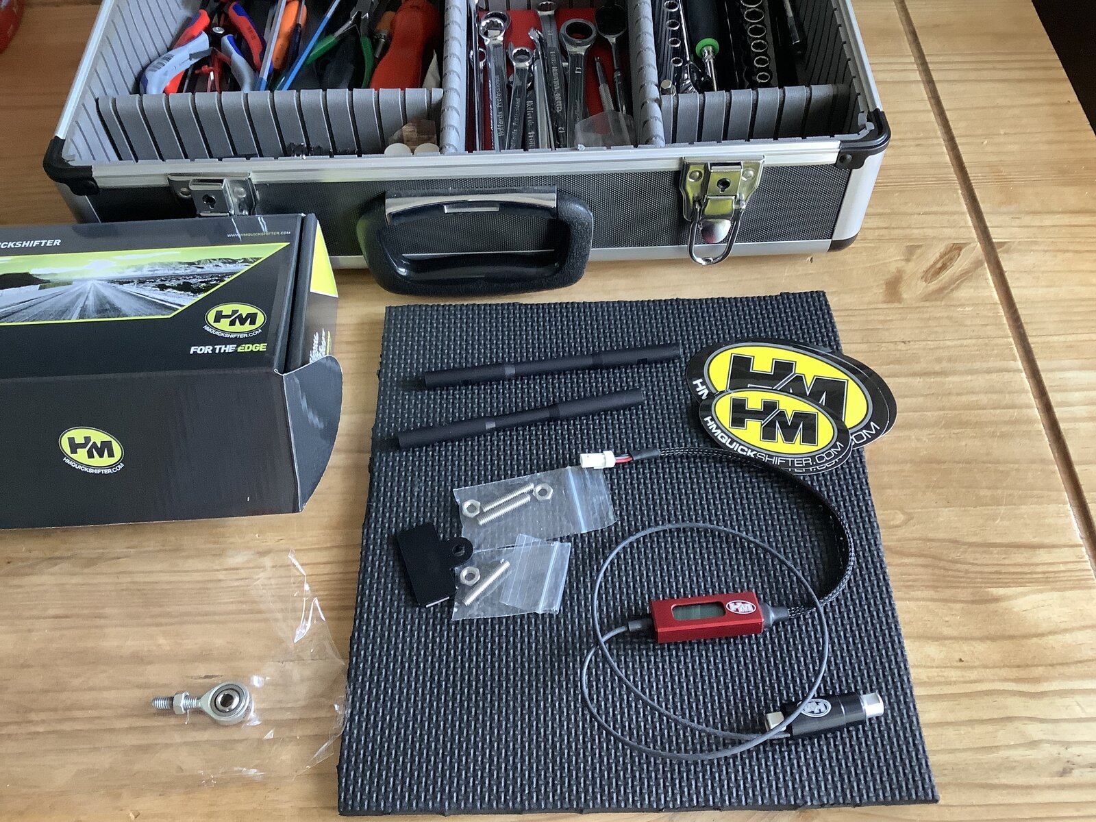

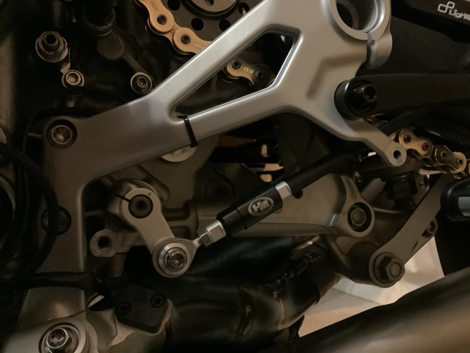

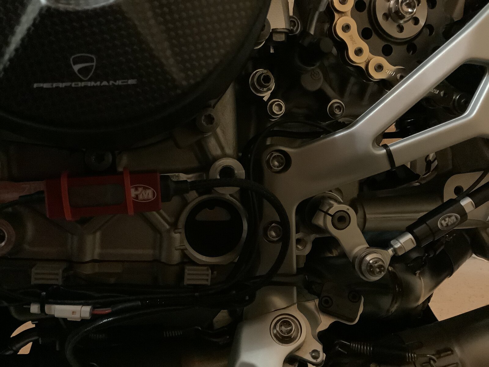

  1. Probably countless people having had issues including myself with no blipper I’ve opted for junking the unreliable OE unit for a HM unit. Also for a better feel! Adjustable for kill time so should make for a quicker more precise change. Anyone ordering one of these will need another rose joint to connect to the output shaft end. You can use the OE one that’s connected to the footrest end. I will be fitting over the weekend and post up some results :cool:

  3. I had a spare kicking around from another setup. Surprised they don’t supply one in the kit as your pretty stuffed without it. Obviously you can use the OE one from one end.

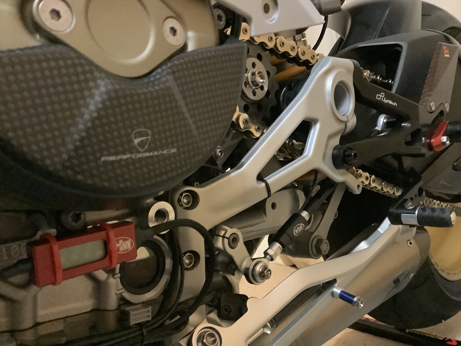

  4. Got it pretty much mocked up but think I will be moving the display as I don’t think the screen will be visible once the lower fairing section is installed. I also run the shifter with the cable exiting the rear and loping back around and following the same path as the OE unit. I’ve seen others routed the opposite way but don’t like the way the cable has to flex over a shorter distance potentially causing some resistance. Will try repositioning the display tomorrow if it’s not visible.

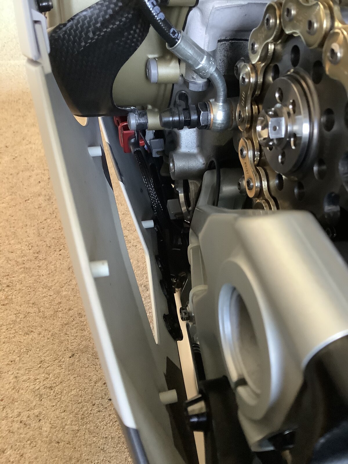

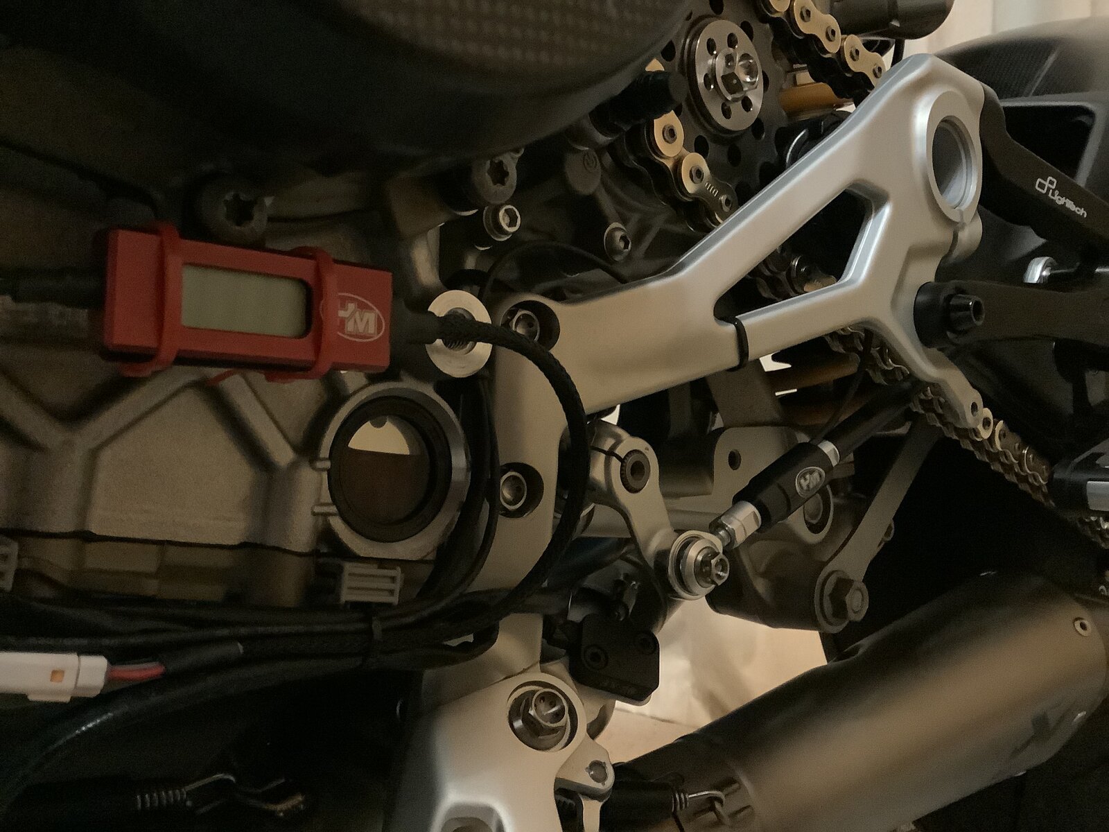

  5. Ok all finished up, just rerouted some other cables. The Red display unit can sit in that position and you can just see enough of the screen via the opening in the lower fairing. Just ran a self calibration and then setup the sensitivity too 60, also changed the module From C too E operation. C being compression or push to change up gear or E being extension or pull to change up. Only disappointment is you can’t change the kill time! Pretty sure this is information sent via the ECU. I’m still thinking it will feel more positive without any moving parts from the OE shifter load cells:cool:

    Yipee I’ve got my Blipper back:D So obviously a OE quickshifter issue!
    Ok first thing first as i previous stated the unit needs to be in E mode for road shift, translating the setup options from the website this states for pull or extension for setting up for up changes. Looked and looked again as it’s definitely pulling when changing up as opposed to pushing! So popped out for some essential items and gave it ago! Nothing:( Shifter didn’t work in either direction;) So pulled over on quiet backroad and stuck it in C mode. Now works a treat in both directions:upyeah: up changes feel far more precise and crisp, Feels like far less delay than the OE unit! And blipper feels the same, down changes take less effort and even the blip feels more pronounced. I’ve still got the sensitivity set on 60 but might try going up in +5 increments till I find my sweet spot. It’s not far away. Out of the box it’s definitely a noticeable improvement over stock, plus hopefully will be far more reliable long term. It feels more predictable and consistent to. That’s put a smile on my face today:)
