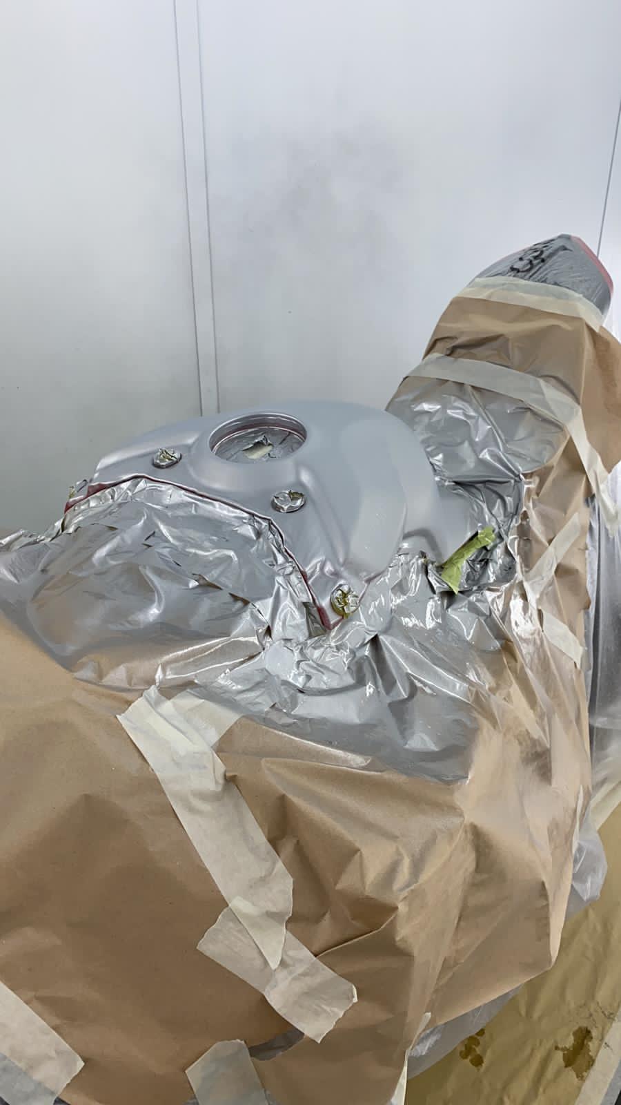

The paint job is taking a while… The company are going in to detail with the V4 SP spray job… Spraying the red bits , the white ducati decals and the tank silver… Hopefully done in by the week end . Here’s a picture of the tank…
They're painting it in situ on the bike? I've never seen that in all my years. So the underside of the tank will remain red? And what about the overspray, because no matter how much you mask some will get through?
I was warned about the over spray and told him. He assured me he would not get any over spray anywhere .
