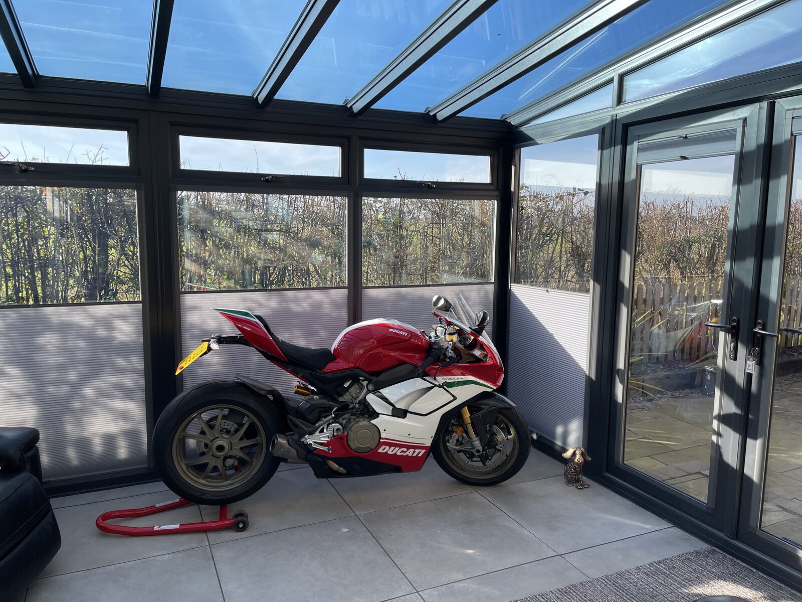

I like @Manicguitarist’s post and it is very informative. IME, my Panigale V4 has sat in my utility room between track days, connected to a good quality, lithium chemistry specific, battery maintainer. As I only did 1 trip to Spain last year, that’s currently 6 months between track days. The bike is now 3 years old and still on the original Skyrich battery which fires the bike first push of the button. Andy
