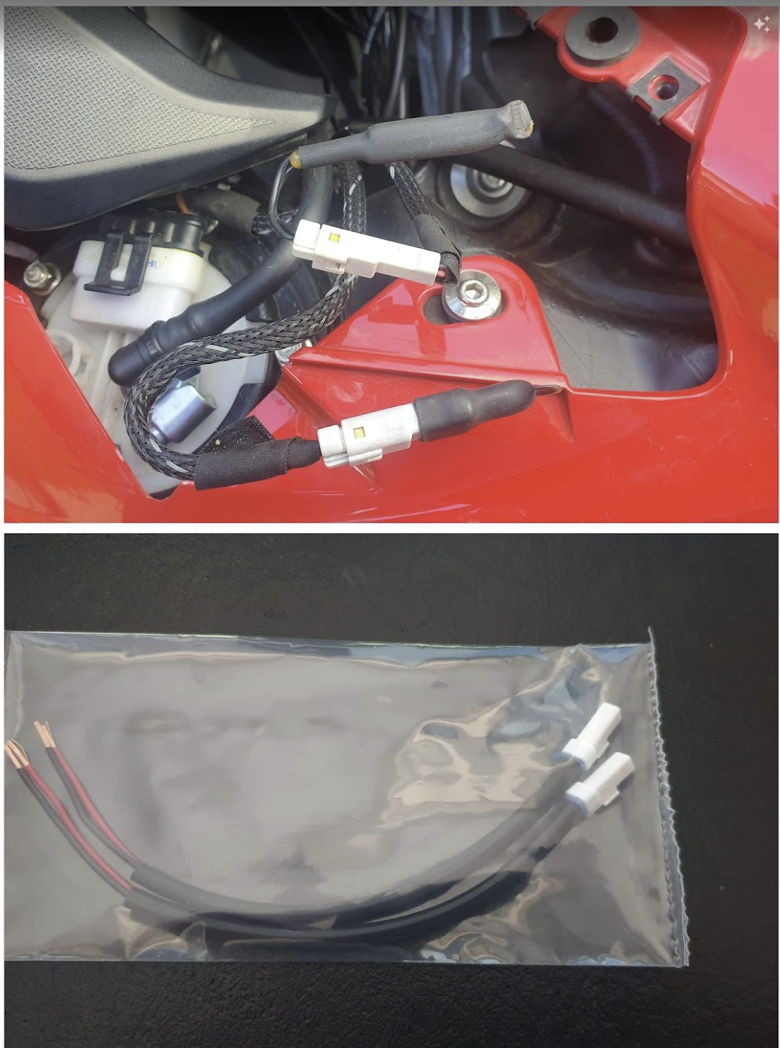

    I am picking up my new V4S full next Friday and the first job will be wiring the GARMIN XT in. Can somebody tell me where is the Aux wiring for the V4S? Plus will I need a connector from Ducati to connect into a multi plug?
    Thanks in advance.....
    Keith
  2. The connector is marked NAV ready to connect to the XT. Very easy after watching a demo on Youtube
    • Lock Thread Lock Thread x 1
  3. The Nav connector is under the cover with the Hella 12V socket (right-hand side of the display). It has a plug with pig tails which you remove to connect to the sat nav wiring. There is enough room under the cover to lose the power converter block and excess cable of the Garmin XT power loom.
  4. Put the pig tails in hot water for a few minutes and you can pull the rubber covers off
  5. Hi there.......... If you check out You Tube and a guy who uses the name "Ducati Time" ..... there's a very good video showing how he wired in his Tom Tom 550 ...... it shows in the video exactly where the wiring connector is and what you'll need to do :upyeah:
