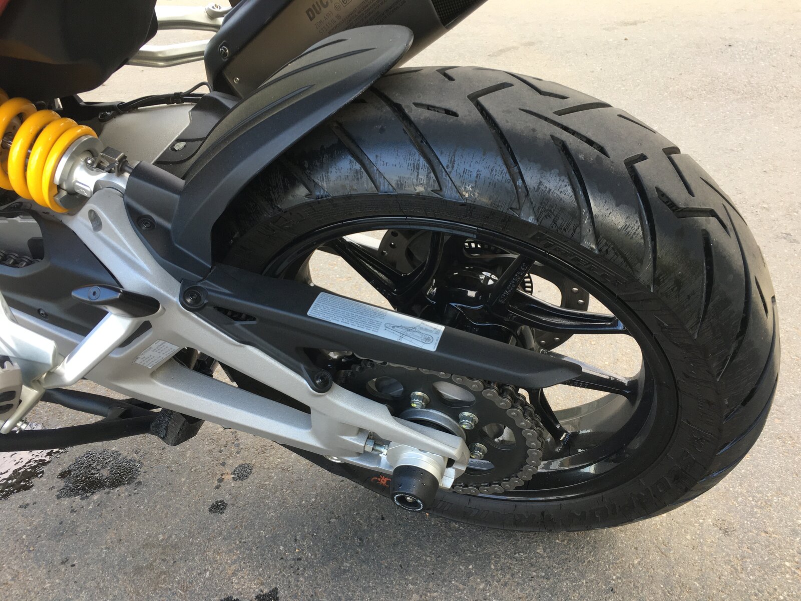

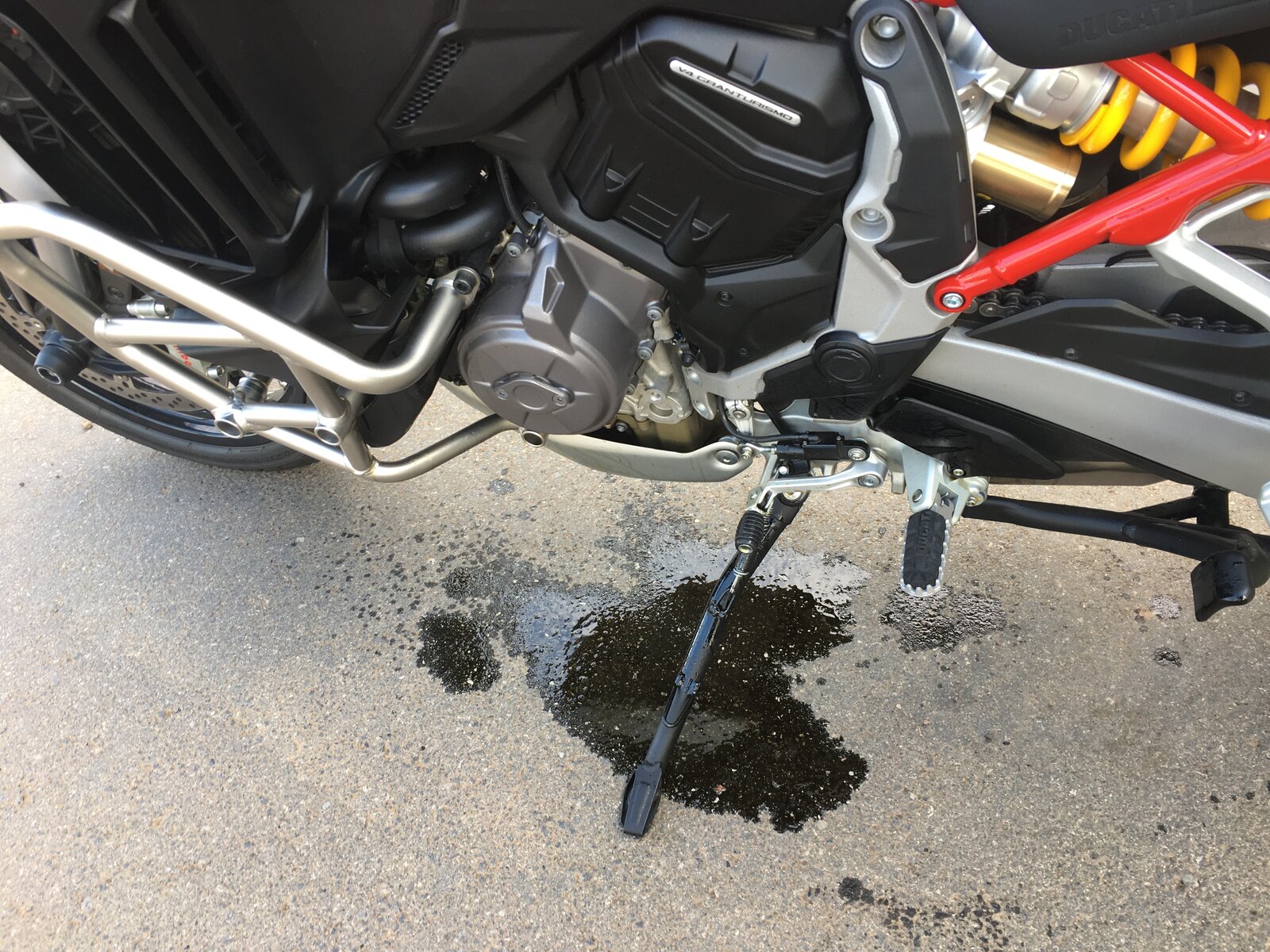

  1. My 2021 MTS V4S with 3k on the clock decided to dump its oil while I was out riding on Friday evening, covering the bike, rear tyre and me in hot engine oil. I was lucky to stay upright when it happened! Ducati Roadside recovery a complete and utter joke. No answer after listening to 40 minutes of recorded music so gave up and got a friend to recover me home. Managed to get hold of them the following day after an equally long wait and got the bike taken to supplying dealer. As it's the weekend I have to wait for them to contact Ducati on Monday to sort out repairs.

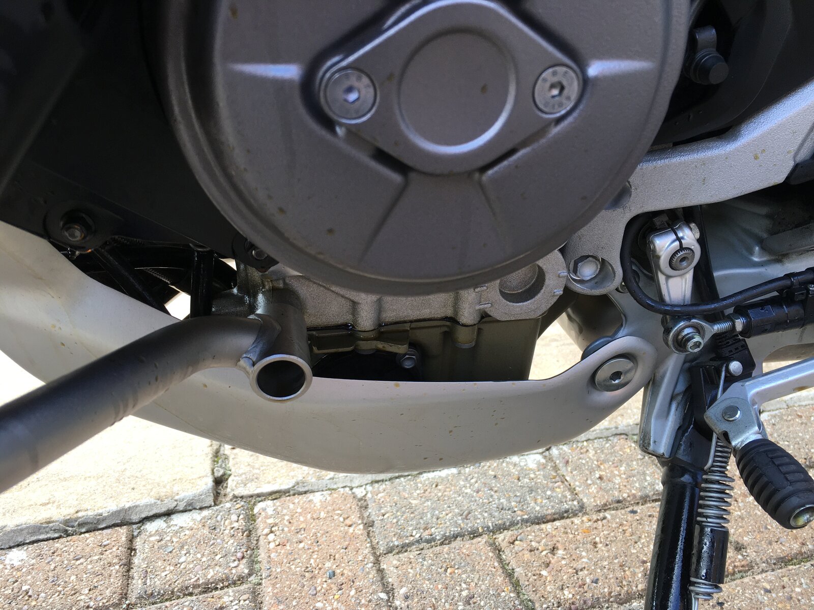

    Absolutely no idea where the oil leak originated as it was splattered all over the engine even the headers so will have to wait for the diagnosis. Could be rocker cover, could be sump pan?

    Do you think they should also replace the oil contaminated rear tyre as well?

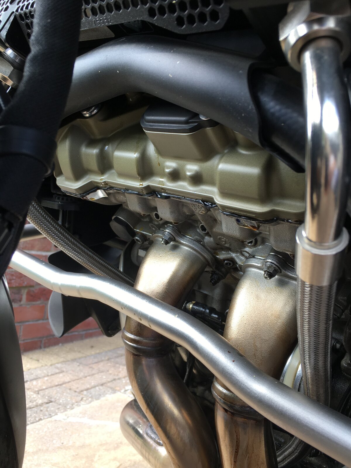

  2. Hard to determine where the leak emanates from judging by your pictures and the airflow over the engine potentially disguising the source of the leak. I would have thought, if it were from the cam covers it would have been a weep as opposed to a steady stream of oil, which from the pool on the floor, suggests so. Hope you get it sorted and yes I think you do have a case for a replacement rear tyre.
  3. It’s under warranty, I’d expect the tyre to be replaced.
  4. That cam cover gasket doesn't look right :astonished: has it been apart before?
  5. I thought the same, surely it didn’t come like that from factory.
  6. Bike brand new to me zero miles and never been apart so must have left the factory like that!

  14. talked to several owners with rocker cover seal leak soon after purchase from new, but oil witness above this seal/on the rocker cover, might mean leak is higher than this.
