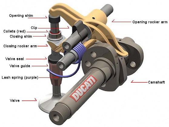

  7. So much to remove lol
    Anyhoo, only checked the vertical as was getting bloody cold :D got all weekend
    Opening shims
    Exhaust 0.045
    Exhaust 0.06
    Inlet 0.13
    inlet 0.13
    Closing shims
    exhaust 0.19
    exhaust 0.18
    Intake 0.08
    Intake 0.13
    Looks like i got some adjusting to do :(

  8. Do these not wear tighter with use?
  9. My understanding is the valves and seats will on average, over time, tend to wear. That is, closers will gain clearance, and openers will lose clearance
    bike has 8k on it
    you read they need adjustment on the first service then rarely after
    Then you read they dont need adjustment untill at least 15k
    Depends on how the bikes been treated i suppose
    #9 BB1000, Feb 13, 2016
  10. I had to do the exhaust closers on the horizontal; the rest were ok. I did mine at 9k.
  11. Looks like i need bigger exhaust openers on both vertical and horizontal cylinders and one smaller exhaust closer on the horizontal. .. no where seems to sell them online ... well i cant find anywhere that is.
  12. Are you able to swap any around. They sand down easily if you need them smaller.
  13. More than likely. ... and i hope, i have measured both cylinders now with belts removed, next step is to take all apart and measure the shims, still waiting for the tool in the post, should have got it last week :(
    Will do the closers first then go from there
    No rush though, weather's cold n crap lol
  14. Ah ... i been reading to do the closers first .... can't do anything until the shim measuring tool turns up anyway.
  15. You are right, closers first; mixed up.....
  16. Last winter i did a full rebuild on my 996 all my shims needed changing. I was lucky that i only needed to obtain two replacements, all the others were sorted out by swapping and grinding down to wize. My dealer is very good with regard Shims, as he just does a straight swap if i take the others in. But yes i take my micrometer with me to double check.
    So my advice would be to work out what you need and then chat to your dealer and see what arrangement they have for exchange.

  18. Managed to get these results, god its a pain to do lol
    Vertical
    intake opener left 0.11
    intake opener right 0.11
    Intake closer left 0.075
    Intake closer right 0.08
    Exhaust opener left 0.11
    exhaust opner right 0.11
    exhaust closer left 0.10
    exhaust closer right 0.08
    Horizontal virtually identical .... openers are easy to make upto 0.13 ... would the closers be ok at these specs? Going by ducati they would .... had the cams out a LOT lol
  19. Wow that is good ... will try but may need me buying more shims lol ... still cold n crap so no rush
    Thanks
  20. All day in the garage again .... this taking forever lol ... im sure a dealer would just change a shim to within adjustment specs, i on the other hand need all just right ... damn OCD :D
