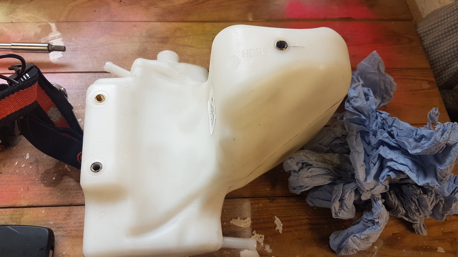

  12. Ok update time new expansion tank purchased from moto rapido £42 diy fit 2.5 hrs.
    found slight split in original tank by nut socket causing leak.

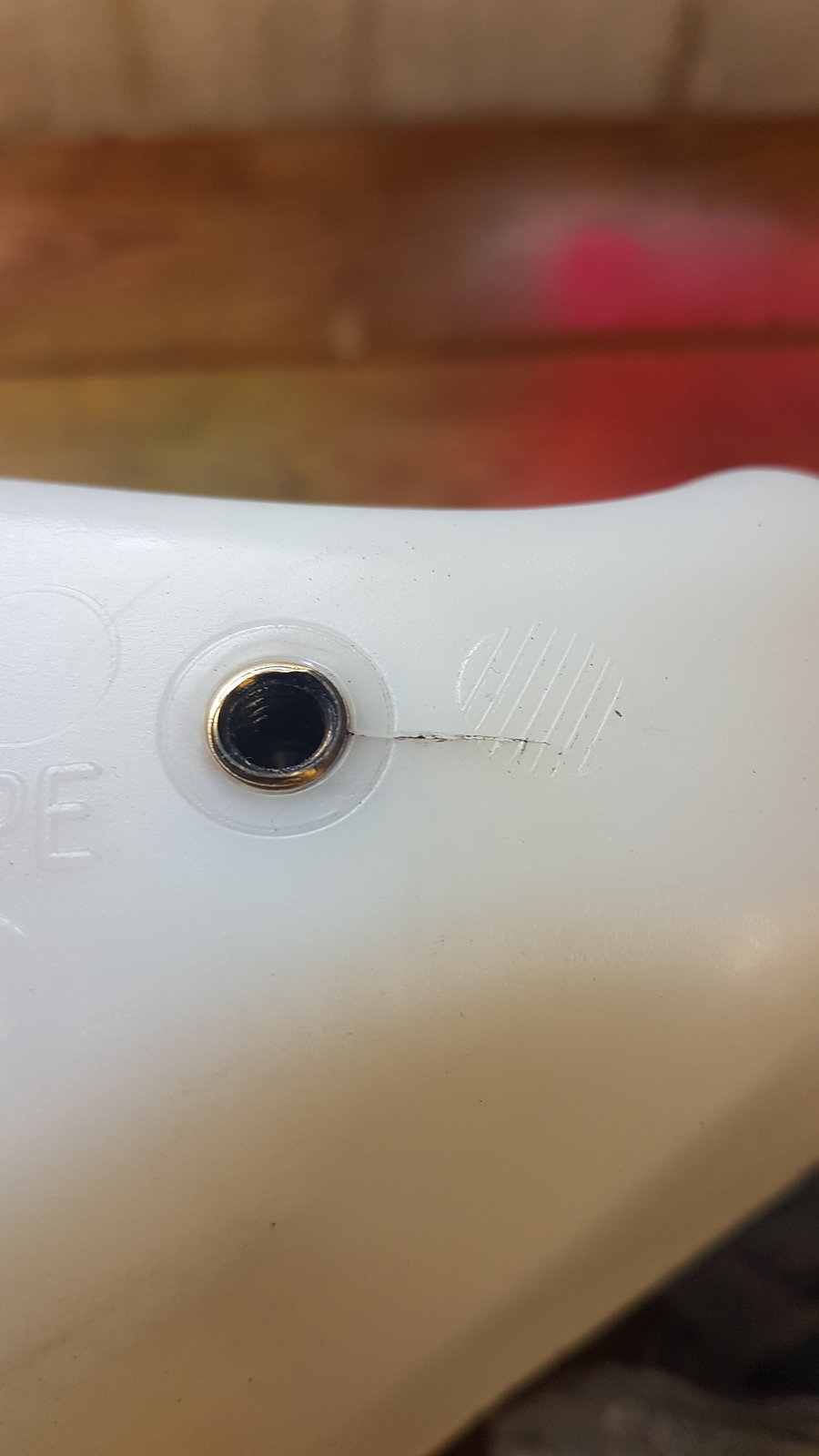

  15. Looks like the tank on my 65 plate dvt has done the same thing as my 2010 bike hopefully warranty will talk to moto today
  16. ok another update for the 2015 (65 plate DVT).
    I called ducati and they may have done goodwill on the part but not the labour and as the coolant tank is only £45 I orderd one as a precautionary measure.

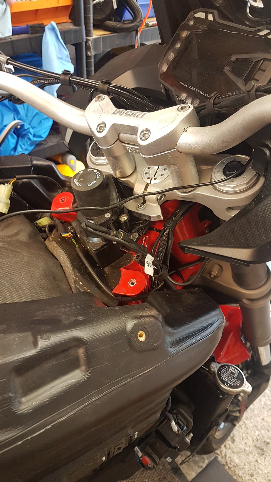

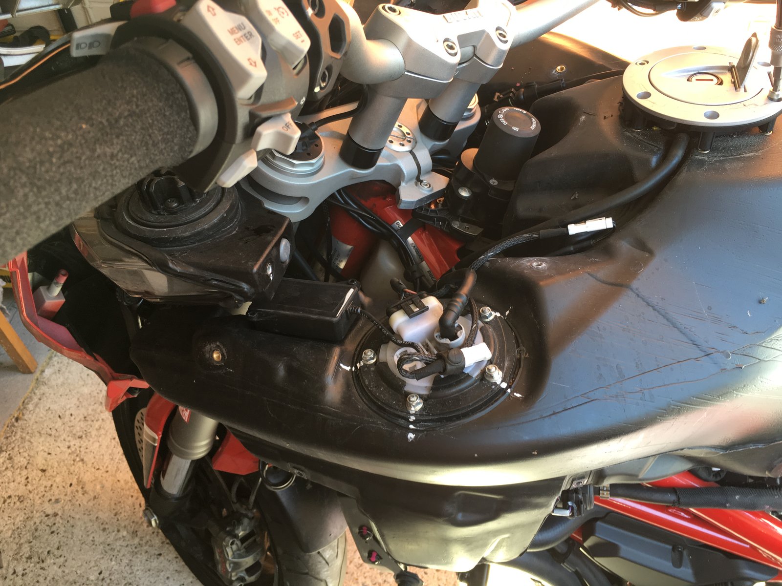

    got home from work and after just under an hour I had the tank cowlings off and had shifted the petrol tank out the way and drained the coolant expansion tank then removed it.
    and looking me in the face was a small split on the rear most bolt insert on the tank, checked it with some low pressure compressed air and it weeps alright.
    confirmed the part number of the one I had removed with moto rapido so I had orderd the correct part, I have some pics on my phone which (if I can) ill post later.
  17. stripped my one down and removed the coolant tank in just under an hour all you need is 3mm 4mm and 5mm allen keys first time I've taken the fairing off as well so I suspect it will go back on quicker.

  20. The coolant tanks are a weak point. Yep, another weak point! But at least they just seep a tiny amount and it would most likely never get worse or cause a problem. But! Why do they have these most basic issues on a top shelf machine? Both my monster and my multi have splits by the mounting nuts. People I have spoken to in oz are on their third tank! Jap bikes dont seem to have this issue...
    However, when you remount the new tank, you should do this to help stop it from reoccuring... use some silicon to mount a fibre washer over each of the three brass nuts with a tight fit to the mounting bolts and put more silicon on the other side of the washers so they are sandwiched in silicon when you tighten up the bolts. Do not tighten the bolts too hard and use lots of pink loctite.( the lowest strength)
