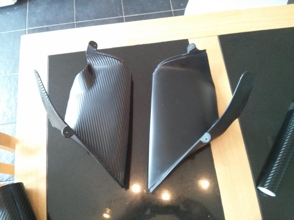

  4. I've been at it again!
    I originally wanted to get the vinyl wrap to cover the rad vent panels in the fairing as the black plastic was looking a bit sorry itself.
    So, here's one covered, next to the plain one.
    Again, it wasn't tough and the results are pretty good.

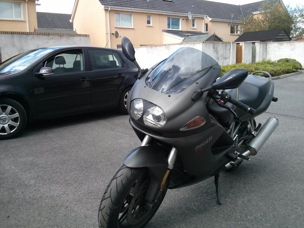

    Here's the bike with the panels fitted:
    And here's a better shot of the headlight cover based loosely on the comfort pack fairing option:
