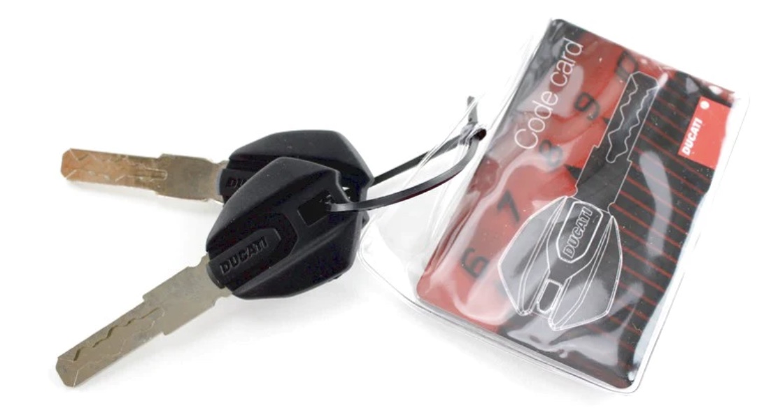

  1. This is a follow on to the research I have done into bikes with the I2K immo system and the calculation of bypass codes. A recent assist has identified that all I2K immo systems are not equal. In particular, for bikes using the MAE Electronics dash and Temic 12 key transponders. I think I have identified how to do the calculation but at the moment it is just desk theory. What I need is someone who has a 2009 /10 Streetfighter 1098 with both keys and the code card. I will not take any data from you. I will let you have some excel tools and send out a key transponder reader (which must be returned, I will reimburse postage). What I need to see is if the calculations I will guide you through give a result matching your code card. I do not need to know the code, just that the process works.
    This is the type of key I am interested in
    If you can help PM me
