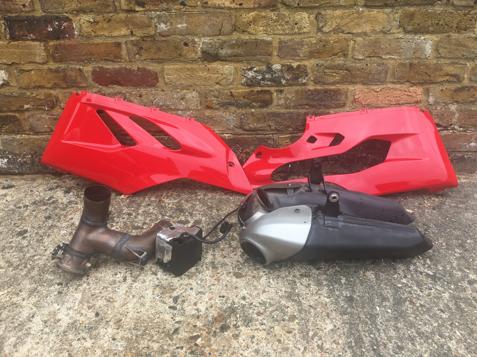

    Keep an eye out on eBay. They normally pop up for around £200 (full system), and will probably cost another £50 to ship and £40 in taxes/fees. Just remember to get the link pipe too (if you get a full system it will have this and the headers, but your headers are the same), because your link pipe won't reach. Obviously lower fairing panels too.

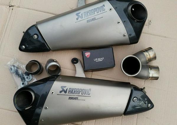

  9. Have a set of brand new in the box 899 cans if ur interested?
  10. Do they fit straight onto my 959. Ducati Glasgow say they dont

  12. Go up this thread. The picture is what you need. More information here: http://ducatiforum.co.uk/threads/euro-4-exhaust-swap.43125/
    That auction has the under belly muffler/silencer and the y-connecting piece. They will fit straight onto your header pipes. In addition, you would need the fairing panels, and if you want to keep the flapper valve working you will need the 1299 servo (because it pulls down through the center of the belly instead of around the side), but you would be better just leaving the flapper actuation off and removing the error.
