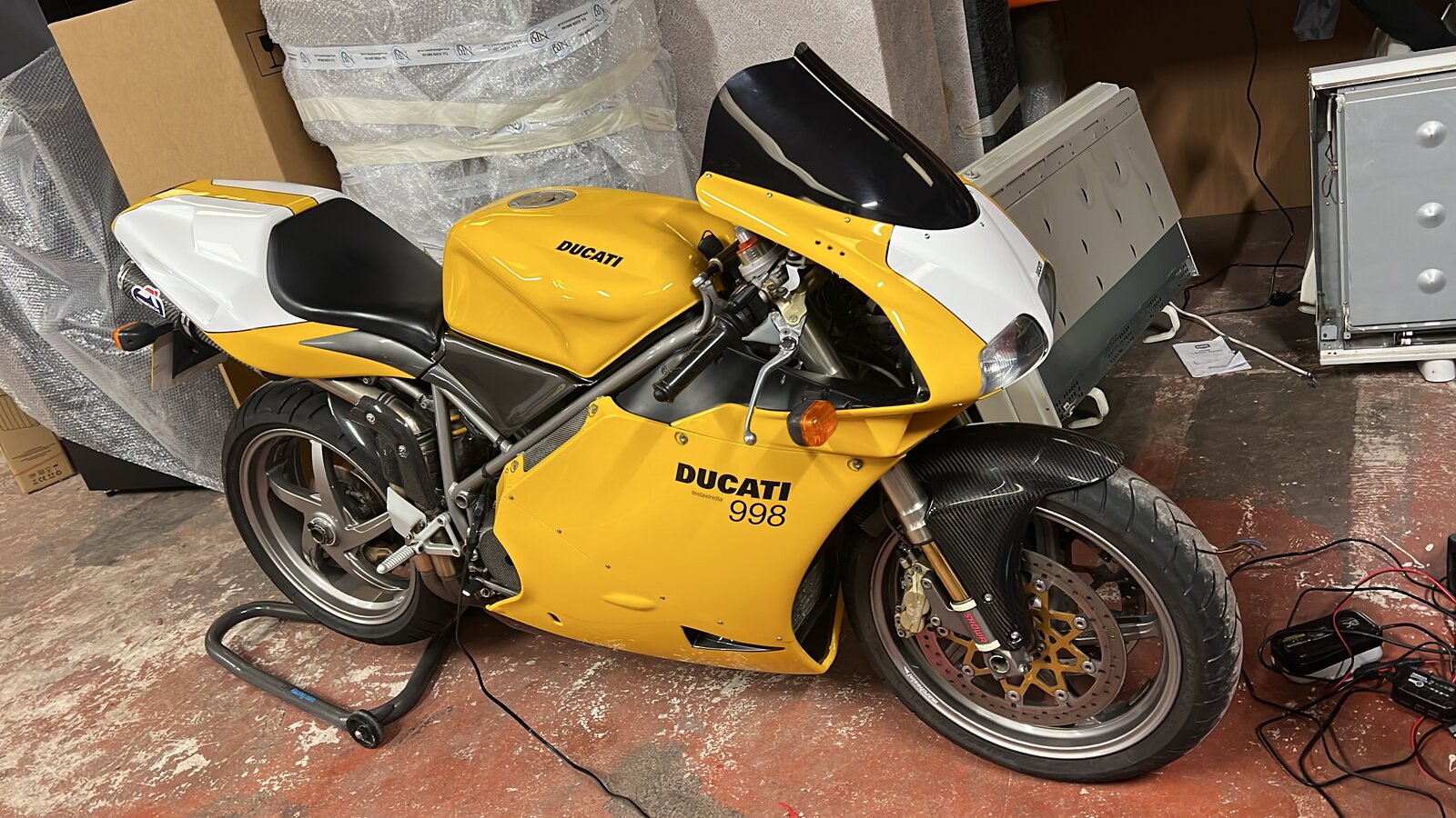

  1. Howdy
    My 2002 998 starts perfect cold. Leave a bit of choke on…ands it’s solid starter
    altough if I ride for any more than 5 mins, if I then try and start it…it never does nine times out of ten….
    battery’s good, real good. Tick over…
    Today I put some throttle on whilst attempting to warm start…and that helps.,,
    Any ideas what could be the issue?
