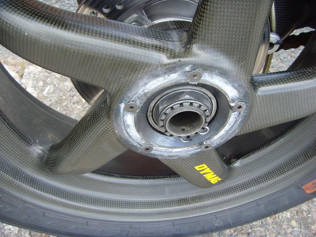

    Heres some pics I took at the roadside .

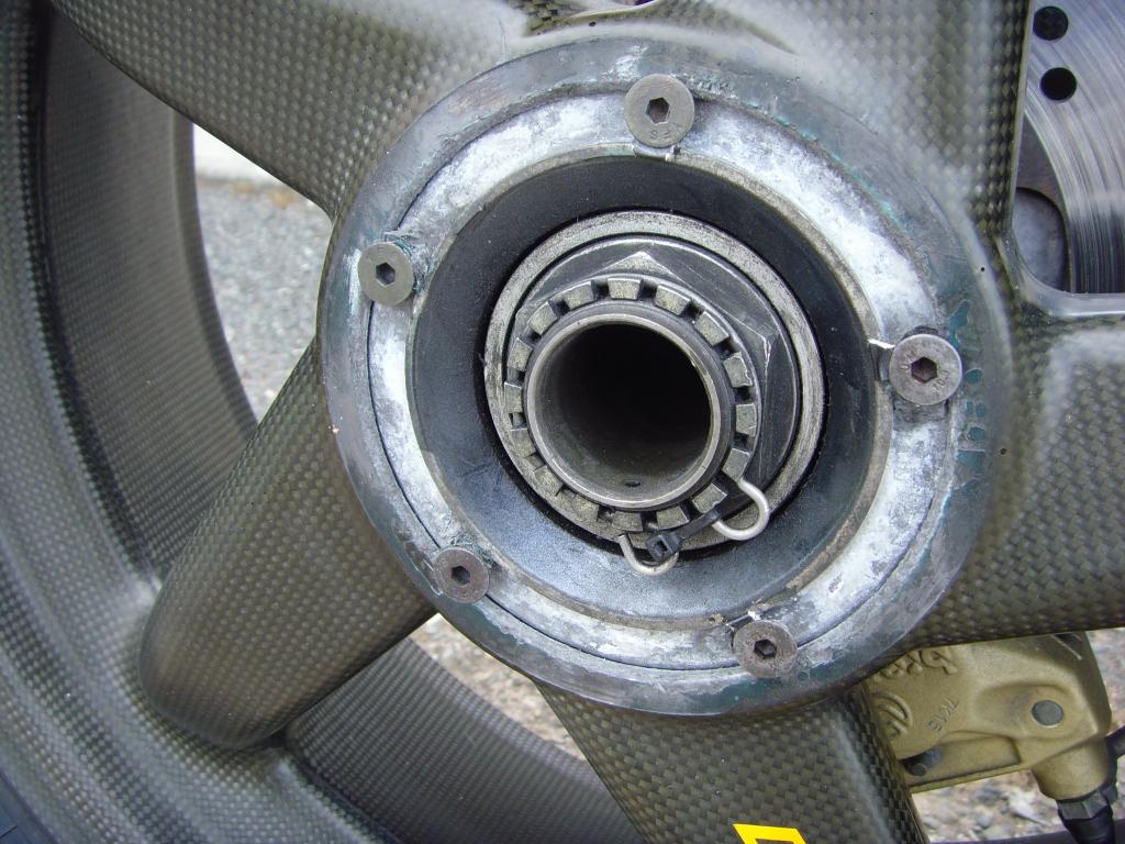

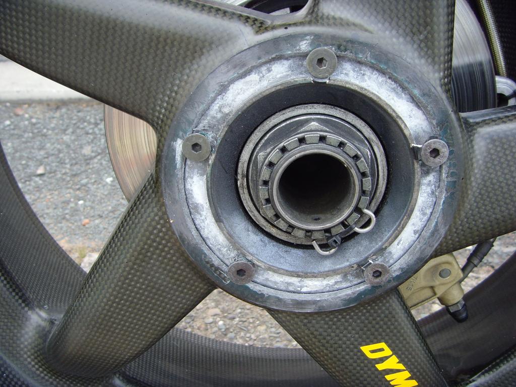

    Picture 1 - If you pull on wheel you can see the magnesium hub clearly behind the carbon part of wheel,next to rear brake disk.I guess bonding has failed between the two parts.

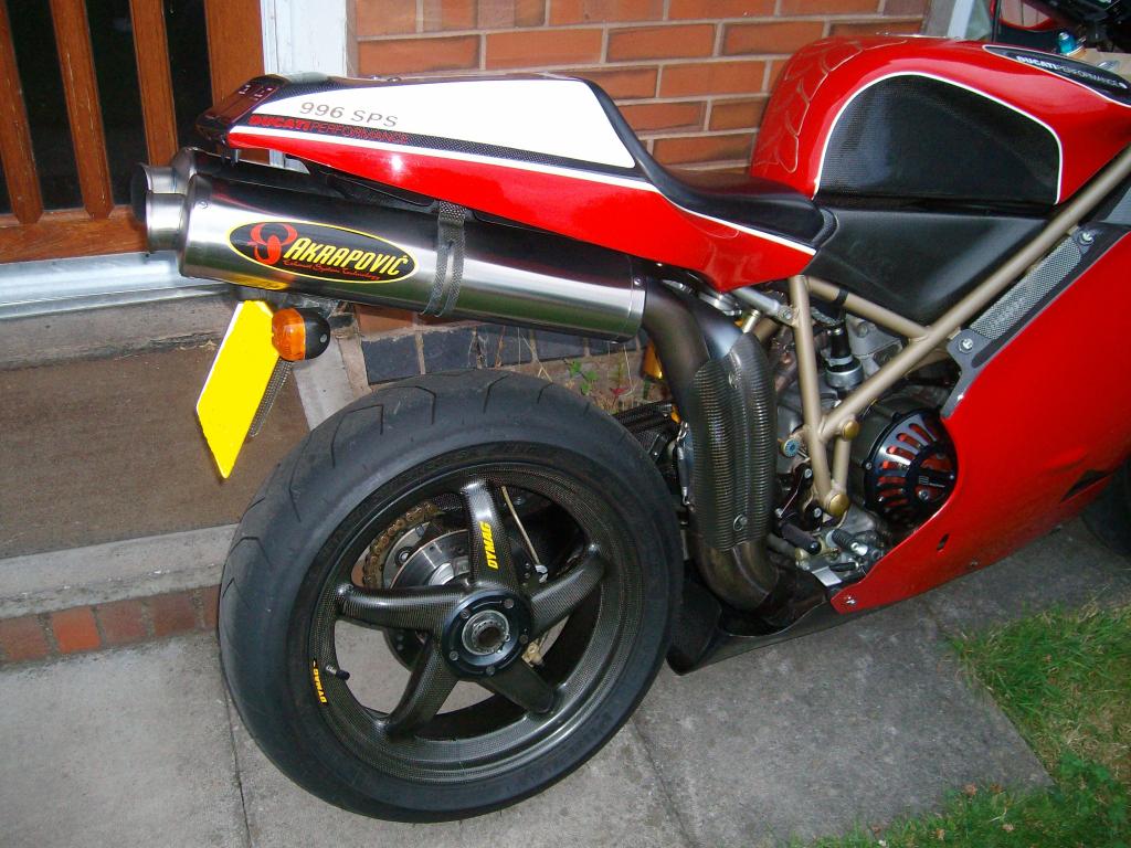

    Picture 2 & 3 Hub is loose from carbon part of wheel causing cover plate to shatter.Exposed cover plate bolts are the only thing holding it all together on the very edge of the carbon part of the wheel.

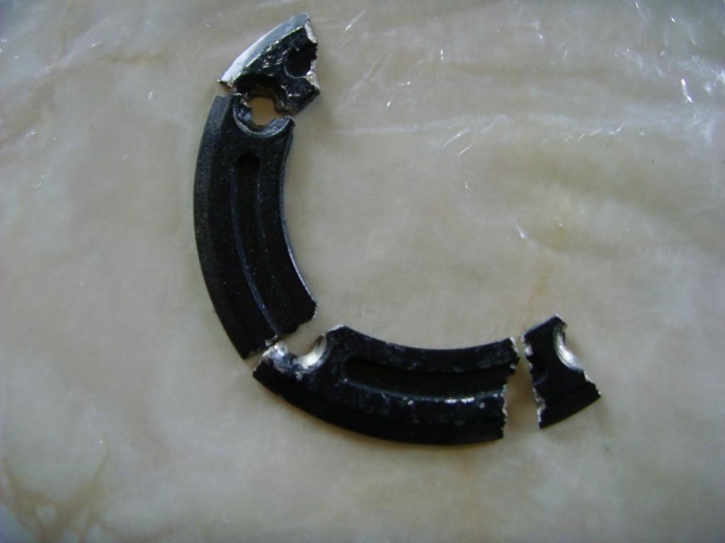

    Picture 4 - Bits of alloy hub cover plate I found at roadside in or whats left of it .
