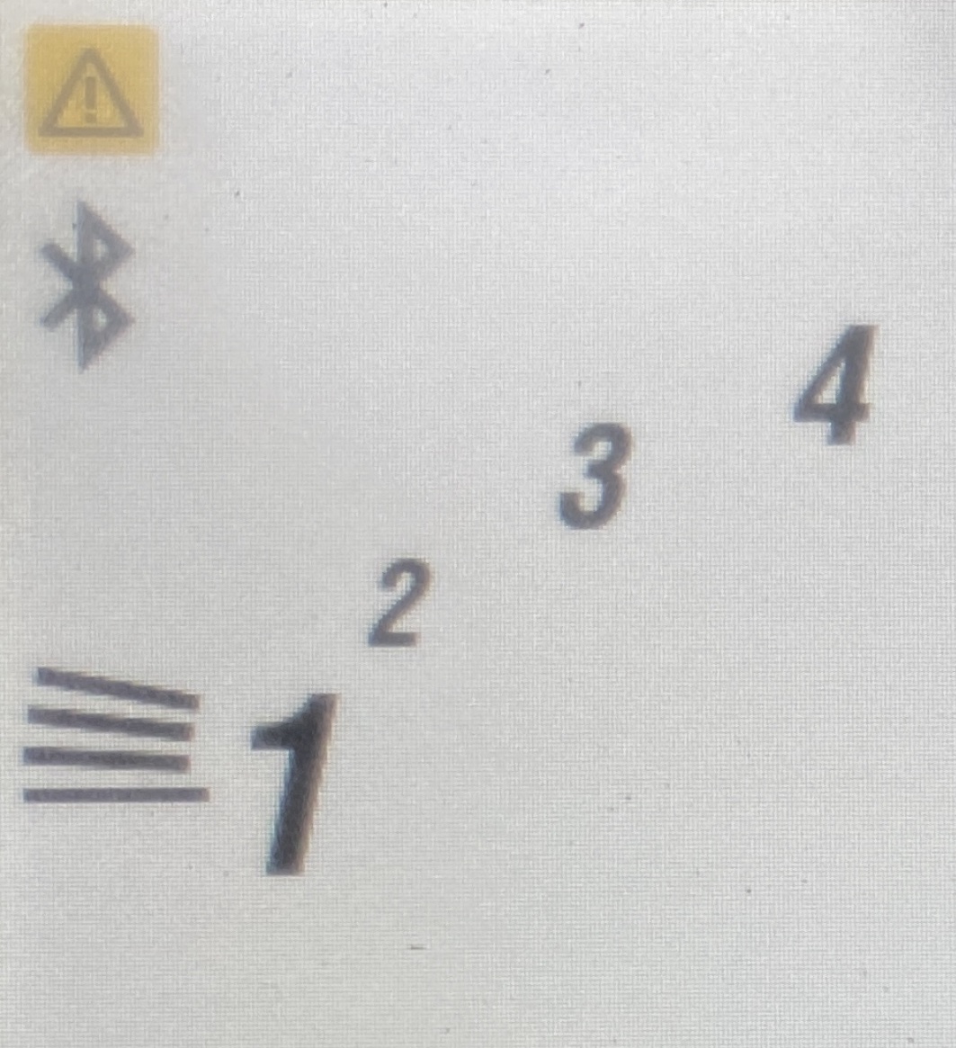

  1. I started my bike up today, first time in almost 6 months & I get a little yellow warning triangle in the top left corner of the screen
    I personally think it it coolant related as it comes on once the temp reaches 103, in the hand book it says this:
    Also the fan does not seem to be cutting in as it gets to 108 before I turn it off to stop it overheating

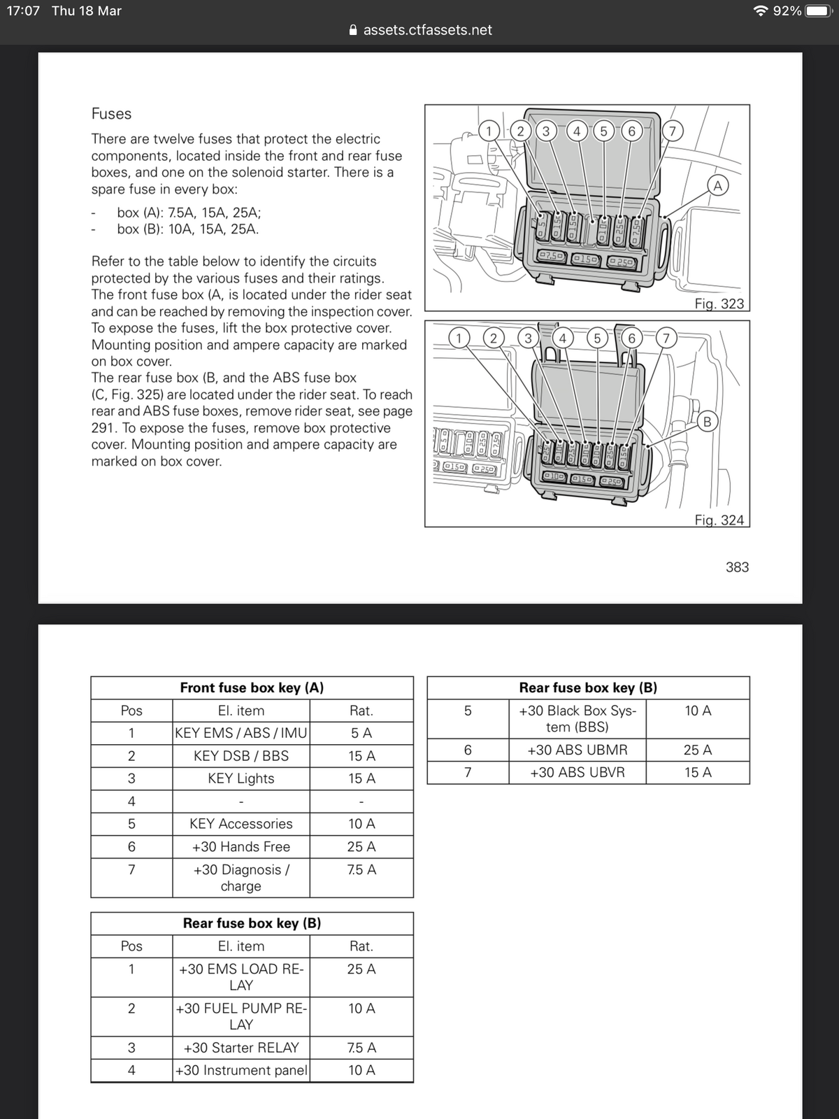

  2. Could also be a fuse, check those first. I once charged my phone from the bike, the dodgy charger popped the fuse and I got the same warning.

  5. The question is.......does the fan have a fuse, if so which is it

  7. Looks like fuse 5 in the box A

  11. This happened to me on the forum Ardennes trip with the warning triangle showing. Easy fix; change fuse and make note to plug in accessories before turning on ignition in future. It hasn't happened again.
  12. Ha! Thought it was just me, but this was my outcome. It seems the surge from a charger plugging in after the fact can cause the fuse to blow.
    I now carry a bunch of spare fuses under the seat as a result.
  13. Spoke to a dealer this morning the fans are on the BBS circuit which is fuse 5 in the Rear fuse box (B)
