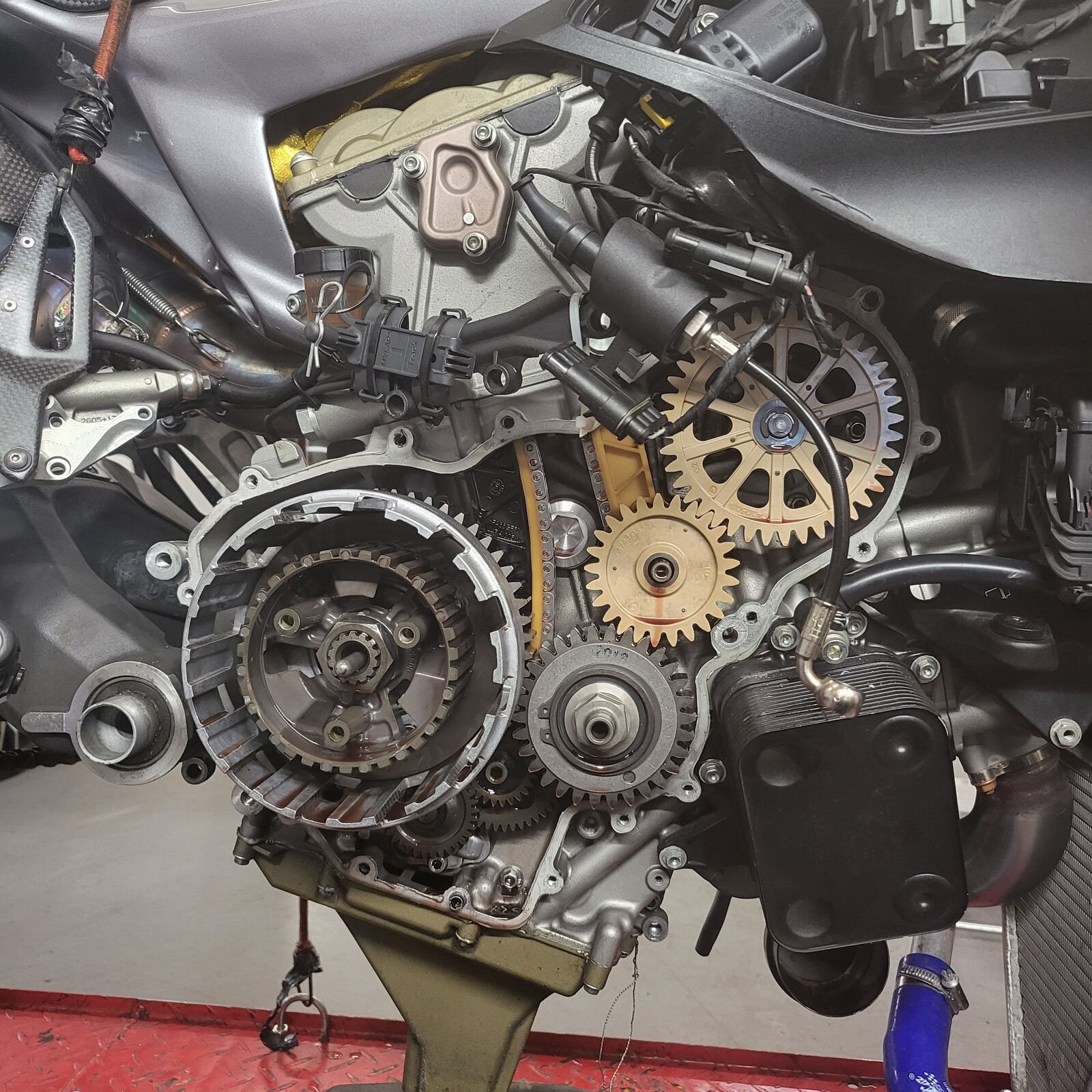

  10. Yes. It’s a picture of an 1199 casing, showing the water pump gears. And…?
    What is it intended to show me?
  11. Possibly that it is relatively easy to access, and you need to remove the bottom exhaust pipe to get the case off. You can also get an updated drain pipe from the leak off which goes into the fairing bottom.
    Or I just like the picture.
