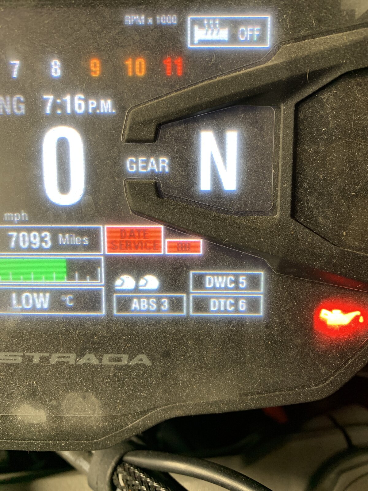

  1. Does anyone know what this dash light Means on my bike?
    The one next to date service
  2. Thats weird. Mine just presented the very same thing. I assume its saying it thinks its service time ?

  5. Think it's like a calender, indicating that a service is due because of a time scale rather than mileage.

  7. calendar
  8. Would rolling the date back a year sort this service display issue ?
    Edit: Well it did on mine, dunno if it will last though ?

  9. I had this, as others said it's the calendar service light (I thought it looked like a battery!)
