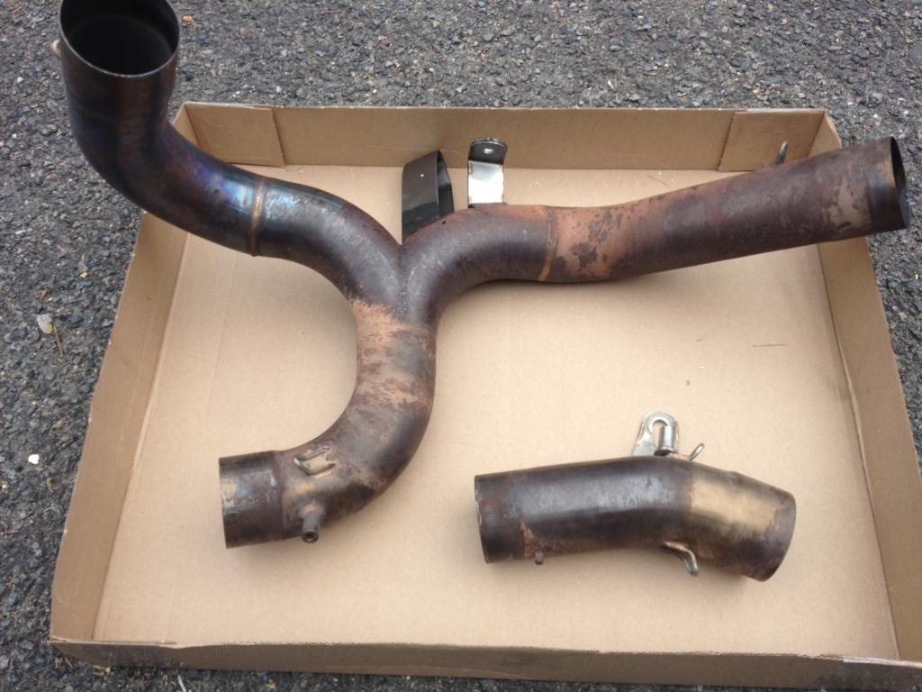

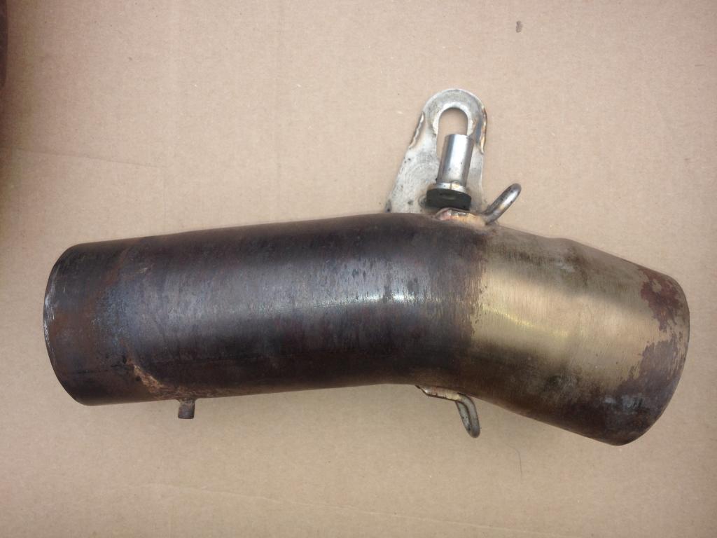

  13. I do have a photo.... This is the "link pipe".
  14. david thanks for the link pic but didnt get the one all together. cheers budha
  15. No...it won't upload from my phone... :-/
    technology...pah!
  16. Try this... the link pipe is the small bit, and fits onto the decat pipe (bottom left hand corner of the picture).
  17. Top man the link to the link worked. Cheers.:upyeah:
