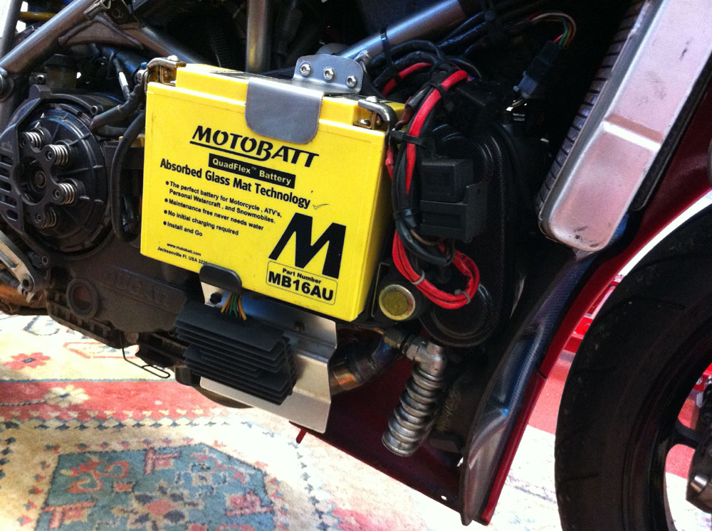

  8. I have a motobatt MB16AU fitted to my 748 never had a problem
