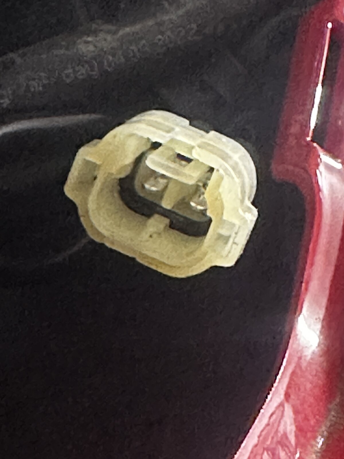

  1. Hi all, I'm hoping someone can help me? I am looking to power an phone or USB port on the bars and I have found an auxilary connector behind the front left fairing (see attached photo). Could anyone tell me what connector I need to fit into this, preferably with some pigtail wires so I can connect them directly to the wires from the extra port.
    Thanks in advance!
  2. on it there will some sort of code, i'd put that into amazon
    or buy a pair of connectors and cut the one you have off and replace it

  3. Worth knowing there are a number of spare connectors around the fairing.
    Satnav power, Keyless Fuel Cap, Fog lights, heated grips are all hanging around down there.
    I used the GPS connector - it will look like top one of the 2 shown below with the connectors sealed off.
    You can disconnect the sealed off connecters and use a connector like this one to provide power for your phone cable:
    https://www.ebay.co.uk/itm/165387321059?_trksid=p4375194.c101949.m162918
    I tried using that connector to power my phone - but the phone drew too much current and it would cut out. Worked fine for powering my Satnav though.
    (Photo below is from my old V2S - the satnav power connector looks the same)

  4. That's excellent info, thank you. I'm pretty sure I have some of those connectors in a box of goodies somewhere!
