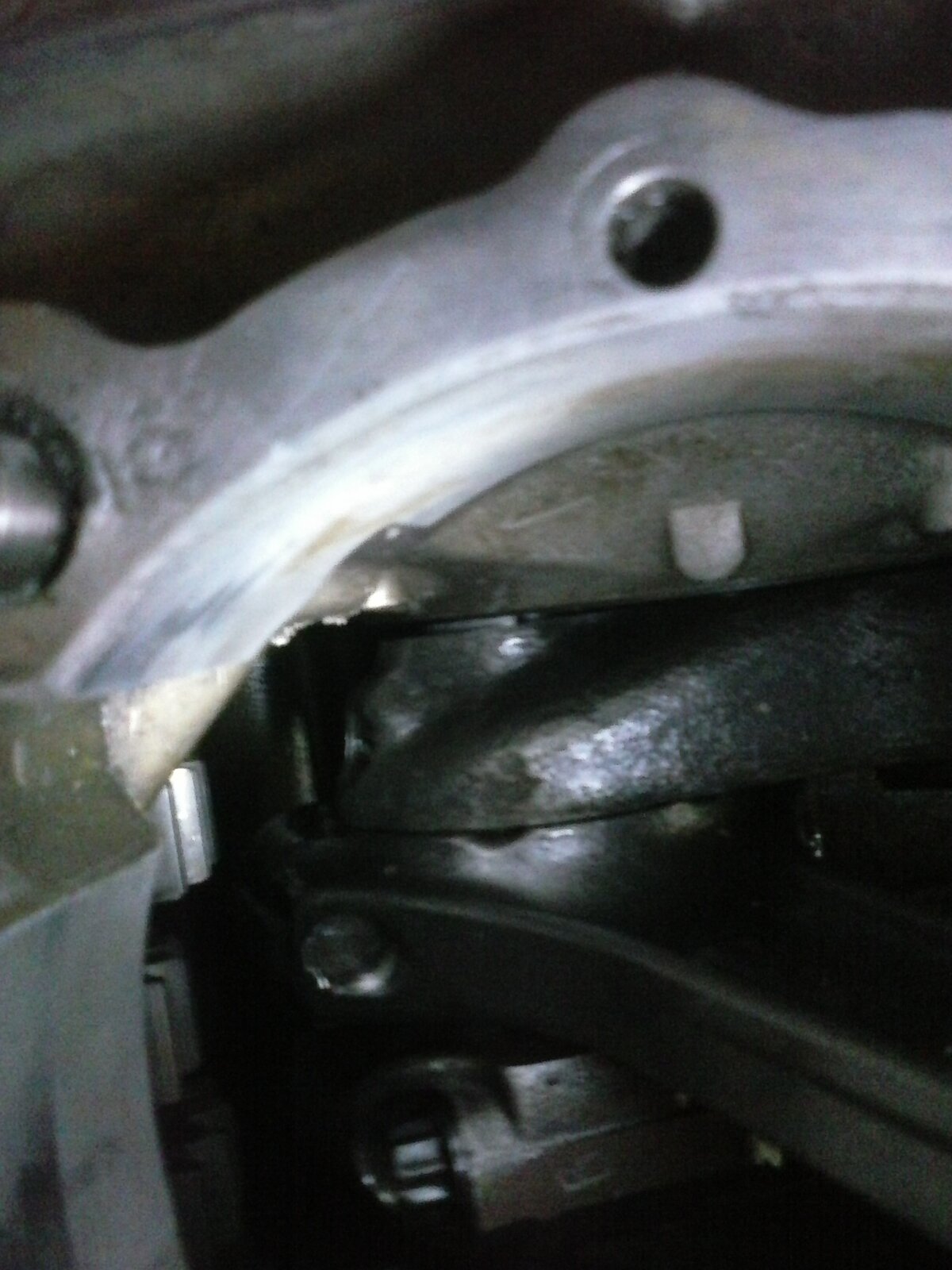

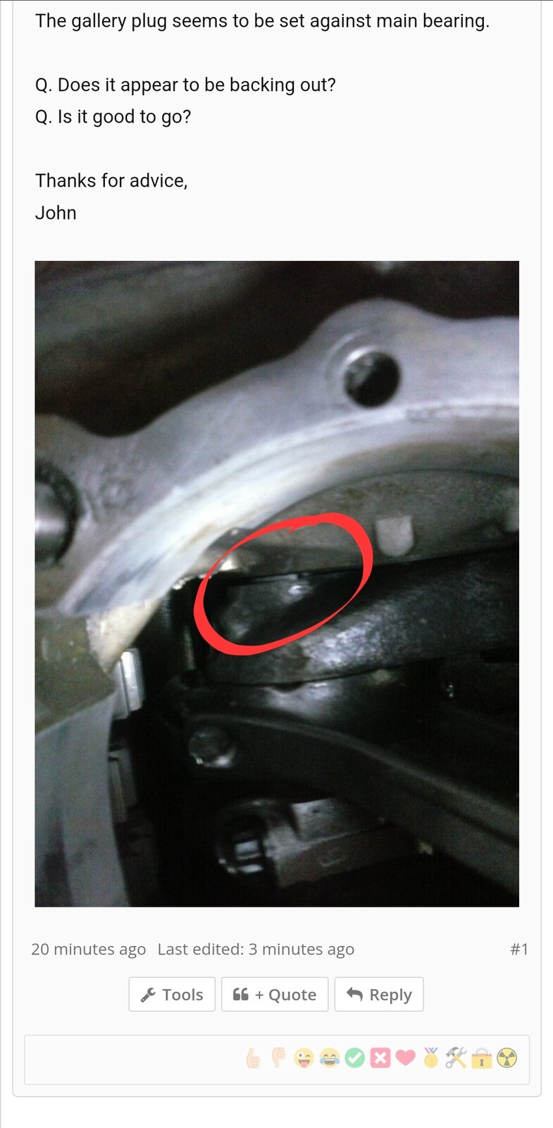

  1. Here's a picture of my LS gallery plug
    The crank turns freely without sound of scraping. The gallery plug seems to be set against main bearing.
    Q. Does it appear to be backing out?
    Q. Is it good to go?
    Thanks for advice,
    John

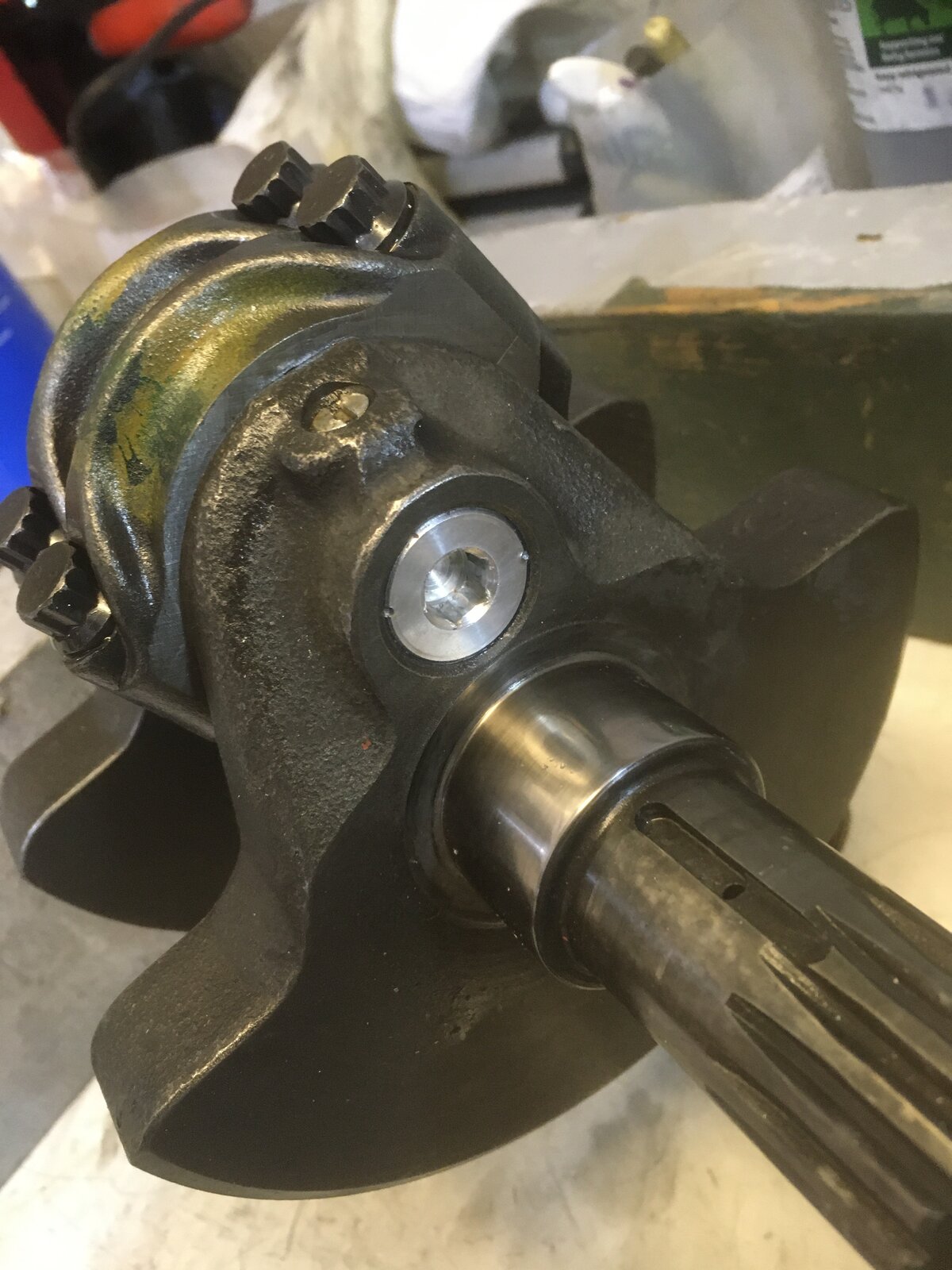

  2. Here's a gallery plug on a 748 crank. I would have said they are normally flush or slightly set in. 20220316_152346.jpg
  3. Mmmm.....yes, I would definately say it was backing out. It should be set further in the thread
    You can see it through the filter strainer hole at the bottom with use of a small mirror too for a different angle
  4. I'd suggest, that you have caught this just in time if it's making no noise

  6. It is definitely backing out. Lucky catch.

  13. Closer Observation, gallery plug: Although the slot on the plug is clearly visible, indicating only little degree of wear, the plug is at one point touching the bearing, its top plane surface being at a definite angle to the mains bearing, and I see a little swarf being raised at point of contact.
    Definitely time to address the issue. Grateful I was warned to check it in other posts, and sound advice here to see to it, and that it is in fact backing out.

  17. Hi, just done the some work on my 900ss engine, and your plug is definitely backing out.
    If you can get a small screwdriver or similar onto the edge of the plug it’ll probably be free to rotate, mine was finger tight.
