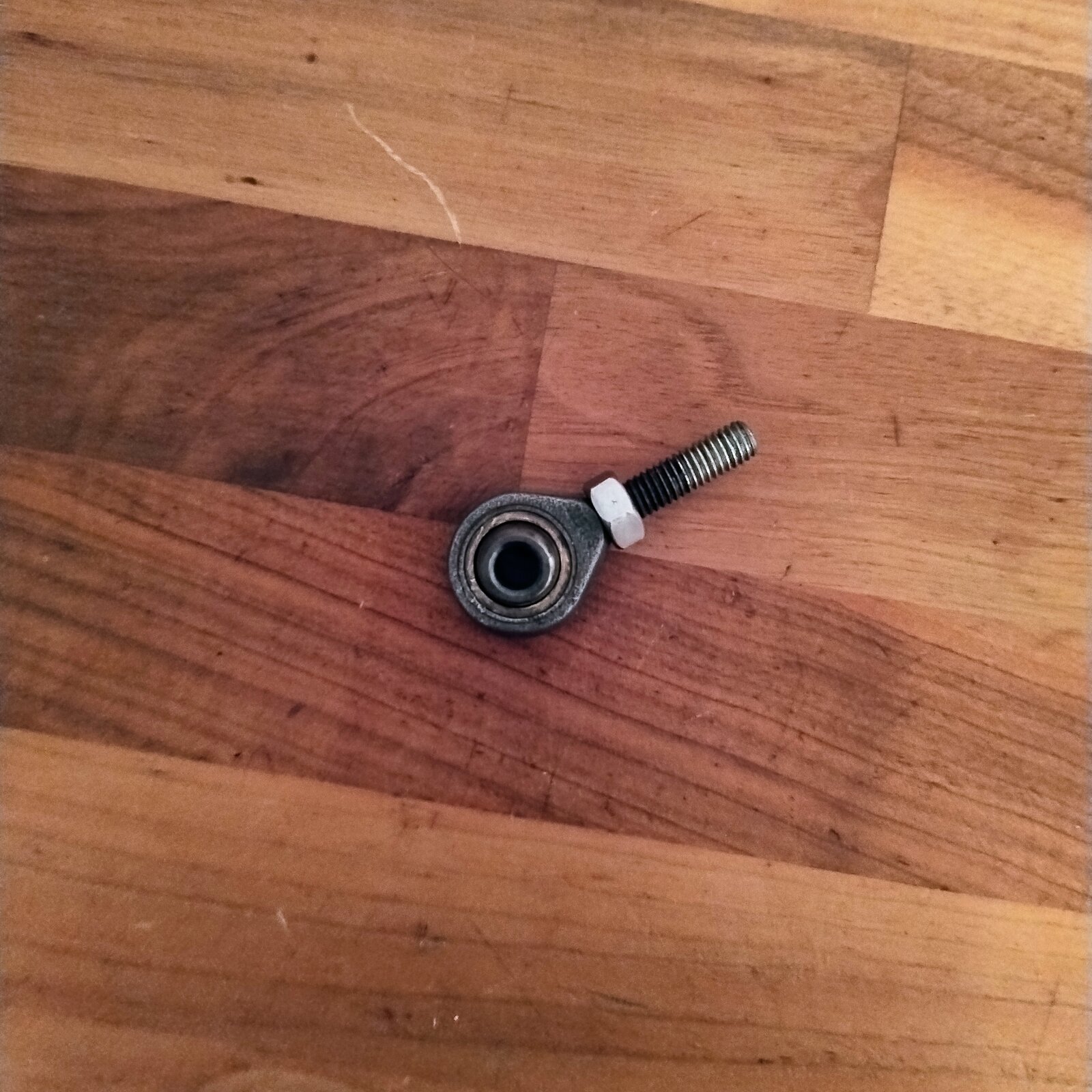

  1. Need a couple of new good quality ones for the rod that attaches my gear shift lever to the gearbox splined thingy to change gear
  2. Rose joint mate
  3. That is a rod end bearing. Also known as a spherical bearing.
  4. And can be right or left hand thread. Andy
  5. thanks muchly gents
  6. and that one is a male right hand thread M6 x1.0
    #6 andyb, Jan 21, 2024
  7. to tighten i turned it clockwise
    how can you tell the size from the photo?
  8. skill!! besides gear change rods are pretty much all that size.
    on the rod you'll find its a left hand thread one end and a right hand thread the other that way you can lengthen or shorten the rod overall length without removing them completely.

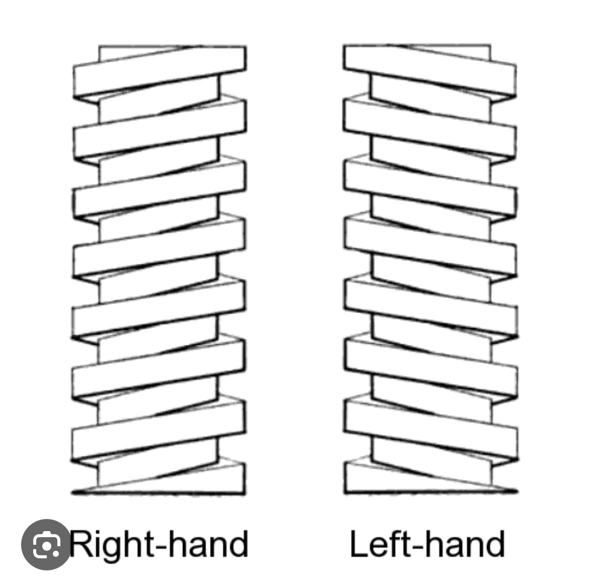

    • Disagree Disagree x 2
  14. I think Lightech do some fancy bling ones
  15. At the risk of making myself look stupid, I am going to say I don't think the picture in post 14 is correct. To me it's the other way round.
    Cheers Gaz
    • Agree Agree x 5
  16. It was just a pic I picked on the internet to show there are different angles to the threads
    It is the other way around…
