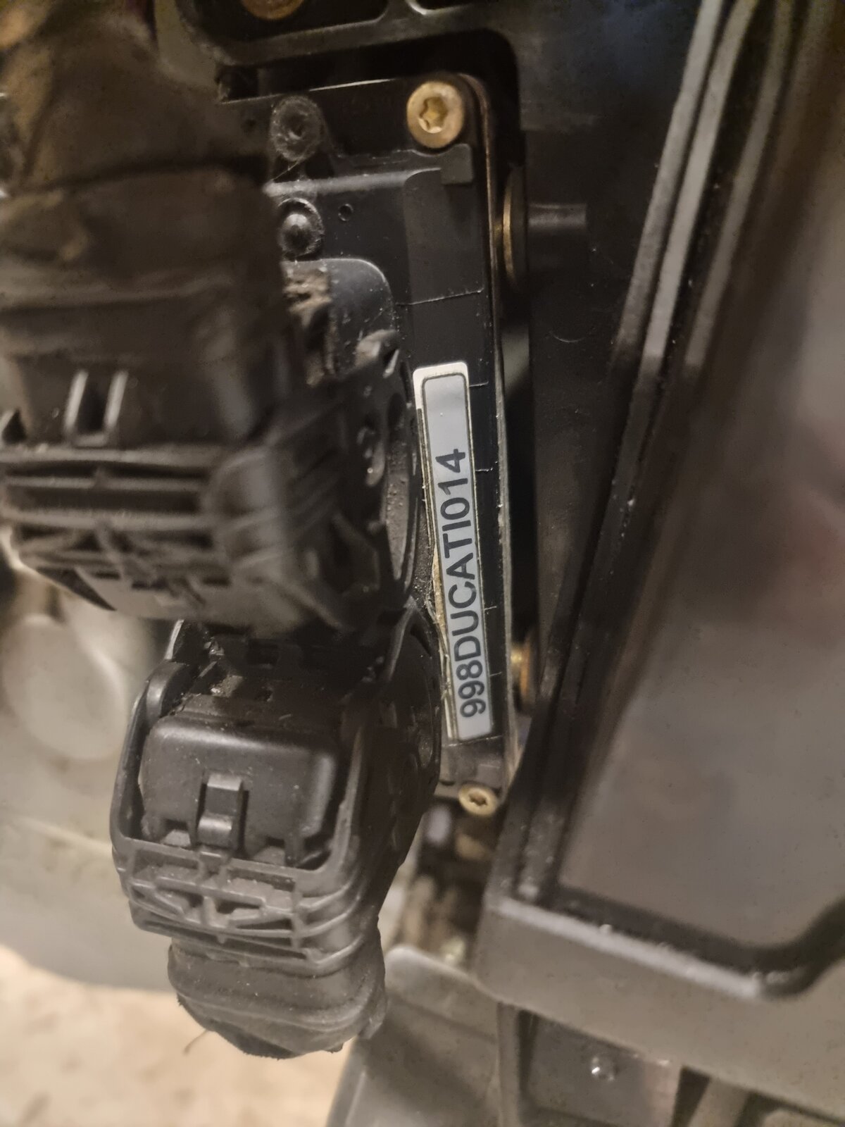

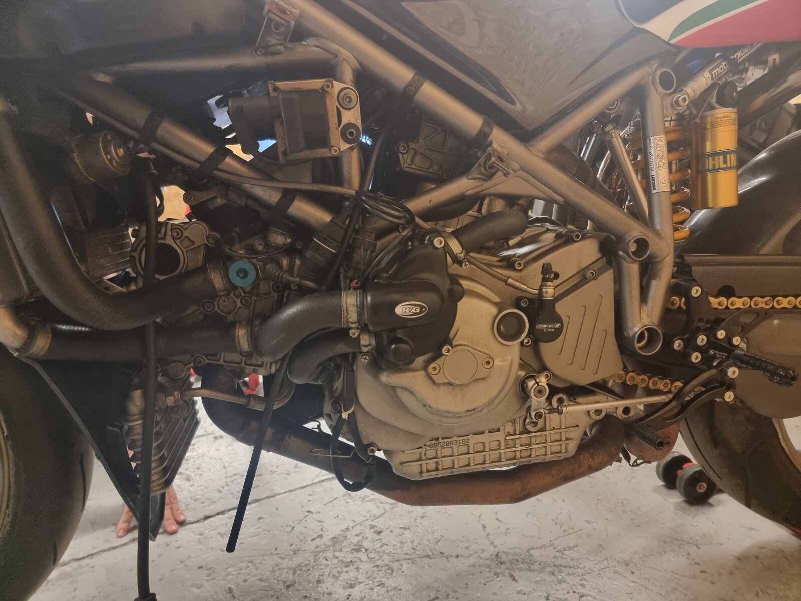

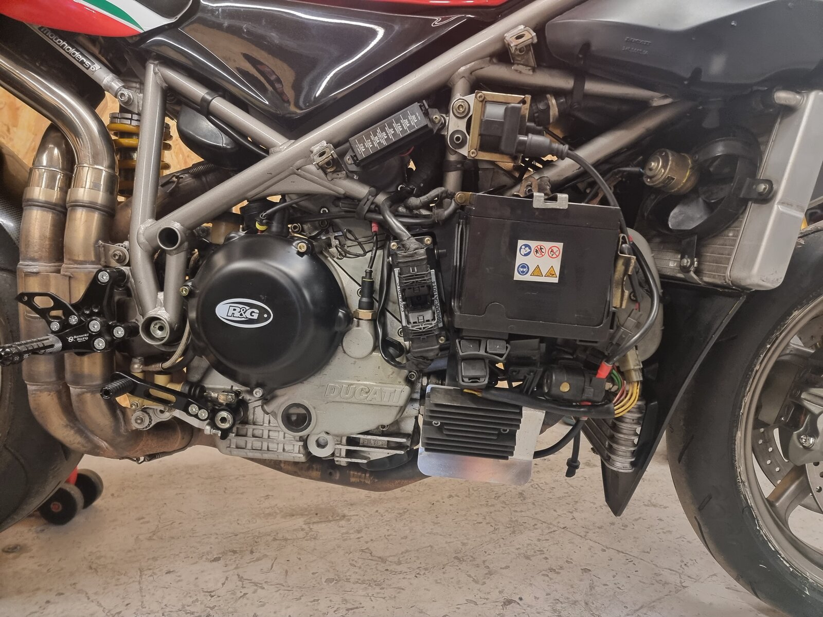

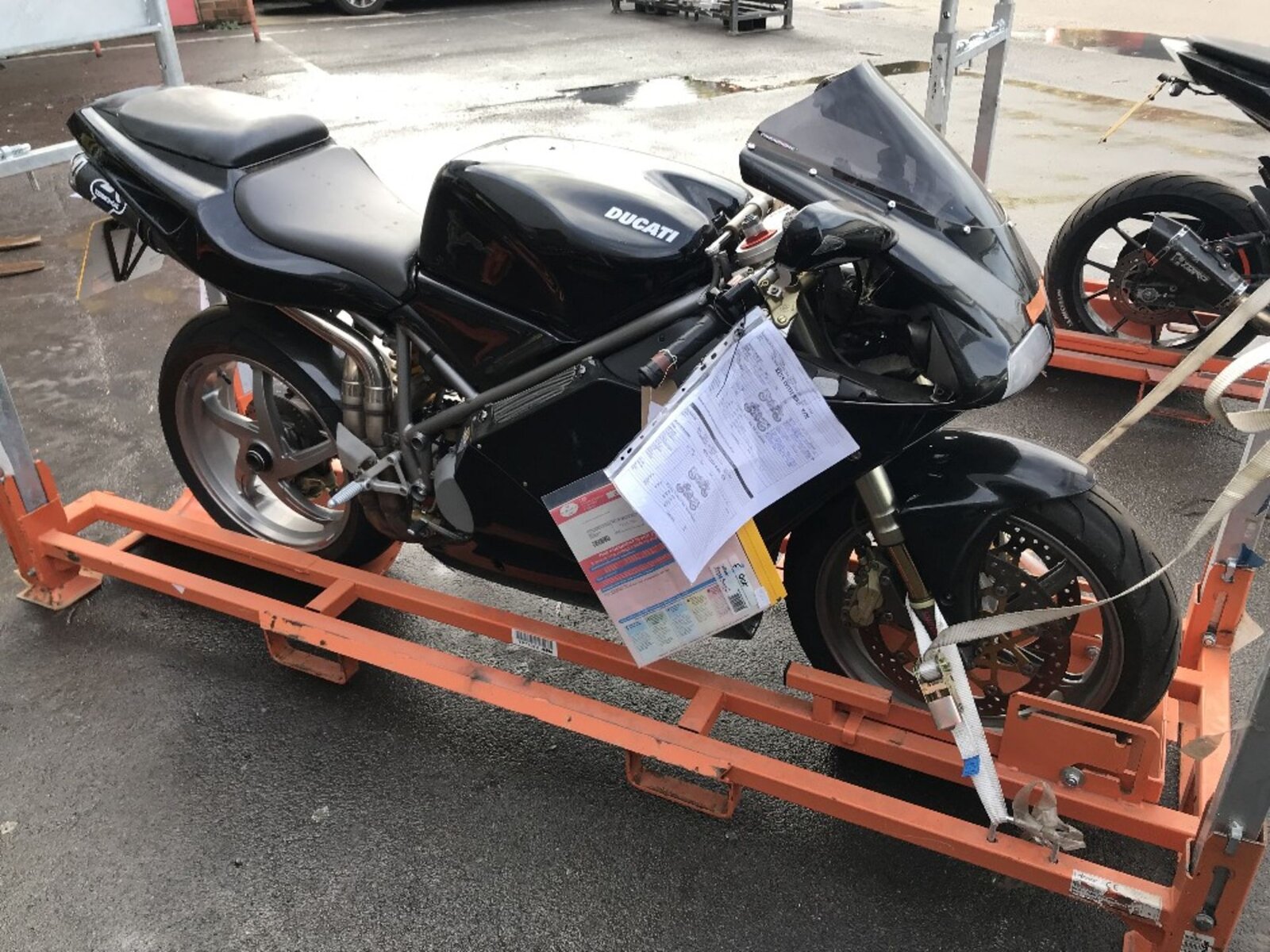

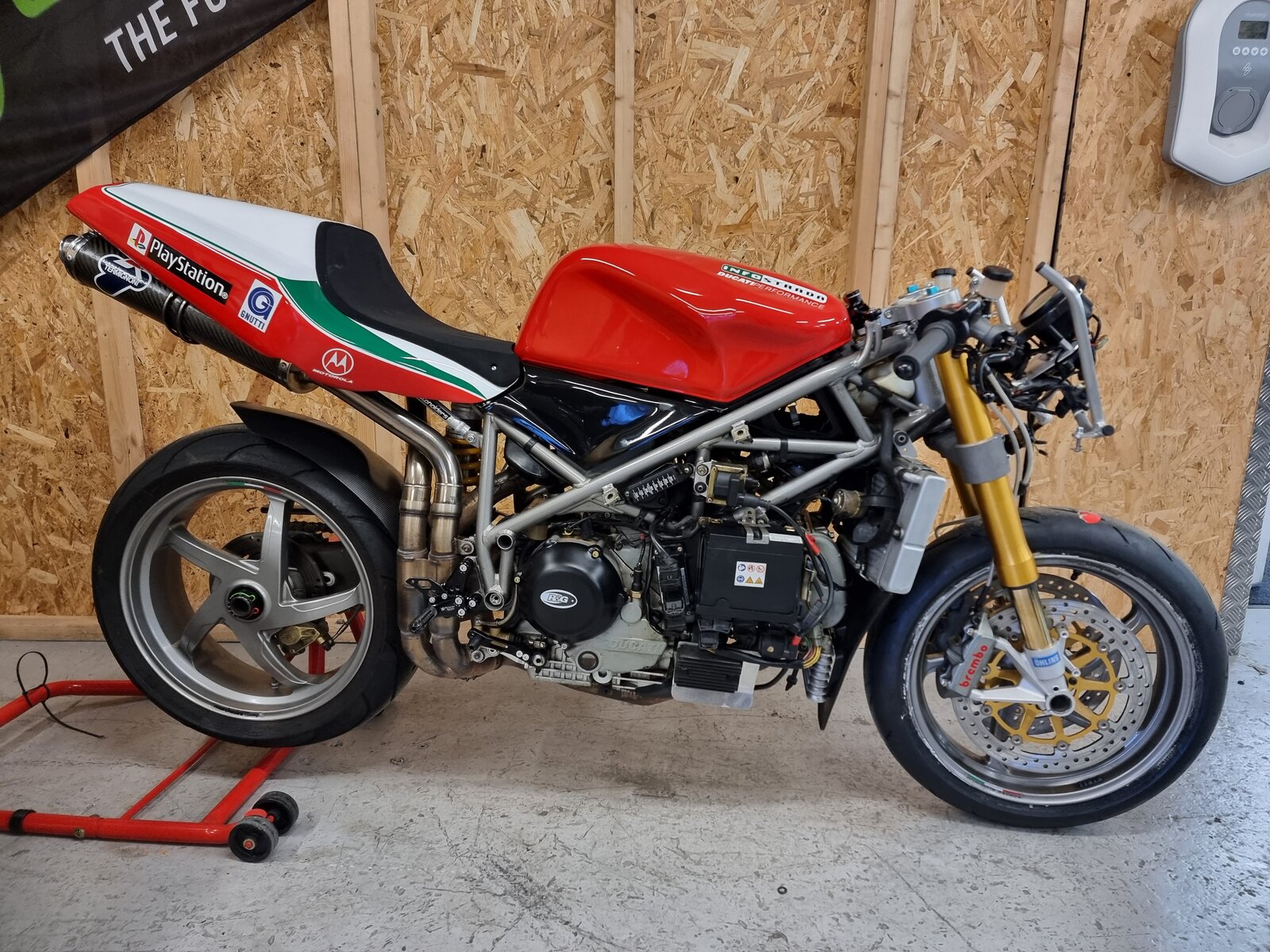

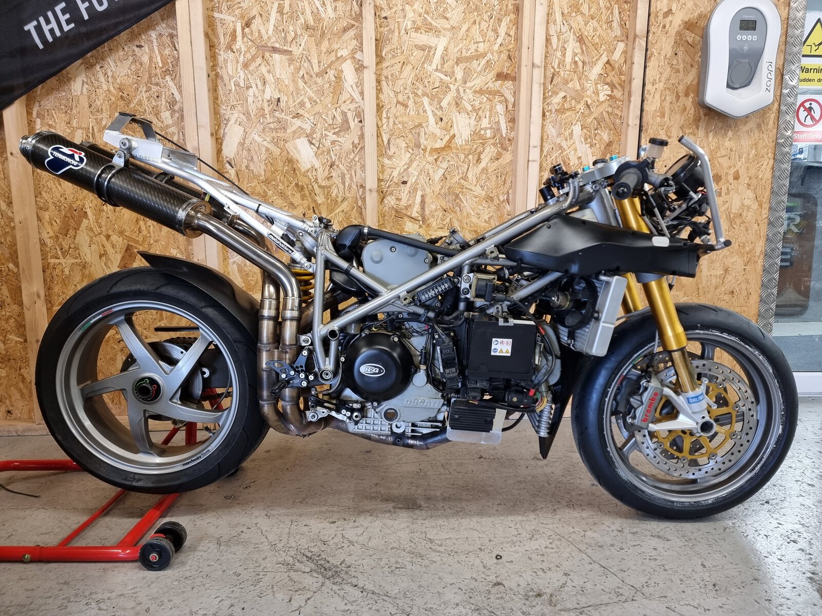

  1. So I've been building up a previously crash damaged 998 in to a track / show bike, based on a Troy Bayliss Replica. I have no history with the bike other than it looked like a standard bike, in black, that had had some "restoration" work done on it before it was dropped / damaged, as the clocks had been replaced with new ones and they showed 40 or so miles on them, but the bikes MOT history shows it was 40k miles previously. It also had a lot of the parts on it cleaned up and looking nice.
    Anyway, we put it on our dyno (I own a bike shop and we have our own dyno) which is usually quite pessimistic with its figures it gives, and the bike made 125hp and the rear wheel and 77 ft lbs of torque. That seems exceptionally high to me for a bike that had done 40k miles and considering the standard 998 model apparently only had 123hp at the crank, and 71.5 ft lbs of torque when brand new.
    I haven't been in to the engine to see if it is standard or not. Nor do I know for sure if it is the original engine. Is there an easy way to check what engine it is for example a standard model, S, or R ?
    Attached are photos of how the bike was when I bought it, what it looks like now, and some closeups of the engine from both sides and the ECU...
  2. Its a std 998 as it doesn't have the deep sump engine casings of the S. Id say the power was right probably increased with the pipes on it. if it was deep sump, better cams it would be in the region of 136..
