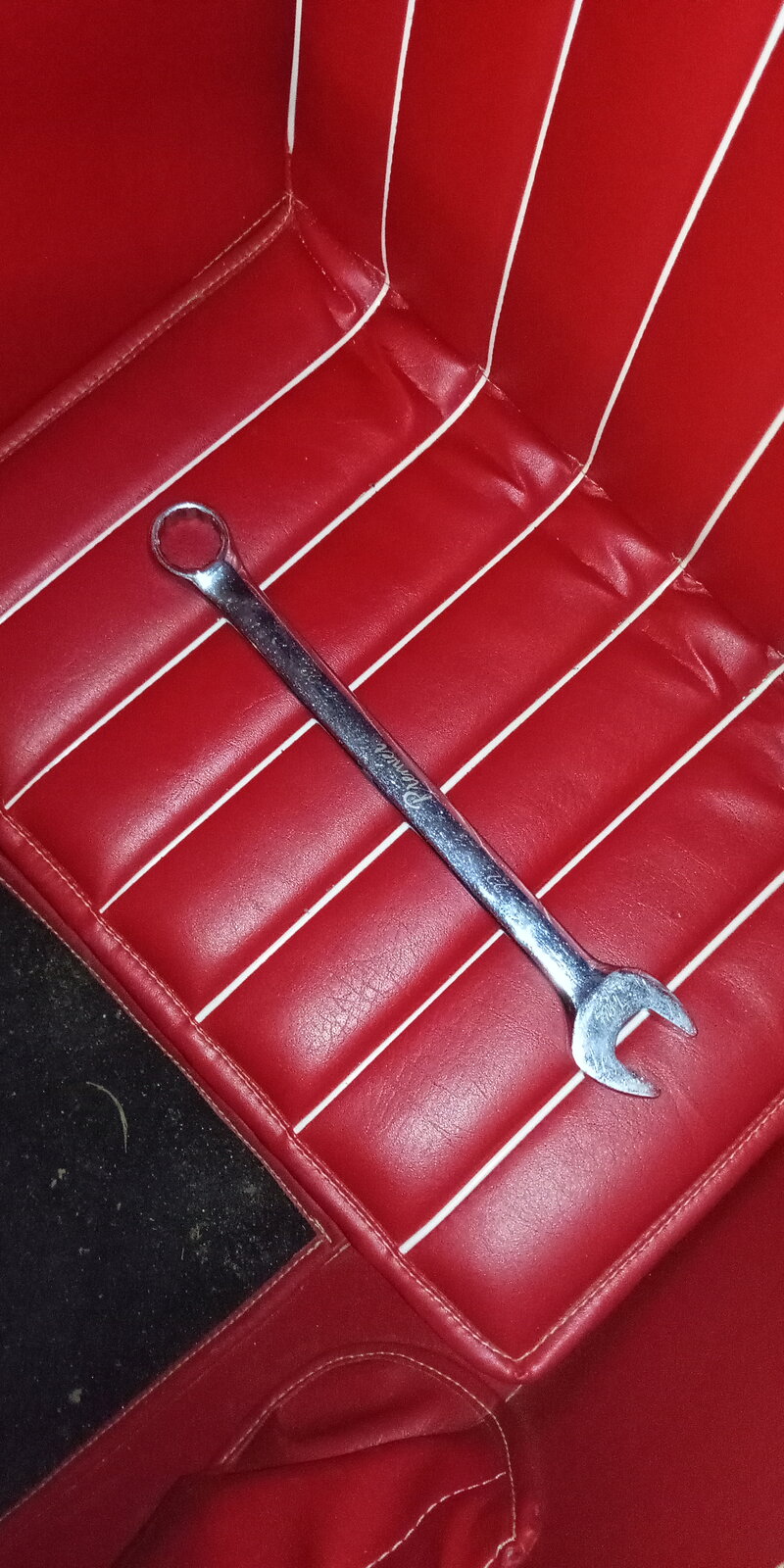

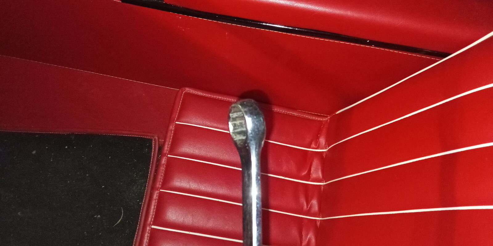

  2. I use a normal ring spanner with a 15 degrees angle. It's a 22mm on a 916.
