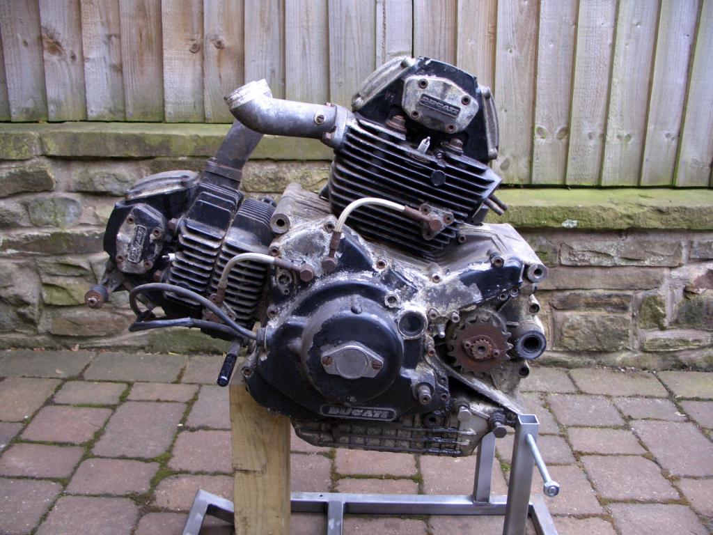

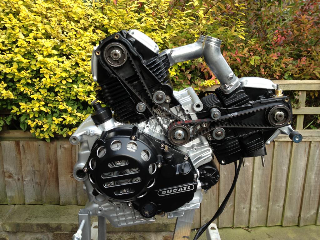

  3. If you've got the time go for it :wink:, it's not as hard as you think. I've done a few SS engines over the years and as Android says take loads of photos and bag everything up clearly labelling them and you should be ok. It really is a labour of love though, the more time you take with the prep' the better the finish you will get. As for the finishing, it all depends on how much you want to spend. I got my superlight engines barrels, heads and side casings shot blasted then powder coated, they came out really good and they were in a very poor state. I've also sprayed a couple of other 900ss engines with rattle cans and I'm happy with how it turned out too.
    Before and after...
  4. Good job mate. Look fantastic
