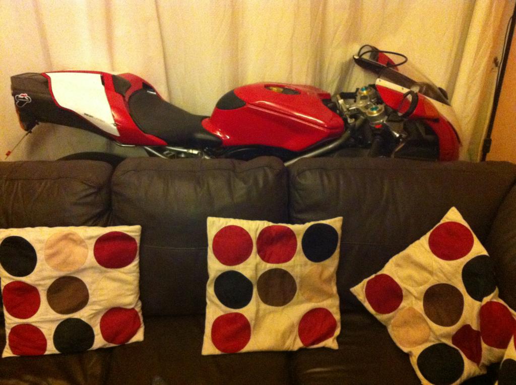

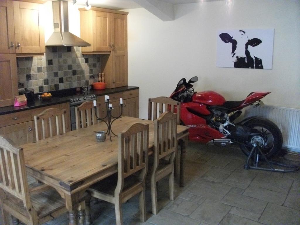

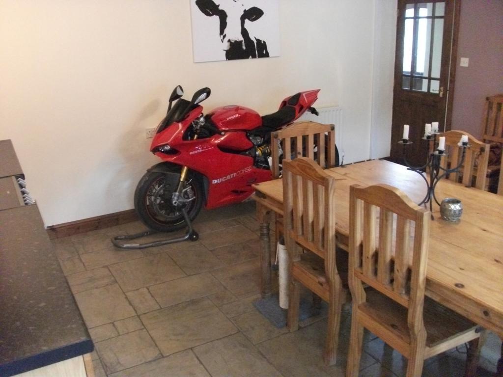

  10. I keep mine in the house nice and warm where I can just sit and look at it over winter (yes sad I know!). And when my other half asks me to do some cleaning and polishing guess where I start! :biggrin:

  12. Candlewicks need trimming! Oh, and can I have a doughnut?

  16. nice scratching post,but you could have at least had your bin in the pic.
  17. Surely it should not be relegated to the kitchen...
    Unless the living room is full ...
