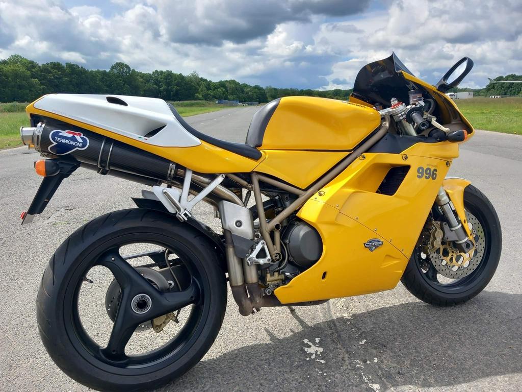

  1. Having just come back to the fold with a 996 my first task is to swap wheels to something other than the 3 spokes.
    848 wheels look like favorite but I am aware that, although the rear goes straight on in, the front is a bit awkward.
    I know the basic issues are disc mounting bolt pattern/qty is different and that the speedo drive needs help plus an offset issue (presumably the brake disc position).
    Has anyone got a definite installation guide on what I need to do to get the front to fit.
    I have no intention of changing fork legs and brake calipers but looking for a solution that adapts existing to mate with the 848 wheel. DUC1.jpg

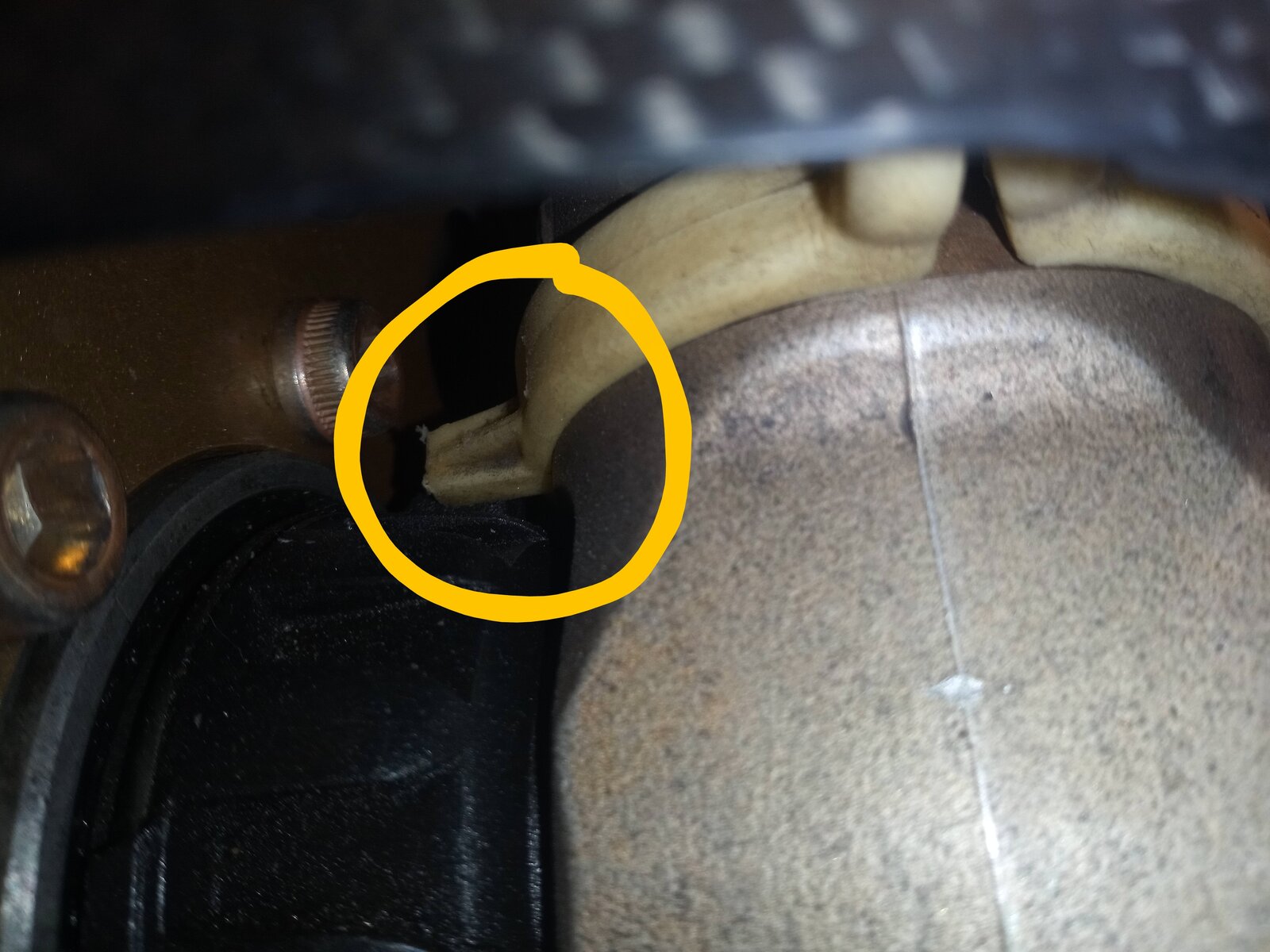

    However, as there is a lug on the speedo drive presumably this is captured to stop the drive from spinning - looking at my bike I can't obviously see if it locks into anything or not and, looking at images of fork legs, there's nothing visible on the leg that it mates to.

  12. The lug is on the plastic mudguard bracket. The Speedo drive itself isn't clamped at all but free floating. The cable only allows it to rotate so far but the definitive stop is on the mudguard bracket. The lower left bracket is different to the other 3. Picture attached. IMG_20240718_230941_154~2.jpg
  13. As above, there is a locating lug in the plastic mudguard clamping bracket but it only acts as a guide and the speedo drive will stay in place perfectly well without it. I had some PVM fork bottoms that had no such lug as the mudguard brackets were cast into them and they fitted fine with the speedo drive etc. - until one broke, but that's another story.
    As such the 848 wheel will fit with the correct spacers etc. but you won't get the speedo drive in because the bearing sits in the end of the hub rather than being recessed into it so the speedo drive assembly won't fit into the wheel and there's no way you'll get round that.
  14. Pretty sure that the speedo unit is clamped up when the spindle is torqued up and doesn't float.
    That's how it was on my 748 and 916.
  15. Isn't it the inside sleeve is clamped up but the plastic exterior can still rotate? Been a while since I was in there.
