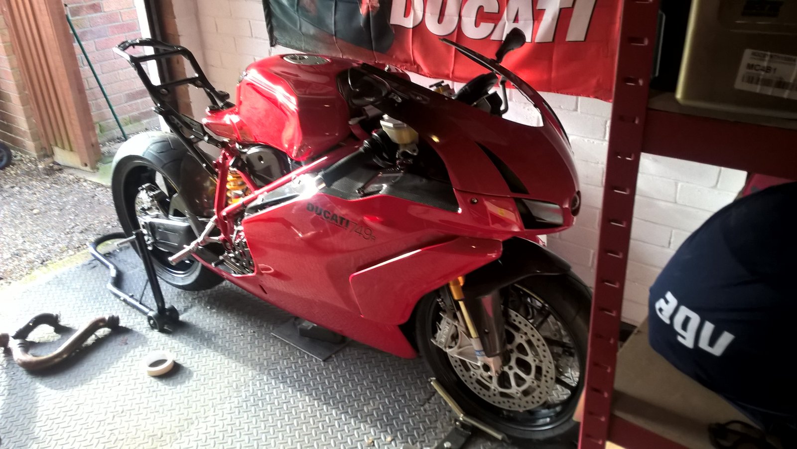

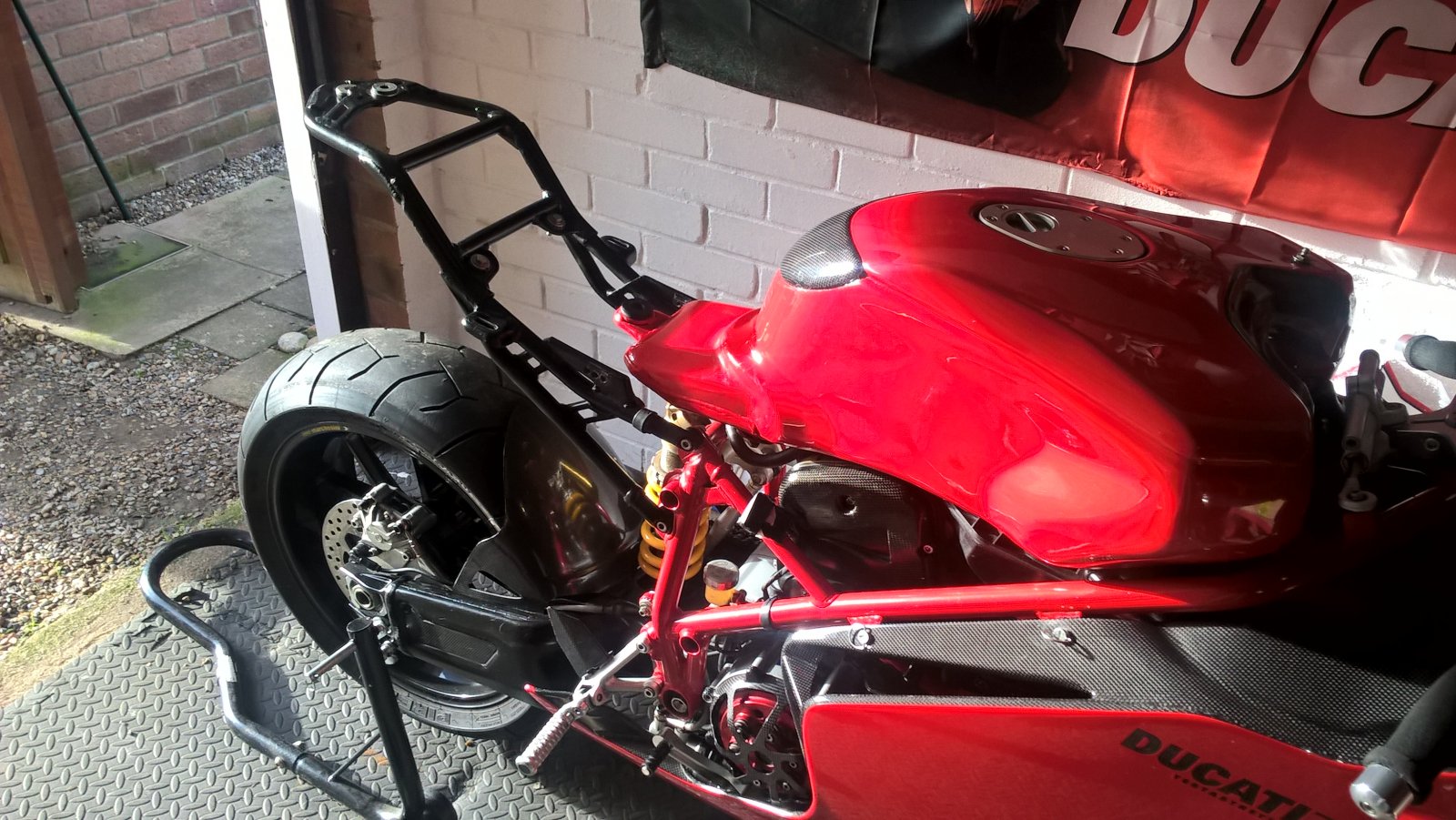

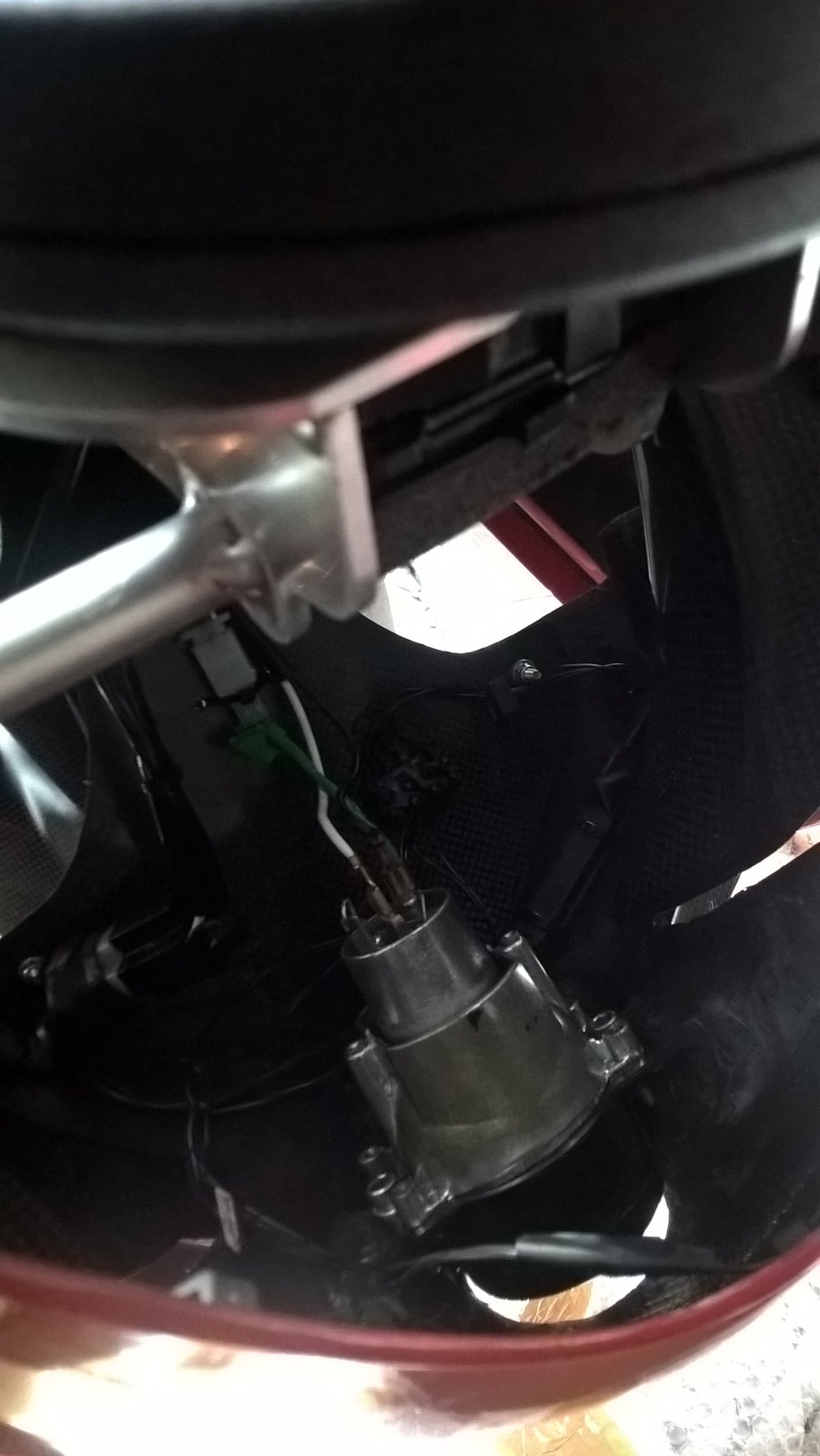

I have taken the exhaust system off to get it Cermakrome coated at Camcoat and have re-wired the front loom so everything can be disconnected by just two connectors. Also some new Brembo discs going on.Just be interested to see what everyone else is upto, so I can steal any good ideas!

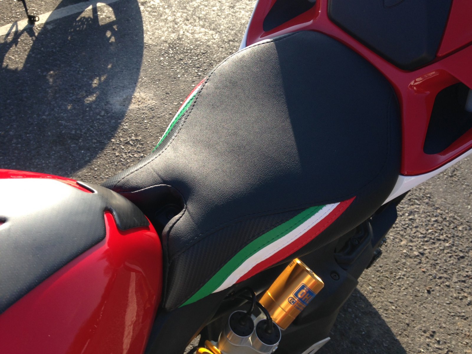

I plan to do something about the scabby front cylinder head paint and maybe get one of those alcantara seat covers from Germany and get it fitted by a local upholsterer. Also new oil and filter.

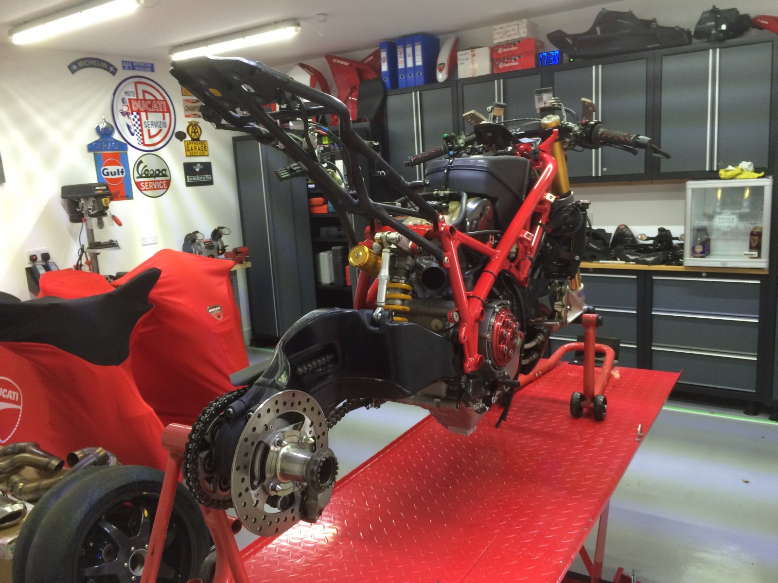

Mine is off to Lougimoto in January, new black box swingarm being fitted and I'll get him to put on the new Oberon clutch master slave cylinder while he's on. Just a quick shifter next ?
Just the usual yearly service stuff for me, with the addition of a clutch/brake fluid change and a check and clean up of all the connectors behind the battery box. My seat has a neoprene/foam like cover. It`s a little bit tatty in places so I tried an alcantara seat cover. It looked nice but I found it went very slippery after a couple of months so took it off. I might try some of this instead: ADHESIVE BACKED BLACK NEOPRENE SPONGE/FOAM RUBBER SHEET 2mm - 12mm THICK | eBay
I have the foam Ducati Performance seat on the Streetfighter. It's great with jeans, but I slide all over when wearing my leather chaps ! The Superpole seat on the 1098 is fantastic whatever I wear. You plant you backside on a given spot and just stick there.

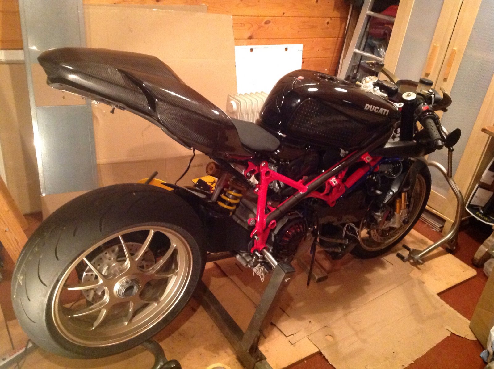

Job list: Get exhausts polished Remove forks and shock and send to JHP for resprung and service Fit carbon seat unit and modify to attach with Dzus and a couple of screws Fit indicators and rewire to make them easy remove able with the number plate hanger (similar to your rewire) Fit crash bungs Fit lightweight fairing mount Grease slipper Re-do home made projector light brackets to make them a bit tidier Get Ecu remapped by CJS
I believe I owe you one for the 'clutch advice'. So here's my two penny worth. I've had two seats covered recently and would advise against putting a cover over the existing cover. Two layers makes it too hard. Most likely the existing cover is welded to the foam. That in itself makes it firm. You need an upholsterer to peel it off, put on a thin extra layer of memory foam then put your new cover on. Alcantara, I'm not convinced is a good idea. What exact bike? I may have a suggestion.
