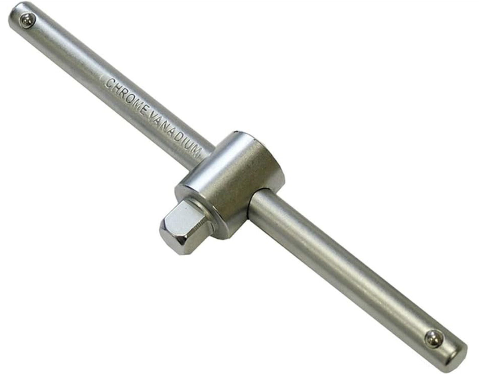

  5. I’m sure it is a strong as a ratchet but we were always taught not to use ratchet’s for high torque applications. At home I have a large breaker bar, but for touring I will take a t bar with a close fitting tune to slide over it, unless I can find something better.

  7. Torque wrenches are for final tightening, not undoing torqued up fixings, that's what breaker bars are for. Snapon tools are beyond many people’s budget. I will be using a simple t bar, almost indestructible.
