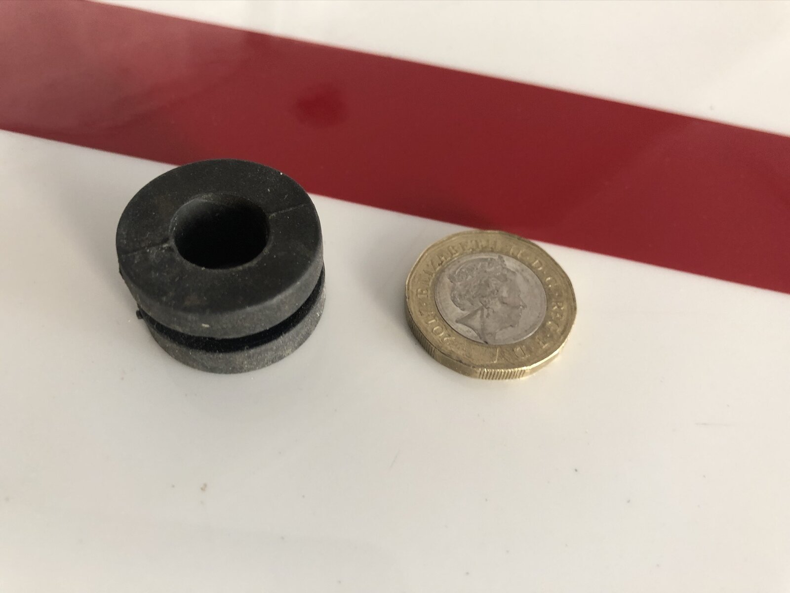

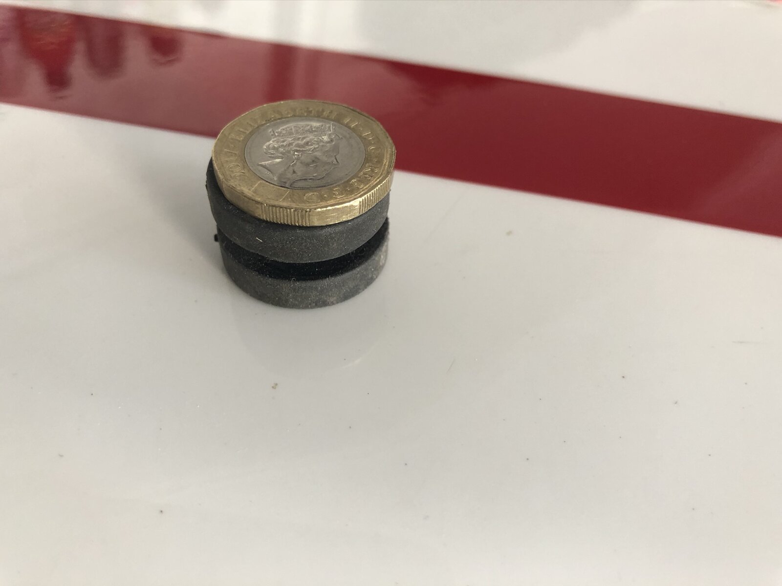

  1. just reassembling my 916 SPS and can not remember where this is from, can you help?
    The rubber grommet, not the coin!

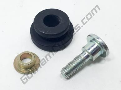

  13. Agree with above but could also be fuse box rubbers or damper in battery tray. Depends what you may have disturbed for access. I think a lot of these could well be the same part. Can't imagine them falling out though.
    #14 Ian 748, Apr 20, 2020
  14. I agree with Ian, may be 76410841A (used to be 079772068) and according to the fiches is used in a number of locations on the 748/916 as well as some places in STs, 749/999, 888, 907. Listed as a vibration damper for the headlight (2) , for the battery box(2), for the coils(4)

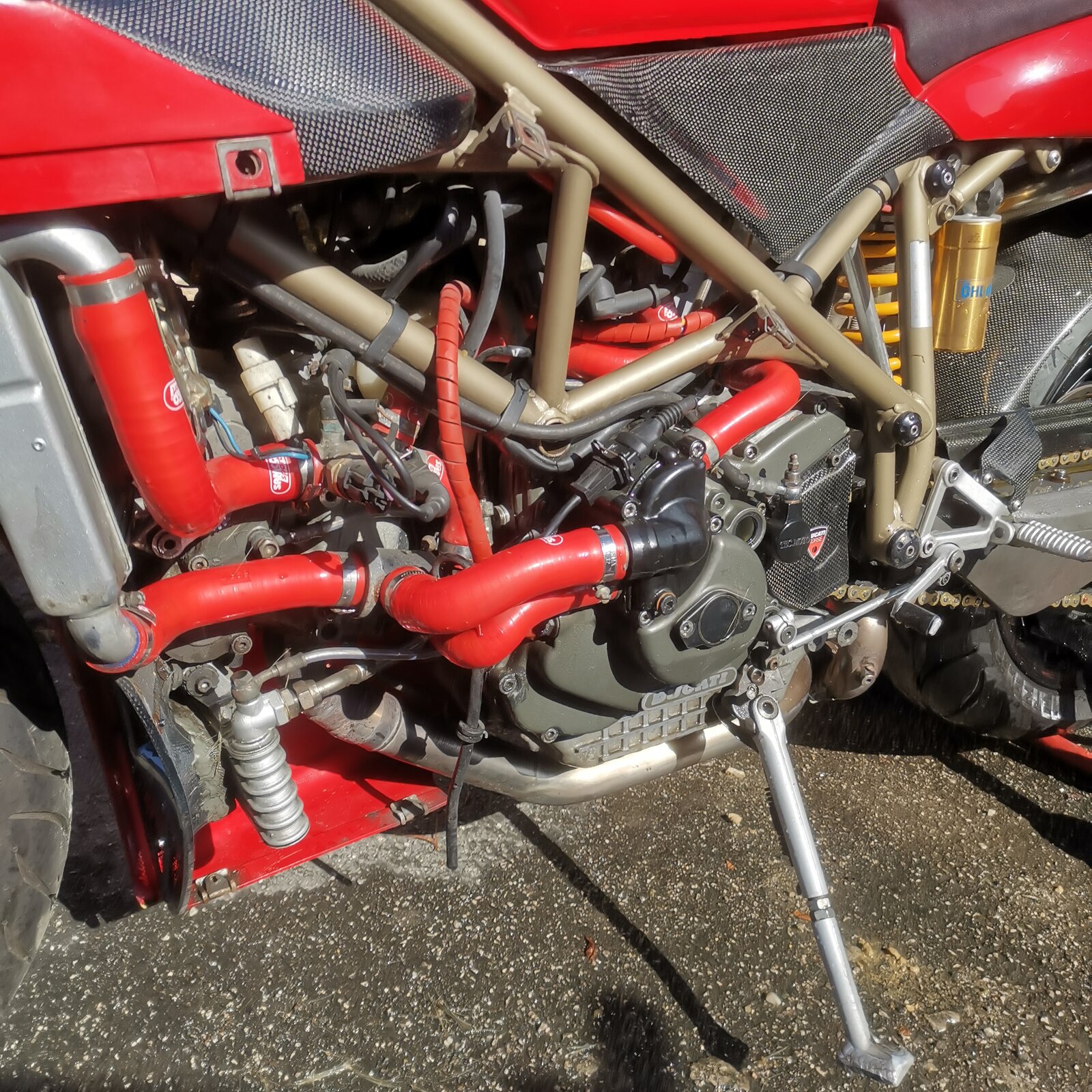

  15. I agree with the fuel vent/drain pipe grommet. Pic above, where the pipe comes down near to the oil cooler.

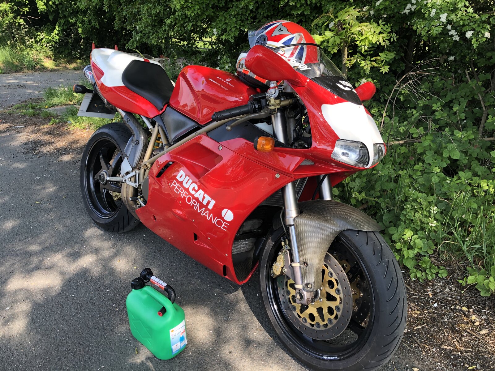

  19. DB87007E-7012-4762-8413-C324041D0E52.jpeg Checked all the suggestions and can’t find anything missing. So it’s on a shelf for later. Thank you all for your help. On a more positive note, it’s just had its first ever MOT.
    After a brief impromptu stop for fuel.
