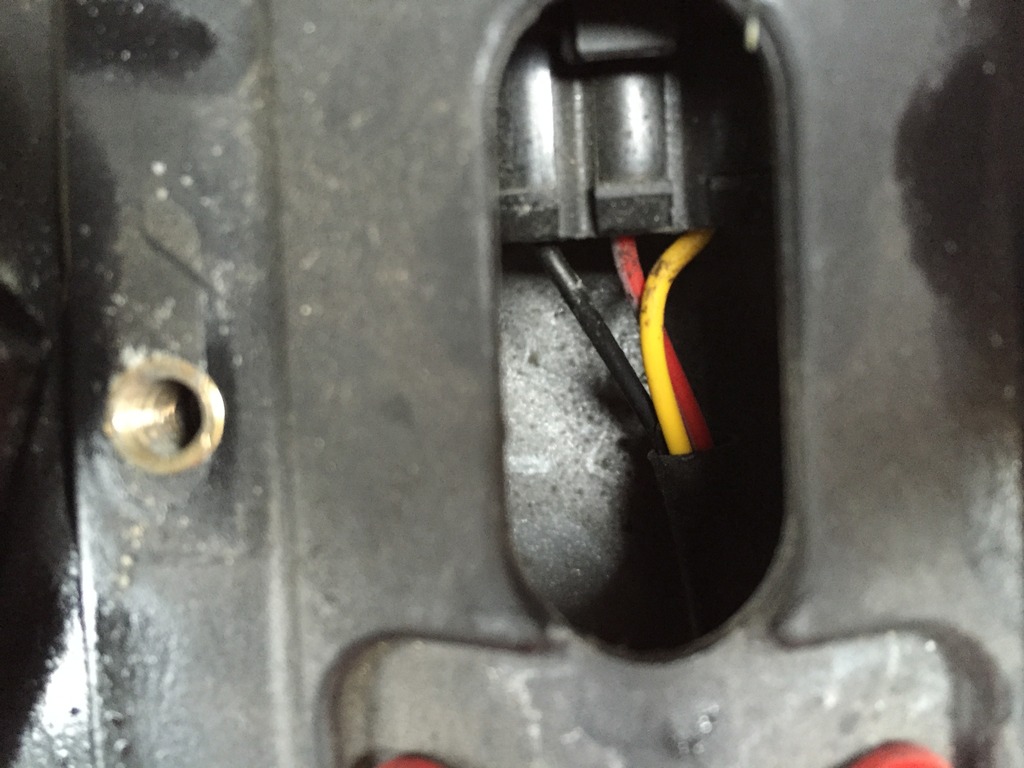

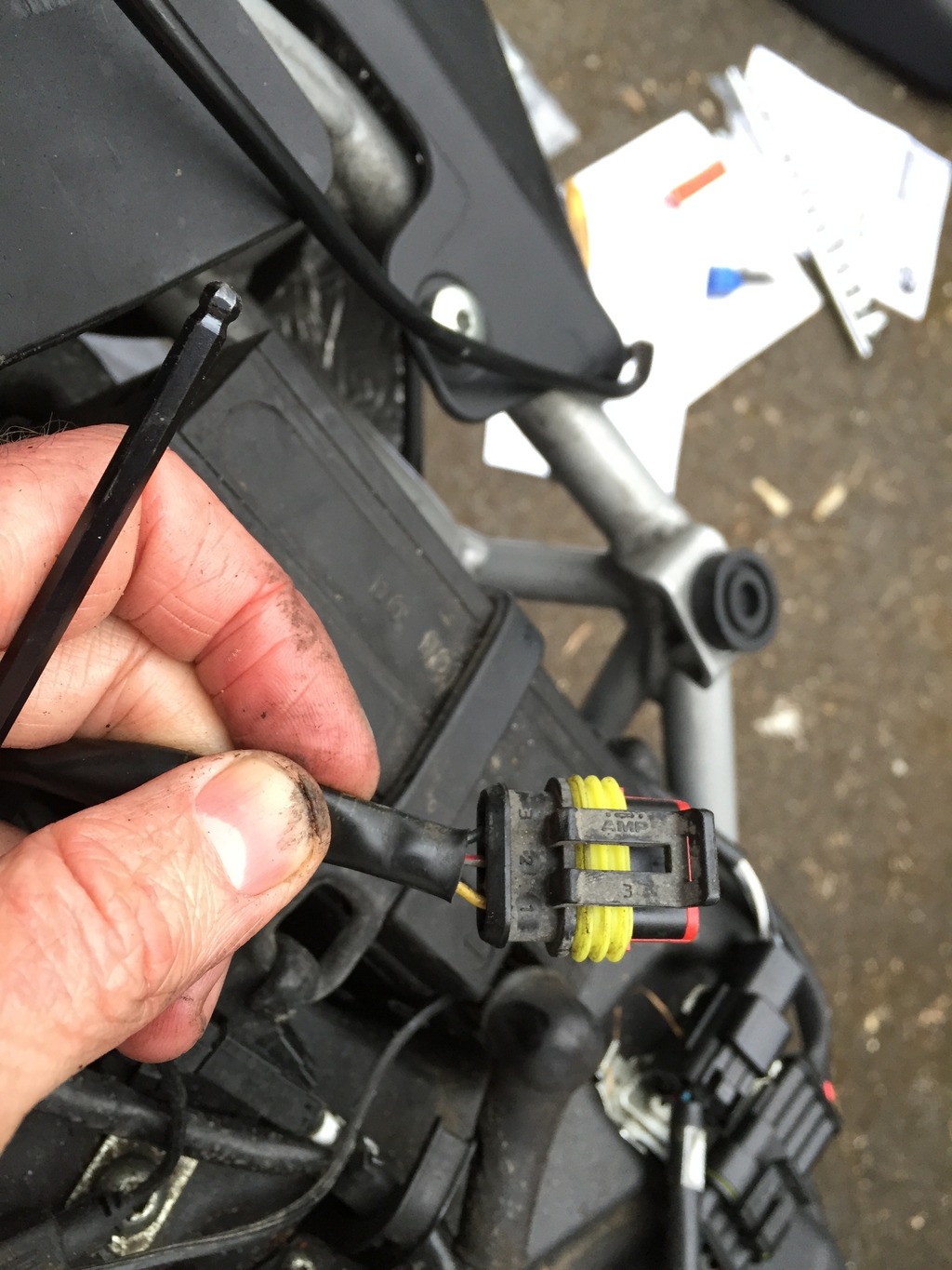

  3. Great many thanks ChrisW!
    In case anyone else reads this and also wants to know.
    Bk is Negative (3) (surprise surprise)
    Gr/R (2) is the switch I think...
    Y is Positive (1)
    Here is another view with the numbers
  4. Slight update in case it served anyone else doing this.
    So you connect the negative TopBox break light to the Black and then Positive to the Gr/R as that is the switch.
    I stupidly connected to the negative to the negative and the positive to the positive, which of course, would make the TopBox lights on permanently.
