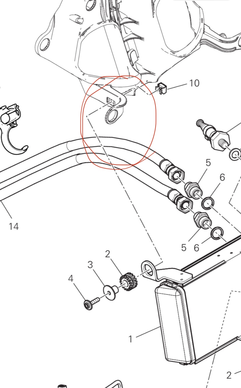

  2. Think you’ll find it’s either the oil cooler rubber mount or off one of the front nose mounts. They’re a pain in the arse to relocate and can sometimes drop over the course of time, if not located correctly.
  3. Tank locator bung. Could have previously not been correctly located.? Google a schematic Ducati parts list.
  4. I checked the parts list but I am still clueless as to what a tank locator bung is?? Sounds useful in warfare though….
  5. Front nose mounts first oil cooler. Easiest to see. These vibration dampers are used in several locations.
  6. So far I have checked the headlight mounts, oil cooler mounts, coolant radiator mounts.
    maybe it is a damper which went missing and was replaced in a previous service

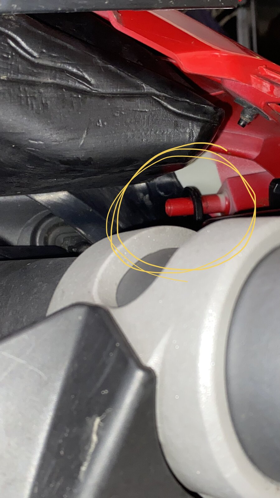

  7. Found it!
  9. That’s the beauty! Well done.
