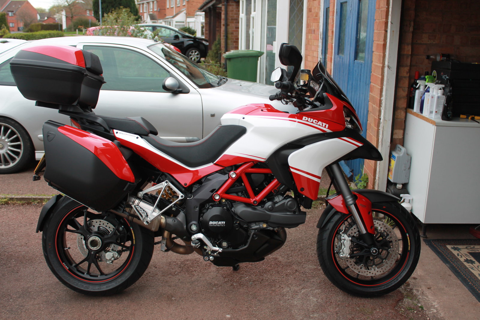

last model twin spark before DVT. Best skyhook plus most fun engine thats still smooth. Plus last edition means bugs ironed out

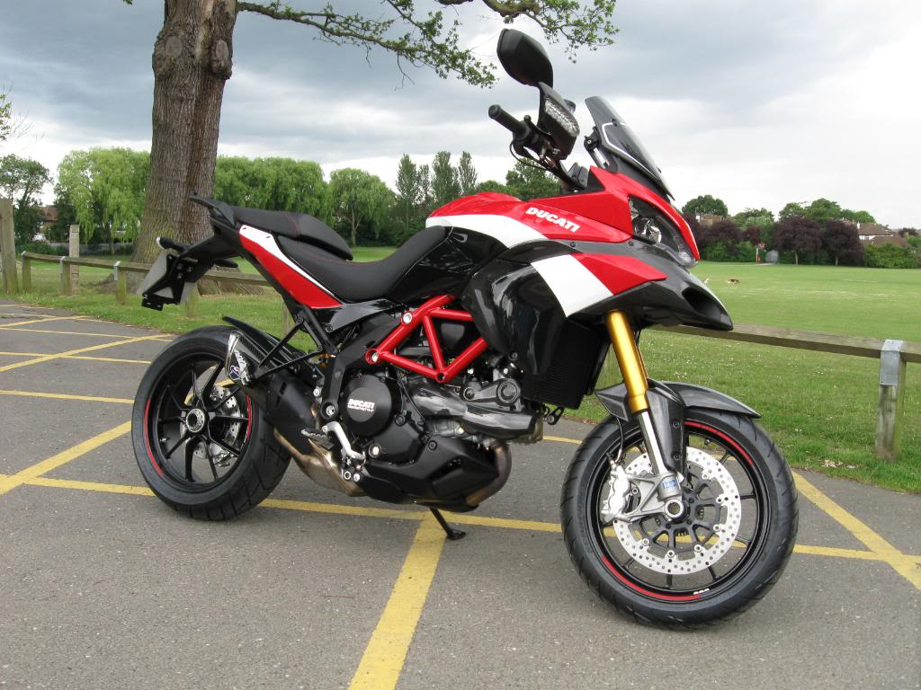

Agree, but the Pikes Peak version, with the red frame and lightweight wheels the last of the proper pp version's, the one above is lovely tho.

Best of all 1200 is the 1200S dvt 2015 onward fitted with the Termigoni exhaust decat with upmap chip. Can be dealer fitted. turned a very nice bike into a tiger in sheeps clothing . Skyhook suspension which is fully adjustable with some fiddling on settings. No lurching & very tractable. 6th gear at 60 mph & pulls like a train. Can chuck a tank slapper on full boar unless you hold the bars tightly. Some may disagree with my statement but i hold fast. Oh & change the tyres as the scorpian 2s are ok but for hard riding you need sports tyres.
